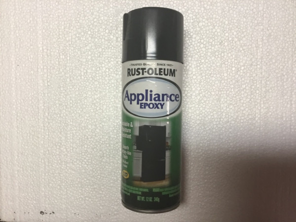

I use Rustoleum satin black for engines and other chassis parts. It's very tough and long-lasting. I tried glossy on an engine and it looked horrible. For glossy stuff like wheels and body parts I've used appliance epoxy enamel. It has lasted very well too.

I agree with Steve Jelf on the appliance epoxy enamel paint.

The appliance epoxy enamel is very tough. Just pay close attention to drying and recoat times. If not you will get a nice wrinkle finish

Believe it or not, this 1926 front fender was painted with Rustoleum Appliance Epoxy. It is a beautiful true black, goes on great, levels out great and once it fully dries can be compounded to attain a mirror finish. These four photos were taken immediately after painting, before it was compounded. After several years, if it oxidizes, it can be compounded and be made to look like new again with a mirror like shine. Since I discovered this for myself, I use nothing else. Jim Patrick.

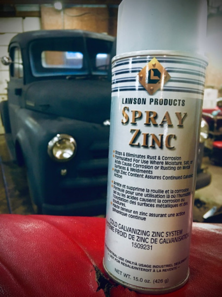

Has anyone used the cold galvanizing zinc 'paint' on rims? And if so how does it hold up? And fwiw, this is hardly off topic. Thanks, jb

James, Yep I have used the Rustoleum brand cold galvanizing spray on a set of 21" rims. It worked great, dries very flat, but has a good look of bare galvanizing although without the "pattern" that sometime galvanizing has. I did it on a car that belongs to the local historical farm and so far it has held up very well, I think for about 4-5 years.

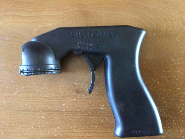

I might add that a trigger handle for a paint can is a good tool to have. It snaps on and makes it more like a paint gun.

Where are the spray can handles sold. I don't remember seeing them in the paint sections in the stores I visit.

Mine is a Rustoleum brand. I think I had to ask the sales guy where it was. Do IT Best hardware store.
I found for some other brand spray cans I had to sand the top of the push button flat to work better.

If that trigger attachment is like the only kind I've seen and had, it doesn't work on a lot of these new "modern" cans spray buttons. Just the good old fashioned little round kind. Maybe they've now got something new, but I've yet to see one.

I used cold galvanizing spray paint on a gas tank and the paint turned to powder that you could wipe off with your hands.
William L Vanderburg
1922 Center Door Sedan
Posts: 8663
Re: OT - Better quality rattle can paint?
Post by TXGOAT2 » Tue Jan 11, 2022 7:17 pm
Doesn't sound good, but it may be supposed to do that if it's intended to be an undercoat.
Tim,the trigger works on all Rustoleum paint that I have including the newer 2X. As mentioned the button of other brands sometimes needs to be sanded
or modified so the trigger pushes straight.For some it might not work.
Update,looks like new Rustoleum trigger is different, so my experience is only With the black one.
