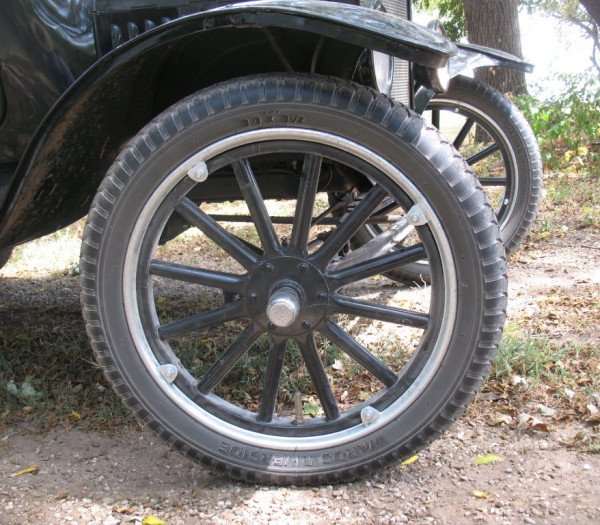

I used appliance epoxy enamel on the disk wheels on my 1925 cutdown. Time will tell how they hold up.

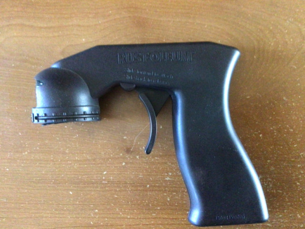

I might add that a trigger handle for a paint can is a good tool to have. It snaps on and makes it more like a paint gun.

Re: OT - Better quality rattle can paint?
Mine is a Rustoleum brand. I think I had to ask the sales guy where it was. Do IT Best hardware store.
I found for some other brand spray cans I had to sand the top of the push button flat to work better.

- Posts: 3743
- Last Name: Wrenn
If that trigger attachment is like the only kind I've seen and had, it doesn't work on a lot of these new "modern" cans spray buttons. Just the good old fashioned little round kind. Maybe they've now got something new, but I've yet to see one.
Tim,the trigger works on all Rustoleum paint that I have including the newer 2X. As mentioned the button of other brands sometimes needs to be sanded
or modified so the trigger pushes straight.For some it might not work.
Update,looks like new Rustoleum trigger is different, so my experience is only With the black one.
Okay. Thanks for the update! Lord knows where my trigger is!!
