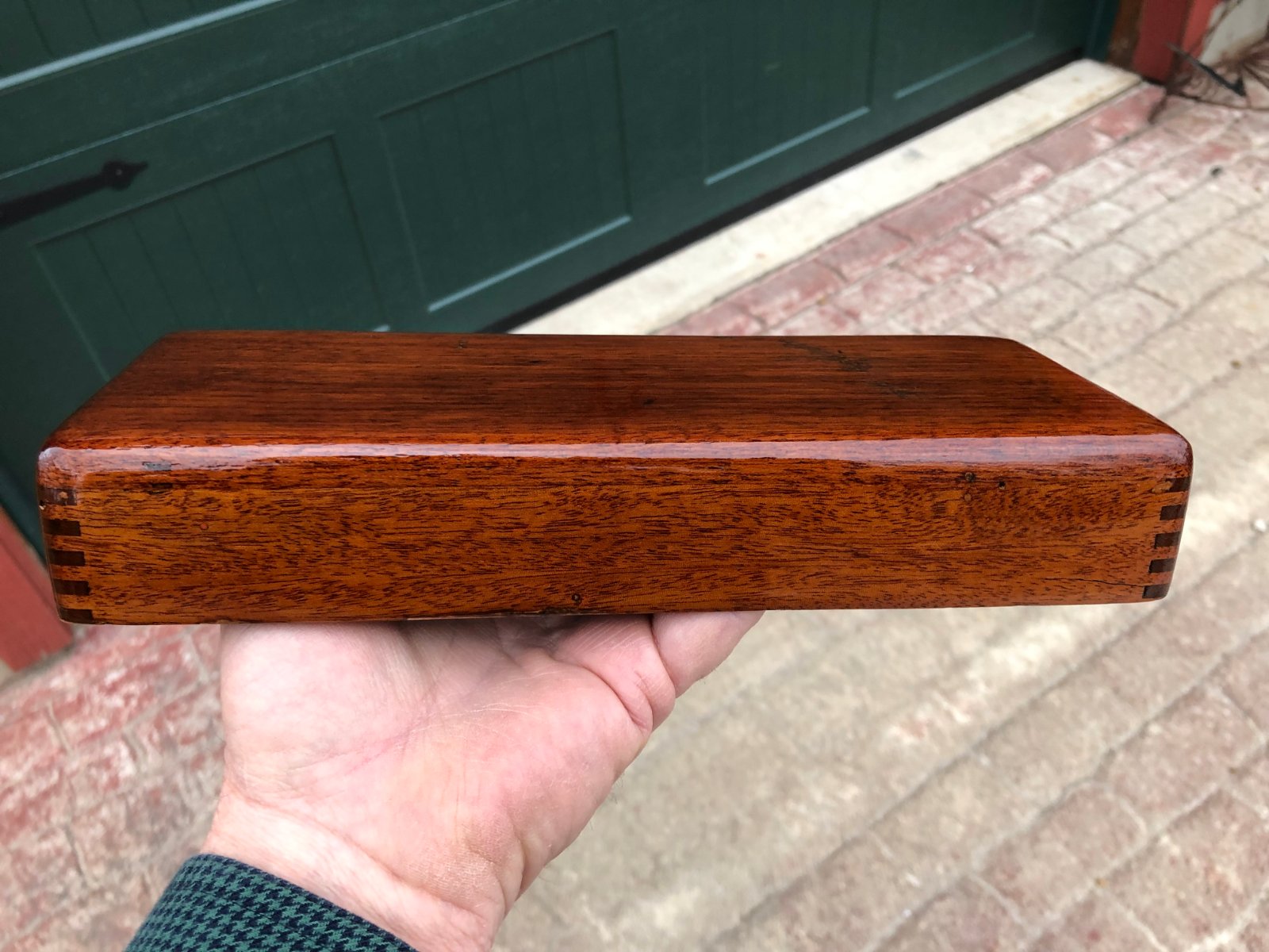

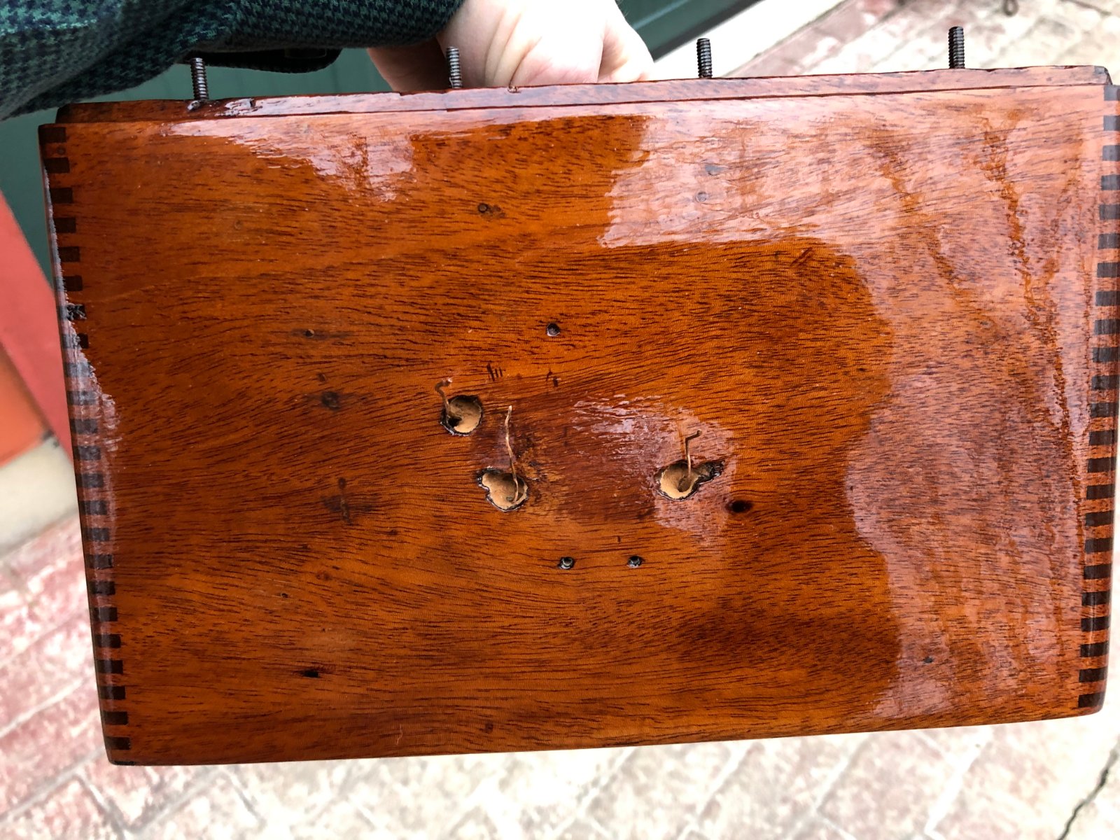

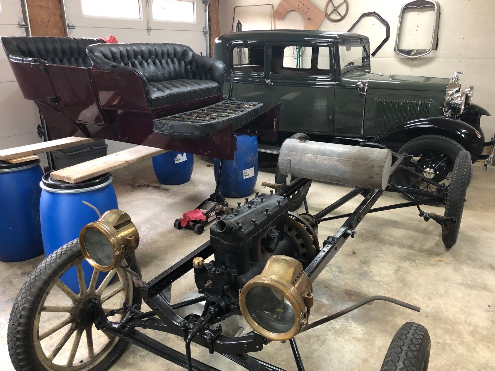

I have put new transmission band linings and rear brake shoes on, removed the body from the frame and started dry fitting some pieces. I have also made a windshield riser board and refinished the Kingston coil box. I also welded and shaped a new tip on the parking lever pawl. I need to rivet a running board bracket on and rivet on a parking brake quadrant. Art

Model A Vicky in the background?
Yes it is a 31. it is just about finished. Art
One of the prettiest bodies ever made by any car manufacturer.
