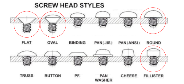

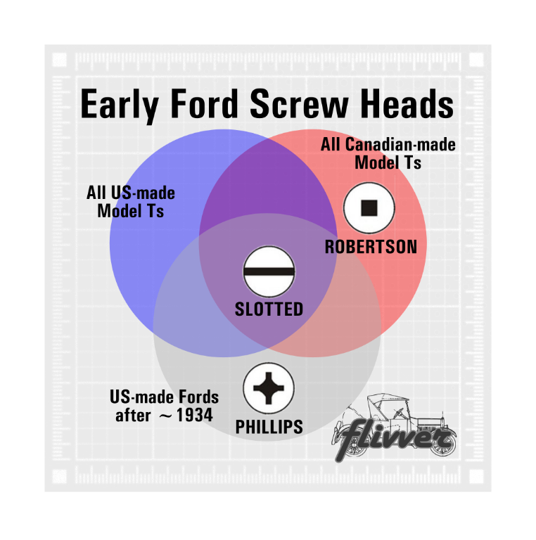

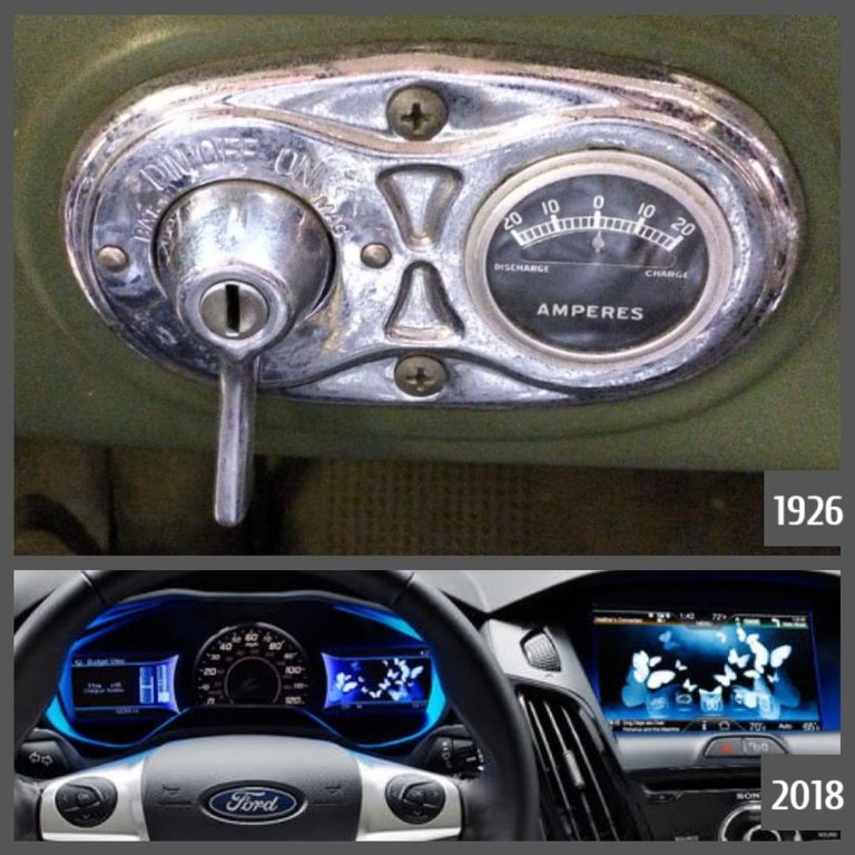

Unwitting, like a noob, I posted this picture on social media.
I was immediately 'schooled' about the incorrect Phillips head screws on my T dash. It's a US car. So I did some learning, and believe that this is now correct. Is it? TIA

With regards to the types of screws your chart is correct. However, screw heads are also different over time, those shown are flat head screws. As to the 26-27 ignition switch, you should have oval head screws, they should be nickel plated and slotted for a flat blade screwdriver.

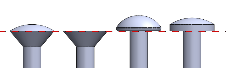

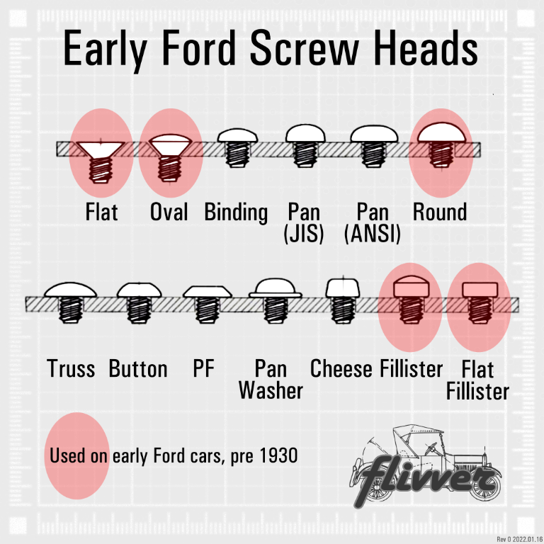

Steven, yes, some screws are round head, some flat head, some oval head, depending on application and location. Trans cover is round head, door jamb is flat head, most trim screws are oval head. Your Home Hardware in Canada uses the term oval head same as USA, suspect domed head is something else entirely. I cannot think of any pan head screws used on a Model T.
I borrowed this picture from the internet without permission.
first is oval head, second is flat head, third is round head, last is pan head.

Re: Revealed my ignorance on Early Ford Screw Heads
Maybe this is a better diagram? What do you think?
You got it Steven.

The artsy Venn diagram implies screws introduced after 1935 were used in assembling Model T's that went out of production in 1927? For that diagram to be correct you would need at least one additional axis to show time and probably a fourth to include all the shapes, domed, pan, along with the made-up names, etc,

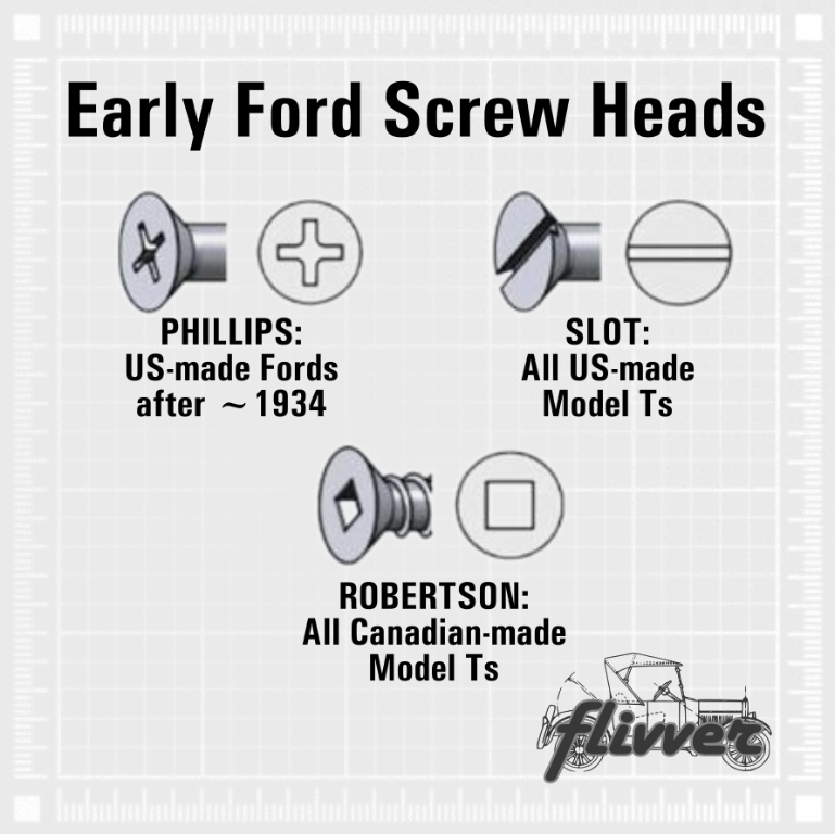

Thanks! This makes it clear that my Venn diagram seems to be correct regarding Canadian cars. As others have suggested, I may try to add to it to include head shape information as well.DJPeterson wrote: ↑Fri Jan 14, 2022 8:55 pmAs for Canadian, I restored a 26 Fordor from what I believe to have been an original car. The visible screws on trim, dash, windshield hardware, etc. were all oval head nickel plated Robertson wood screws and machine screws. Other screws were all Robertson flat head screws, not painted unless the assembly was painted prior or after final assembly, such as the door hinge screws.
I don't understand. I think that the Venn diagram correctly shows that US Model Ts use only slotted head screws, and post 1934 Ford's use both slotted and Phillips head screws. Am I misunderstanding something?
I'll think about how to indicate time and/or head shapes... But I am not sure where I can find more precise timeline info regarding screw types and shapes.

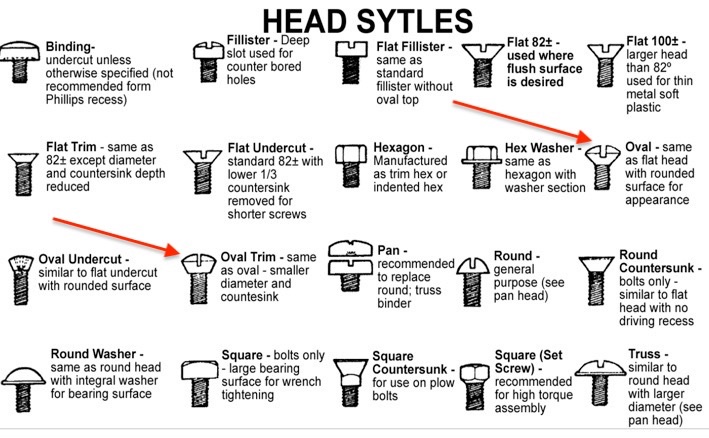

those are called cheese head screws here, like a round of cheese. That's a much more accurate description for the shape than oval head is for raised head countersunks
Seems to be English language and what the trade calls these type of machine or wood screw head types.
Here is a chart with pretty good descriptions in use today.

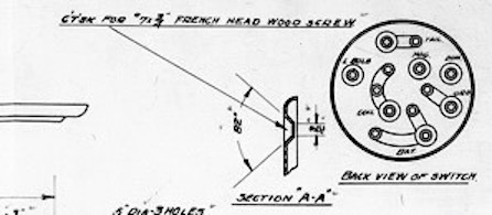

Back in Model T days of course, other terms were used to describe the typical 'Oval' head screw, the term of use was French head.
See the description for the counter sink in the Ford ignition switch plate factory print, used on the first wood dash cars, the call out is French head for that Oval head screw.
Would the circled head styles comprise all of those originally used on Model T?
Regarding Ford use of Phillips head fasteners, that began according to some early V8 car blogs, to be in the 1941-1942 era. A Restoration Book on 1940 Fords stated no Phillips screws were used anywhere.
These Phillips were used by GM for auto use, earlier use was likely with US aviation production.
"Henry F. Phillips, of Portland, OR, invented the X-shaped socket head screw for car makers who needed a screw that could be driven with more torque and that would hold more tightly than slotted screws. Car makers also needed a screw that would center quickly and easily, and could be used efficiently on an assembly line.
The invention was initially rejected, but eventually accepted by the American Screw Co., who in 1936 persuaded General Motors to use the Phillips head screw in manufacturing Cadillacs. Phillips lost the patent to his eponymous invention in 1949."

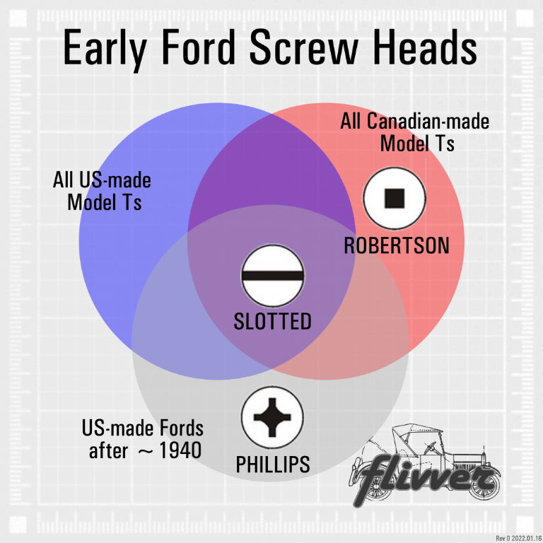

From my bit of research, and from feedback provided here, I have arrived at these two diagrams to describe early Ford screw heads. Note that naming conventions may differ...
And I have rev'd the diagrams, since, I expect, someone will correct me and I will need to update these further.
If I were a first-time observer of the diagram and chart below it, without the benefit of the discussion that preceded it all, I would have the following questions:
1. In the Venn diagram the intersection of the three screw head types is labeled 'slotted', the diagram title "Early Ford Screw Heads" but including the Model T era and US Made Fords (~1940) implies an evolution of screw heads over time from the beginning of the Model T to ~1940, so maybe Rob and Phil pre 1927 are the genetic parents of Slotted ~1940. From the discussion earlier in the thread, I think the diagram is meant to show "Screw Head types used by Ford in Assembling the Model T". Of course if Philips wasn't used, that Venn would have only two categories. A Venn showing "Screw Head Types used in Original Factory Assembly AND by Those who owned, repaired, modified, improved, restored (etc, etc,,,,) these Model T Ford cars up to and including the present date" would be much more complex, and much more interesting. I believe Martyn Vowell might need to be consulted to pull that one off.
2. The early heads profile is good, again the timeline of use of the various types in Ford Factory manufacturing would interest me. And are only sheet metal fasteners considered or are 'Screw and Bolt heads' included? And slotted, Robertson, Philips, torx, etc? Since this began as a Model T fastener thread, I'd respectfully suggest highlighting the Model T specific ones a different color, 'Pre-1930 could include some not used in the manufacture of the T, but certainly all of them and more have been used to keep the cars going since, and in the manufacture of replacements parts we all value.
FWIW, Respectfully, jb
