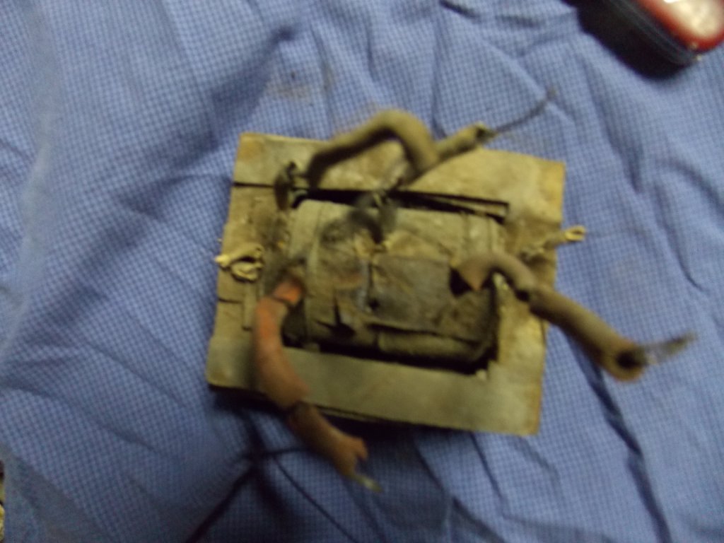

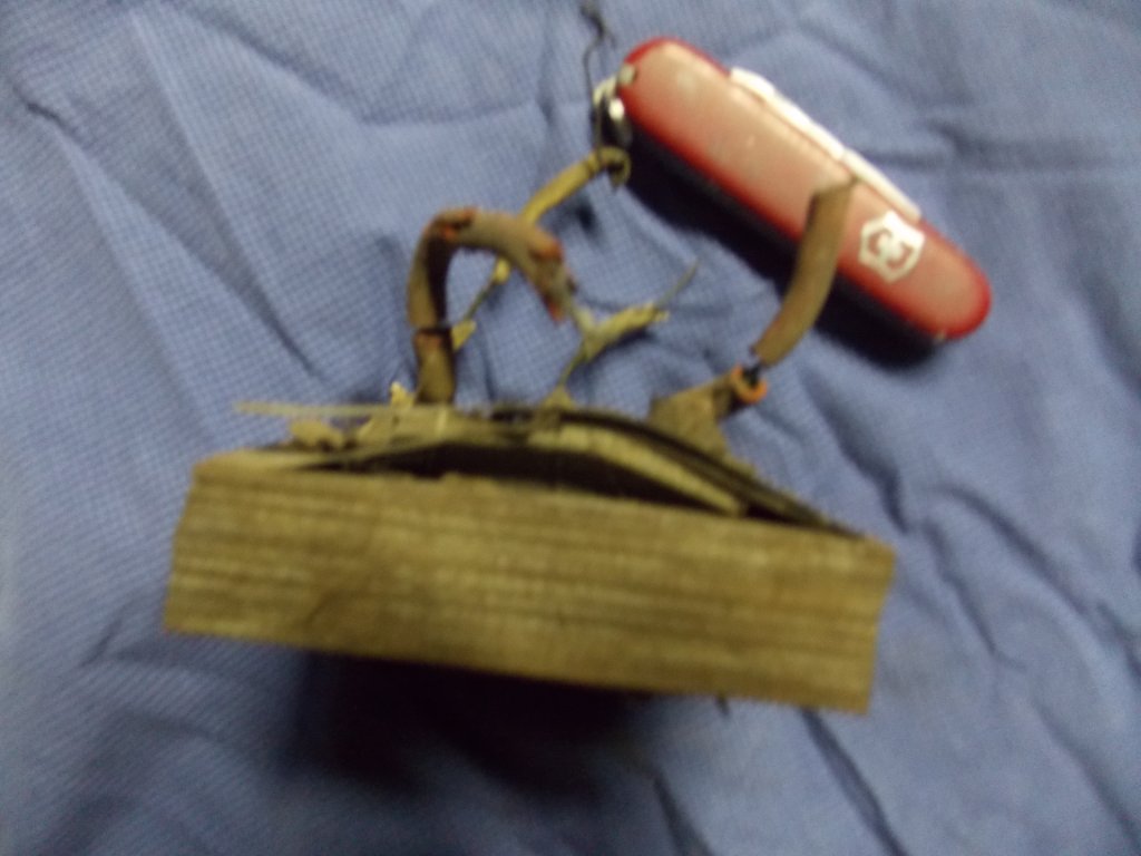

This is out of a pieces/parts tester I picked up at Hershey several years ago, it has six leads coming out of it. I believe the two reds are 110v and the other four are six or twelve volt. I tried at that time to test it but kept blowing the fuse on my test outlet. I've got a couple of older doorbell transformers I might try instead. Jim
Measures about 2 1/2"X 3" and maybe 2" thick.

- Posts: 8436
Re: Jefferson coil tester
It looks like the operational test applies 6 volts AC at 60 cycles. I assume the lamps are for continuity testing. The 18 volt tap is unused. It could be used to "high-pot" a coil to simulate operation on MAG.
