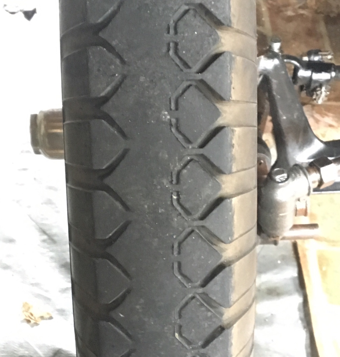

Thought I had this dialed in correctly but the passengers side in particular shows more wear on the outside of the tread.

Some extra wear on the outside tread is inevitable due to the built-in positive camber. At that point, I put the worn tire on the rear and mount a new one on the front.

Mark S is exactly right, this is why we rotate tires on modern cars. Front always wear faster.
If it steers good, you can leave it alone or lessen the toe in slightly.

While camber may account for some tire wear, bad alignment will eat 'em up PDQ.

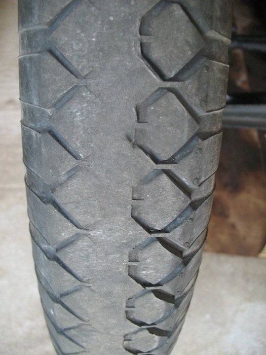

So Steve, that looks like exactly like the wear on mine. Was this due to incorrect toe in adjustment?

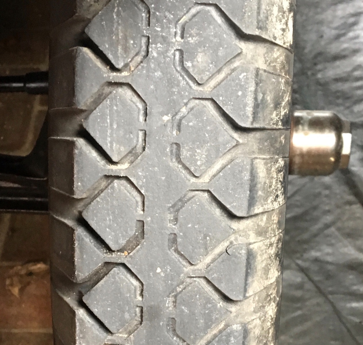

I guess I should actually rotate the fronts from left to right to make them wear on the other sides. But more work. Here is the drivers side tire.

Re: Tire wear and Toe in adjustment
Hi Mark,
The easiest way to tell if this is caused by incorrect toe-in is to check your toe-in. That should take 2 minutes or less with a tape measure. If your toe-in is not right, then this wear is probably from that. If your toe-in is correct, then this wear is probably from something else. But without taking the time to measure, I believe that your wear is likely from too much toe-in.
How many miles to get the tires to this point? Like others stated before, some amount of outer wear is normal and can be evened out with tire rotation. But if it happened fast, then it points to front end adjustment or wear.
Keep crankin’,
Eric
Keep crankin’,
Eric

...that looks like exactly like the wear on mine. Was this due to incorrect toe in adjustment?
Yes, it happened fast. Measuring the gather showed it was too much. If it's too little or negative, the steering gets squirrely and you have to keep a tight grip on the wheel.

If there is more tire wear on the outside of the passenger side front tire and not the other, there is most likely something else causing the problem. Toe in (gather) will cause both tires to wear the same, either on the inside or outside, depending on which way the adjustment off. If one side wears more than the other and toe in is correct, caster or camber may be off, or the axle may be bent/twisted. I had a problem with both front tires wearing out twice on our '25 coupe, thought I had the toe in set. After I had my Grandson help me measure it after wearing out two sets of front tires, I found out it was off by 1/8". Both sets of tires wore evenly. JMHO Dave
