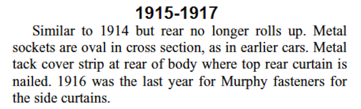

When in doubt, I look it up. The encyclopedia description doesn't go into great detail, but tells the basics.

Steve Jelf wrote: ↑Sun Jan 16, 2022 11:35 amWhen in doubt, I look it up. The encyclopedia description doesn't go into great detail, but tells the basics.
