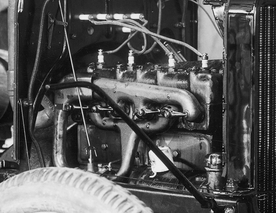

This factory photo from the mid-twenties seems to show the famous "Gilsonite wash" dripped down the side of the engine. Looks like they missed a spot on the valve cover.
