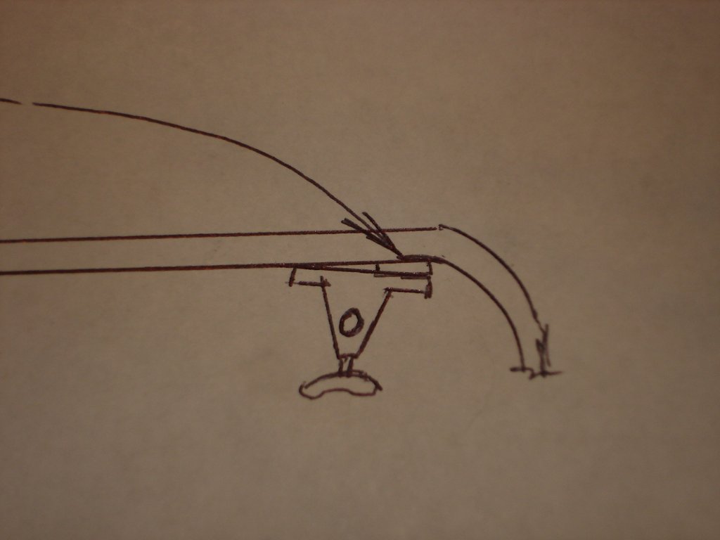

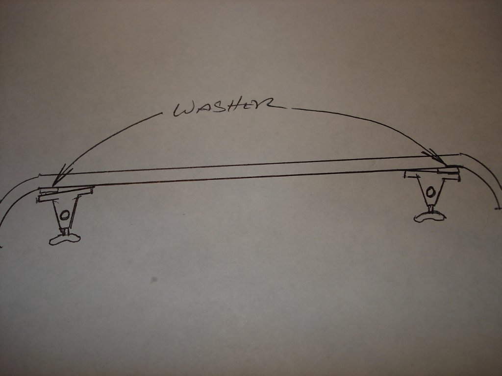

I had the same issue. I removed the clamps and placed a washer under one side of the clamp base to tilt them inwards. I also screwed a small angle iron to the back side of the bow to bring it back straight. In my case, the bow was also cracked. That sounds terrible I know, but it's actually very discreet.

Not sure I understand your question. I didn't cut or bend anything. I simply put a washer under the one side of each of the mounting flanges to make them tilt inwards. Doing so reduced the spread between the mounting sockets, allowing them to align with the windshield posts.
