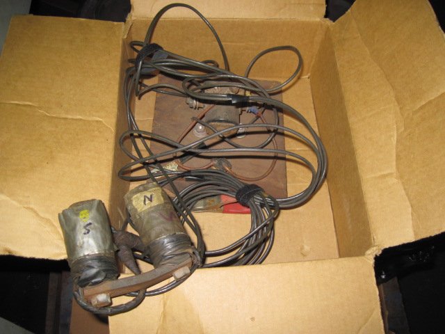

This is the one that was in the earlier MTFCA Electrical Systems Book. Part of the details and story is still there.

Bob, part of my repair required me to unwrap the wire on each coil, as the inside connection was bad.
The wire was good and reused, seems like it was 100 inches long, but the other details on the core size is lost.
That would charge a magnet to pick up very close to 4 pounds with a 6 Volt battery for a power source.
The present owner has not found it and he claimed it quit working again.
I would like to build another one!

FOUND IT.J1MGOLDEN wrote: ↑Tue Jan 25, 2022 6:34 pmBob, part of my repair required me to unwrap the wire on each coil, as the inside connection was bad.
I built mine according to Ted Aschman's tinkering tips. Tan cover.(coils only) The cores suggested are 1" .
2 delco starter solenoids. Use the heavier wire, all of each solenoid per coil.
This unit is a bit inferior to my final unit. More to come. Probably a new post.

Re: Magnet Charger Details
I have used Tony's charger and had good results with it. I didn't check the weight the magnets would pick up. Just put the engine together several years ago and still runs fine on magneto.
I have tried to charge a magneto in the car without removing the hogs head. Just connected several batteries in series to the magneto post and ground. That method didn't work very well. Yes I used the compass to check with the car parked east and west. But there could be something else wrong with the magneto. All I know is from the post to ground I get continuity, but it could be grounded somewhere between the two ends of the ring.
TonyB
- Posts: 663
- First Name: Tony
- Last Name: Bowker
- Location: La Mesa, CA
I found my magneto charger. The copper wire is 0.028” diameter with lots of turns
And no, I’m not going to pull it apart to see how many turns on each leg.
