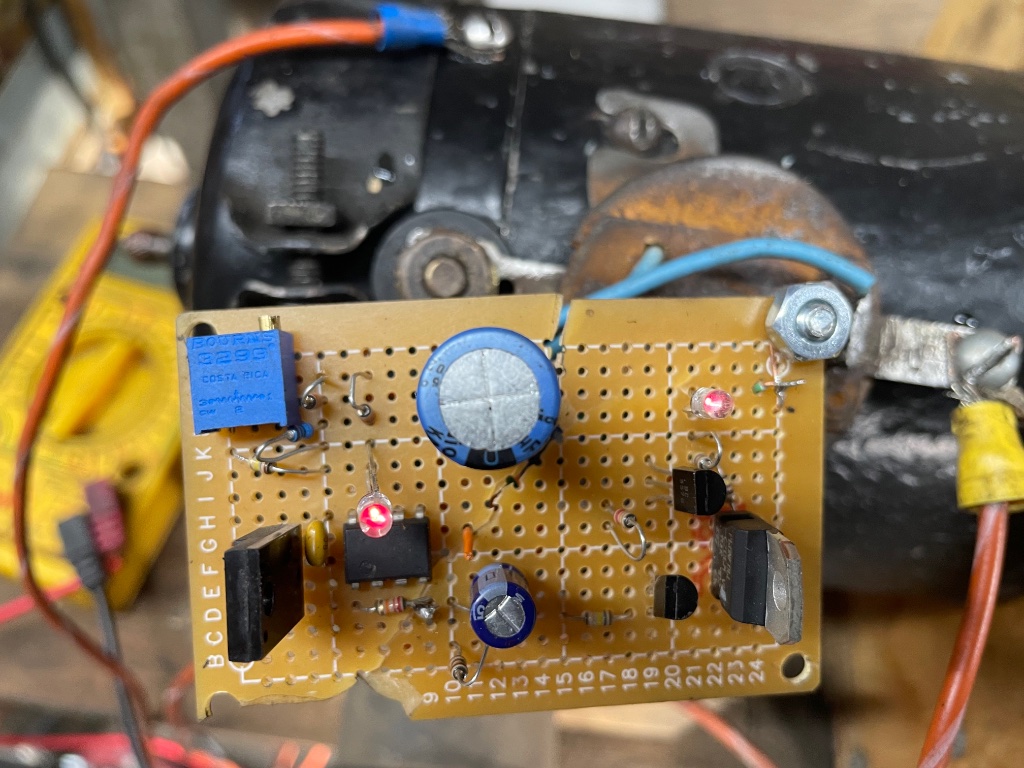

All the components have arrived for the testing of the 393 circuit. Well most as I forgot to order the 15 volt zener.
Below is a photo of the breadboard, I think it will compact down to fit in the Ford cut out housing. The quarter is to give some scale.

I applied power today and found my led only has 1.68v rather than the 1.9v on the prototype made by JohnH. I had previously been in contact with John who didn’t know the vendor part number for his led as he acquired them a number of years ago and of course they are unmarked.
I can reduce the 6.8k resistor to make it function but I wonder if this is a good idea if we are looking for a reliable and repeatable design.
I rather think I would prefer a cheap reference diode (LM385-1.2) which has know, stable initial and temperature characteristics. The cost is essentially the same as the led.
Any thoughts?
Any thoughts?

JohnH
- Posts: 374
- Last Name: Hunter
- Board Member Since: 2002
Re: A $20 (or less!) DIY regulator, and other issues
Tony, the LED voltage is not critical in itself. The important thing is that it is constant - which it should be. I found that with each of the LED's I tested, there was only about 6mV variation in forward voltage for the particular LED, over the normal operating range.
As expected, different LED's will have slightly different forward voltages, and for this reason a trimpot must be used to set the voltage.
It is quite in order to alter the 6.8k as you have done, if the LED voltage is such that there's not enough adjustment in the trimpot.
I totally agree, that for a repeatable design, especially if there's any ideas of using precision fixed resistors instead of a trimpot, that a precision voltage reference is preferable. A final version for mass production would undoubtedly be along these lines.
A quick glance at the data inidcates that the LM385 looks ideal for the purpose. Its current drain is in the low microamps which is far less than the TL431, or the existing LED. The choice between the 1.2V and 2.5V version is probably not critical, although I'd probably be inclined to go with 2.5V.

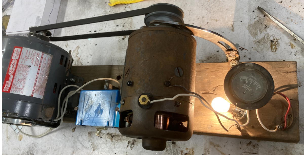

I connected up the rest on the bench and the device does function with a 180k across the 6.8k to compensate for the lower voltage of my led.
Right now the battery voltage goes from 6.3 to 7 volts. Which seems about correct.
Next is to mount the breadboard on a generator and try it out on my generator test fixture.
I agree that a 2.5 volt reference would be the best solution, my next version will use one. I have dug out an old SPICE circuit simulation program and I will verify if we can eliminate the potentiometer . I suspect with 1% resistors for the positive side of the LM393 and the 1% reference, we will be ok. The cost increase is only a few cents and we will save the cost of the potentiometer. I’ll have to learn how to use SPICE again as it’s been close to twenty years since mine was last used.

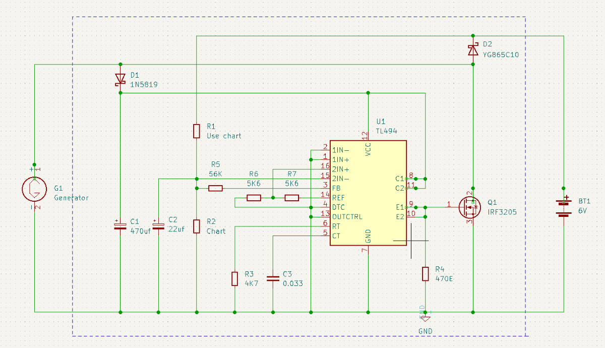

There has been quite a lot of discussion off-forum, and a lot of work going on in the Blue Mountains over the past couple of weeks, thanks to JohnH.
As a result of that here are the latest updated circuits for the two current designs using an LM393, or TL494. John's website goes into some detail regarding the operation of each design, it is well worth consulting if you'd like to know more about them.
There's a trimpot in place for the moment in the 393 diagram, but for the final design this would most likely be replaced by fixed resistors. Likewise the 494 diagram shows 'use chart' for the two divider resistors. We've yet to work on that but for an initial test at 6V the previous values we've put up should be close (and/or you could put a trimpot there as well).
What we need now is a few people to construct and test these, then maybe it'll be time to decide on which one to progress to a PCB, or perhaps both?
LM393 (note the updated cct, thanks to TonyB for spotting the reversed transistor!)
TL494
TL494

I suspect the BC series of transistors are much more common in our part of the world, and probably the UK, than with you. As you've identified the type isn't that critical in this application so what you have should work fine.
Actually I meant to leave D3 out of the diagram posted up here - it and R6 are entirely optional, they just provide visual indication of the regulator operating, which is useful for development but probably of little value on a regular car.
The Vref used in this LM393 cct is U2, a low-current regulator, however you could use a zener, and as you'll have seen John's used a handy LED in the past. You can also use bipolar transistors, except they tend to work around 6V and would need a divider, but many of these other options will require some current to operate - important given the 'always on' nature of the design. The other main reason for the precision regulator is that it makes the design more replicable - especially if one wants to construct several that leave out the trimpot and use fixed resistors to set the regulating voltage.
It looks like this thread viewtopic.php?f=2&t=24523&p=188170 gives some reasonable information on generator RPM.
I too have much unloved experience of making boards for various projects, hopefully once we've settled on a design someone will lay out a PCB and we can investigate options for making those generally available - Mike has had some good ideas around this, but first we need to have a few regulators prototyped and tested on cars before we go any further...

The generator is geared to run at a 50% faster than the motor. So my test stand uses a1750 rpm motor which I suppose is equal to about 37mph in the car.
I now have to get out my big soldering iron to connect the circuit board to an old cutout base. Tomorrow is eye doctors all day, so Tuesday should be the big trial on an actual Midel T generator.

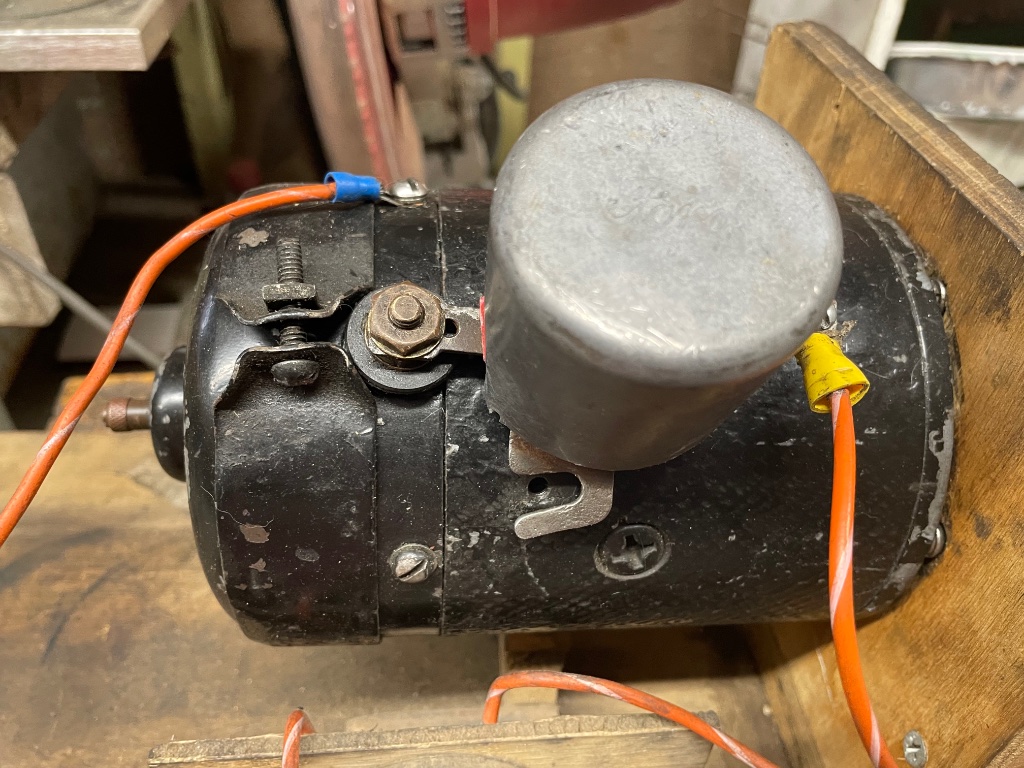

After a few mis-steps the LM393 curcuit is working on a generator.
My first problem was I dropped the breadboard and it cracked across the middle. I fixed that but the 22k resistor on the 393 pin 1 broke. I fixed that. Then the generator in the test fixture died. I’ve not investigated that yet. I found another generator on the bench and the controller works perfectly. I want to run it for a good few minutes checking the temperature of the FET. Also I want to disconnect the 2200uF capacitor to see if it provides any useful function. After that I’ll run the SPICE simulations and determine the values of the resistors on pin 3. My current set up is to turn the charging off at 7 volts and back on at 6.3 volts.
Are these good values to keep a battery fully charged?

Good to see the progress. I'll be interesting to see what temperature your FET & Schottky get to without a heatsink.
The ideal charging voltage will depend upon the battery chemistry. As many Pb batteries today use calcium as a component the requisite voltage for proper charging is a little under 2.67V per cell or 7.4V for a 6V battery.
If it's not a calcium battery you should lower that to around 2.35V/cell or ~7.05V for a 6V battery.

Great work Tony, glad to see it's working. You can increase the 180k resistor if you want the switch on and switch off voltages closer together. If taken too far however, the circuit becomes unstable. Also, some adjustment of this resistor might be required if different values of resistor have been used for the trimpot, and the two resistors either side of it. Of course, once it's on the car and the wiring resistance to the battery becomes part of the circuit, it will probably be necessary to readjust the trimpot anyway, which will bring up the switch on voltage slightly.

I have continued testing the breadboard and everything appears to be Ok. Initially I ran it for about 20 minutes and then suffered a failure. Two items were found faulty, the insulation on the base of the cutout failed and the soldered lead to the 22k on pin 1 intermittently broke. I think both were caused by the excessive vibration from my test fixture. For the next long term run I moved the board from the generator base and everything worked perfectly for 30 minutes. This included adjusting a load to the battery to increase the frequency of switching to about once per second from the ten per second cycle with no load. The FET only went over ambient by one or two degrees. At a continuous 20 amp load the diode ambient increased by about 7-10 degrees F.
My next move will be a new circular baseboard that will fit in the cutout case. It will delete the 2200uF capacitor, both LEDs, the potentiometer and add the LM385-2.5 voltage reference. I also have to rebuild the cutout base to eliminate the short to ground.
So don’t look for too much for a couple of weeks unless someone is working on a PCB layout

Im so close... Of course I didn't have a generator laying around so I had to build one from an old core. So that took me 1/2 the day, mostly bc the unit I started with was a rusted, sticky, oily mess. I just finished putting my Starter/Generator rebuild station together so that was timely. I forgot how much I detest rewrapping generator field coils.... But the Generator worked right out of the gate so I haven't lost my touch!
Everything is mostly hooked up and the circuit is built. I forgot to order the 15v zener, but I have some 7.5v zeners. 2 in series should do it. I'm still recovering from COVID from last week so I completely ran out of steam this afternoon. I'll fire everything up tomorrow (hopefully, no fires). I did completely fill my shop with smoke from a battery charger that completely bit the dust. That was entertaining. I now know my new panel & circuit breakers work.
My test rig is running at 1714 RPM at full blast (I use an app called Strobelight on my iPhone to get RPM). I'll be able to vary the RPM and current output of the gen by loosening and tightening up the belt. That will be interesting. Now I just need to find my frigging Oscilloscope. I know I packed it before I left CA...

I’ve finished my second prototype
I left the forum a couple of weeks ago to build up a second prototype that I hoped would fit in a Model T Cutout case. After studying the circuit for a while I had some personal technical reasons for not being happy with the npn/pnp driver, so my version is revised with one less transistor and slightly less current draw when the generator is off.
Initially I also deleted the led attached to the output clamp but I subsequently missed it when testing, so I put it back which explains the 2.1 version. I also used a precision voltage reference in place the original second led.
So this is my current schematic. Next was build a second prototype to fit into the existing cutout case. The insulation on my original case failed and shorted out the generator permemently. I purchased some thin insulation and a day later I had a new insulation set. Then I made a round board to fit in the case. And then adjusted the major component to fit around a central mounting and ground screw. A photo of the finished design is below The position of the led is not optimal as it cannot be seen with the cover on!
Of course with the cover on, it looks just like the original. I have not had it on a car but it runs just fine on my test fixture which is a good simulation, indeed the vibration on the fixture is greater than on the car. I have run the generator for about an hour with minimum load on the battery when the led is on most of the time during which time nothing overheated (especially checking Q3). When a large load was applied to the battery (5 amps) the circuit was firmly turned off, again nothing got hot (especially D3). The voltage a which it stops charging is about 7.2v and charging is resumed at 6.3v. These numbers were confirmed by a SPICE simulation which gave theoretical results of 7.19 and 6.19. The theoretical range of adjustment with the 500 ohm potentiometer is about 0.14v though this has not been confirmed on the prototype as yet.
So yet another “393” model works with no apparent glitches.

I installed the regulator on the 24 coupe generator and it works just fine. Initially after startup the ammeter is charging at full rate then after a few minutes the needle swings back and forth and a couple of minutes later it drops to zero. I measured the voltage at the battery and it read 6.37 volts. I turned on the headlights and the generator started up again.
Next I have to puzzle out if I want to put holes in my cutout cover to see the led and adjust the potentiometer.
On the second comparator, it is there and I alway connect the inputs to unused parts just to avoid any unwanted problem such as superiors oscillation. I have puzzled how to use it. My objective to use it was to reduce quiescent current when the ignition was off. I came up with nothing!

At least we can’t be accused of copying the Fun Projects design
The deletion of the dual follower with a inverter came out of my head. By the way everything I have contributed is open source, anyone is welcome to copy and sell if they want.

I've responded in group email suggesting that you and Tony might want to try the design at the full output of the generator, as well as at the 5A level. That way the FET will be sinking max current, and the Schottky passing max, so we'll get to know what, if any, heatsinking is required.
I agree the 3524 is a useful looking IC, however I'm still a proponent of the 494 which in practice should provide similarly smooth PWM control and perhaps be more accessible.
Hopefully Tom will also let us know how his 431 design is going. At that point I think we might have enough designs to be going on with, although I guess we could consider a microprocessor design using something like an ATtiny85 or similar. That'd make the voltage settings easy but perhaps make it less attractive to the home builder...

In all my tests my generator has been set to 10 amp output.
Previous to this work I use a regular diode in place of the mechanical cutout and they never overheated.
My second prototype has run for over an hour with various loads and has not “burned up”.
John has run his model some 300km, which at 30mph, is approximately six hours.
Please don’t spoil our fun, if you don’t like what we are doing, don’t read the thread.

I just wanted to share some information about the design I was able to work on. First I was just the tester as this electronic stuff is a little beyond me. It was my best friend, an electrical engineer, who designed this after I asked him what he thought about designing a regulator for the model t. I gave him all the information that had been posted and he came back a said I can do that. And here is we have. I should also note that I have been using a FP regulator for 20 years with no issues. So I have been quite impressed with the idea of having a regulator.
“The hysteresis in this design produces a 1-2 second on-off cycle between ~6.7 and 7.2 volts, no charging or cycling above, no cycling if enough current is being drawn. The value of R9 can be reduced if you want slower on-off cycles and wider voltage break points. R1 and R2 may need to be changed if you want much more hysteresis to keep charging below 7.2V. I would recommend that both power devices be heat sinked and connected like the original design. 10 amp traces would need to be around 300 mils wide, best to leave both power devices down on the can base with direct connections to the terminals. About the best you can do on the Schottky is .5V and at 10 amps would be 5 watts. Junction to case in air is 60 C/W which would put the junction at 300C. Even at 5 amps 150C is too hot. If the MOSFET is driven with at least 6 volts the on resistance is low enough to only produce around 1 watt. This means no diode drops and minimize the drop on the filter resister. I also recommend using the Varistor, R7, to protect the MOSFET. The Varistor capacitance helps with dv/dt breakdown and gate shoot through and hard clamp protects from overvoltage and ESD. Zener D3 protects Q2 and VR3 from over voltage. C2 should be a low ESR style like A759MU337M1VAAE22, the value could probably be reduce but its not very large or expensive. Parts should be chosen for at least 85C and preferably 105C or 125C. The engine compartment can be very hot. Also, I would suggest very similar mounting to the original design with multiple mounting points for the PCB which can also bring the connections to the board. Lots of heat and vibration to consider.
Hope this helps (my friend Paul)”
Tom
Tom

VERY interesting. I just ordered some TL431s. I’ll breadboard this design as soon as I get them.

This my second try as the pictures were too large and some how the whole post dissapeared.
My PCB arrived and I populated one for test over the weekend. There was some finger troubles, I must be getting too old for this game. After a couple of challenges it works fine on the bench and on the test fixture. It worked quite well but the switching voltages are a little different from the simulation which is concerning. I then installed in the coupe. Again it functions but just before it reaches fully charge it oscillates s little and once at full charge turns ON and OFF as expected. Testing was cut short as the coupe ran out of gas
The only difference I know of between the test fixture and the coupe is the age of the generator. The one in the coupe is probably 20 years old and the commutator is well worn. The generator in the fixture is essentially new with nice fresh under cut on the commutator which may reduce electrical noise.
Today I refilled the coupe with gas and tried again this time with more success. Overnite I added Jeff’s capacitor across R6 (the feedback resistor) and it quieted down the on/off oscillation and made the voltage setting more or less agree with the simulation.
So we can add mine to the list of working LM383 models that that work well.
I’ve got a couple of tours coming up but I’ll build up another model for the speedster

I have had success with my bread board 494 version. As I have experience hand soldering SMD parts I thought producing a board sing these components would allows for a smaller board, in this case 35mm X 35mm which fits on the bottom of the original cut out can. D2 and Q1 will fit on reverse side of the board (not as pictured) and folded back under the board and bolted to the bottom of the can. This is my first attempt at designing a board! I am using the free EasyEDA software and struggling a bit. Bit of a way to go with routing but If I have success I will be happy share the gerber files.

John,
Thanks for putting that up and well done with your first attempt, it will be good to hear how you get on with it. Good to see someone trying out the 494 cct as well.
While I like the look of Tony's round board (and the one I did earlier) it has to be acknowledged they're not very efficient in terms of PCB material, your square design is much better in that regard. The SMD will further assist that as you've noted.
Are you going to produce the board yourself, or send the files off and have it done? I guess the smaller board etc will assist costing, although Tony's was hardly expensive. Presumably if one was to have these populated by a board manufacturer SMD would be cheaper than through-hole, have you investigated that at all?
Luke.

Any questions you guys would want to ask him? I gave him background on the project and asked this:
Using the LM design will this oscillation of charge from ON/OFF at about 5-10 second intervals once the bat is charged have a detrimental effect on battery life?
Would the TL design be a better option?
What are the optimal floor and ceiling charge/discgarge voltages in this application? We use 6.2V and 7.3V was a general rule.
Any other design considerations we should think about?
Any other observations from an expert in this area would be instructive.
With your permission, I’d like to post your response to the broader audience so we can all learn from it.

Back on March 1 I mentioned that my tests with a flat battery had shown that I needed a heat sink on the diode. The simplest method was to bolt the diode to the base of the cutout and then solder the diode leads to the PCB. It’s a bit messy but after drilling a very carefully placed hole and cutting away some of the new insulation it seems to work quite well.
As you can see by the led being lit, the device still works as before.
I probably have enough parts to build three more regulators, I need one for the speedster, would anyone else like to try one as part of the ongoing tests. If so, let me know by email and I’ll see what I can do.

My cutout housing version with PCB is now complete. I designed a PCB with DOS Protel on my 386, and used the toner transfer method of applying the board resist. The circuit is exactly the same as my prototype, which has proved itself over the past four months.
Details of the process are here https://www.cool386.com/pcb/pcb.html
Because of the unusual construction of my particular (repro) cutout housing, I had to fabricate special brackets to mount the two power semiconductors. This in turn required a board design specific to this unit. However, I'm pleased with how it all turned out.
I decided to retain the Vref LED in view of its advantages, and to make this and the Charged LED visible without drilling into the cover, I simply rely on the LED's shining through the gap above the generator terminal strip. I'm happy with the results. However, it's obvious the mild steel body of the cutout housing is inferior for heatsinking, as compared to the diecast aluminium boxes I've used for the prototypes. The whole heatsinking arrangement I've used would not be suitable for charge currents of more than 5A unless a diode with much lower voltage drop was used. Full details on the design are as before, here https://www.cool386.com/ford_regulator/ ... lator.html

Fantastic job John documentung the PC board fabrication process, building the pcb version of your design and installation in a cutout housing. Thank you for sharing your knowledge and experience.

Great to see Protel again after all these years, and inspiring to see that basic simple methods still work well for making PCB's.
Well done
Well done
