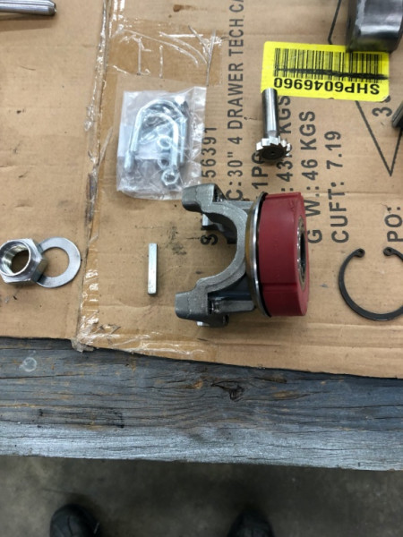

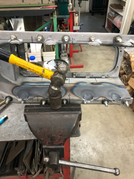

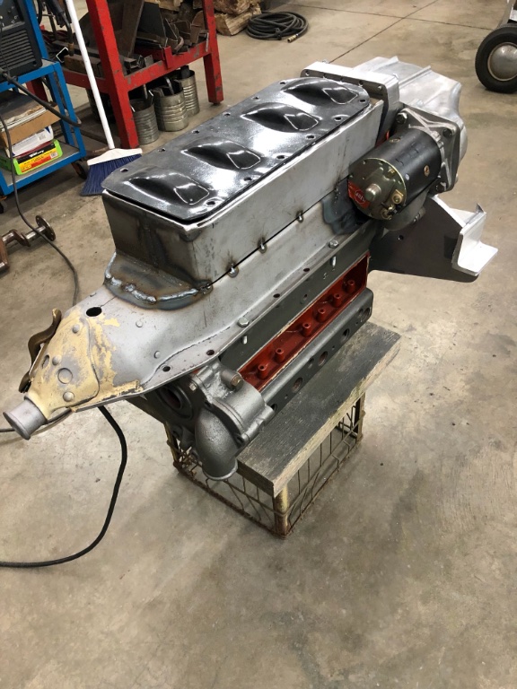

Post by Henry K. Lee » Fri Jan 21, 2022 6:52 pm

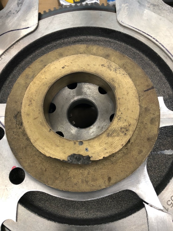

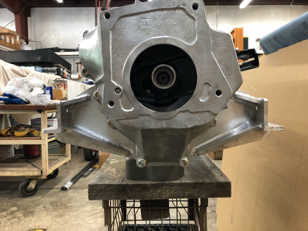

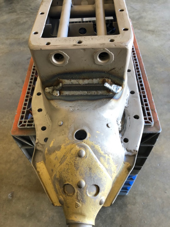

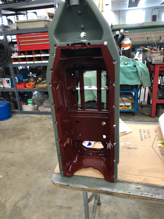

This project was on the back burner for quite awhile. Was suppose to be used for a Model T project I was building to go to Bonneville Salt Flats for an attempt at 220 MPH in a Model T. The good ole boys and their stupid rules and interpretations, No Thanks! A stock Model T transmission with all that weight is a power stealing hog and also steals fuel mileage. Going dry as the Dodge Bros suggested to Henry Ford would gain better fuel mileage and power. Well.., He did it on the Model A! Going dry clutch with a Mustang SVO 5 speed, in front..., a Joe Gemsa head with a Super Stroker Balanced Skat cranked engine. This only took 10 hours today since it is a one off proto type.., more to come later. That pile of 6061 series aluminum and all the attachment hardware is only $900.00 now. Frickin' OUCH! Slow cutting 1" Billet!

Looks great. Nice to see I’m not the only screwball!!

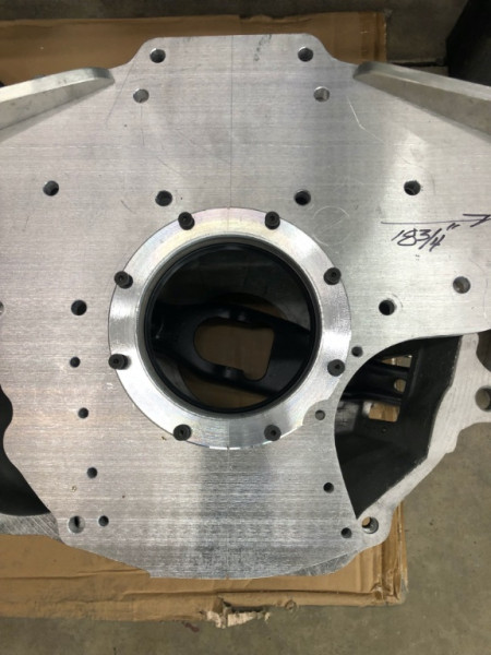

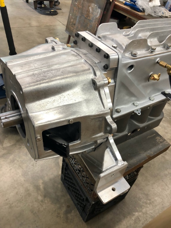

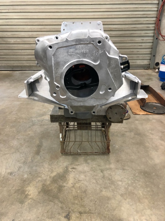

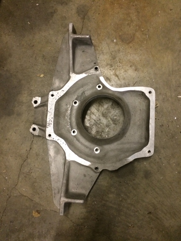

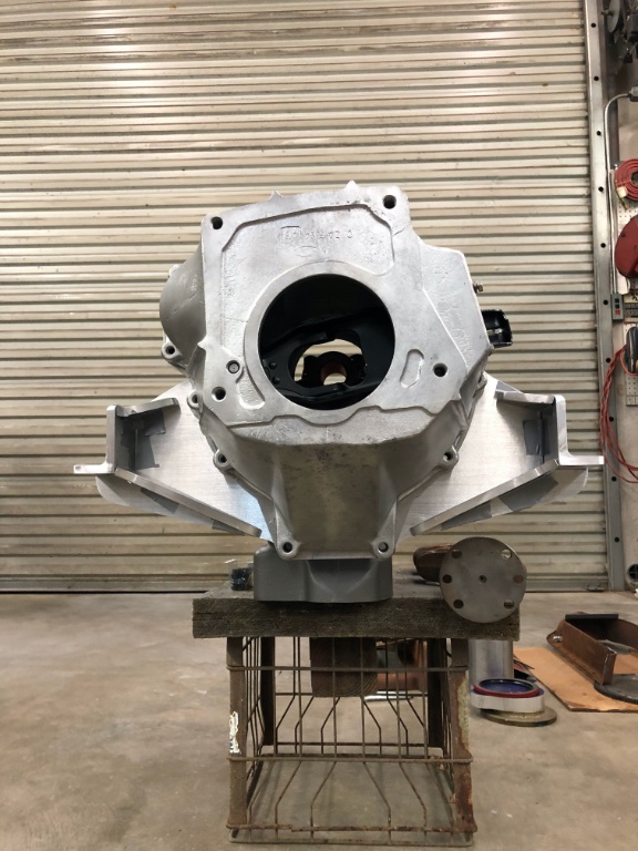

This casting takes any ford transmission from a 2.9 l or smaller engine

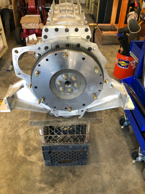

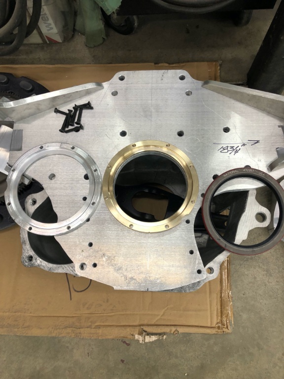

The one I have pictured is staying with oiled multidisc clutches! Borg Warner T35 automatic from a 68 Cortina. Couple of nice features are the air cooled torque converter and a cable kick down.
I’ve done a couple of T engines using the T transmission with the flywheel NOT running in the oil. I oil the transmission from the inside with a drilled main shaft. Works great.

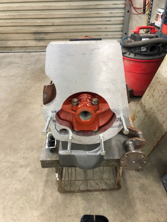

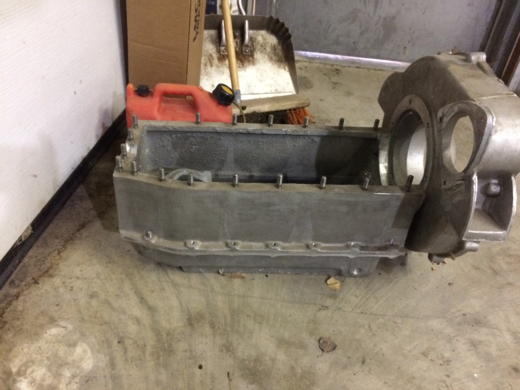

Re: Going Dry for More Power

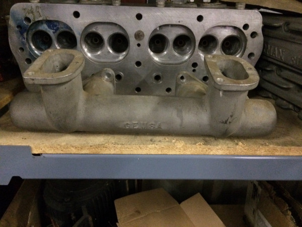

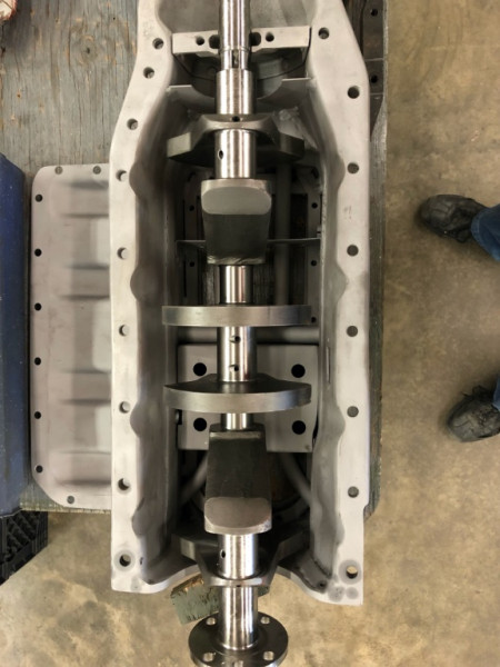

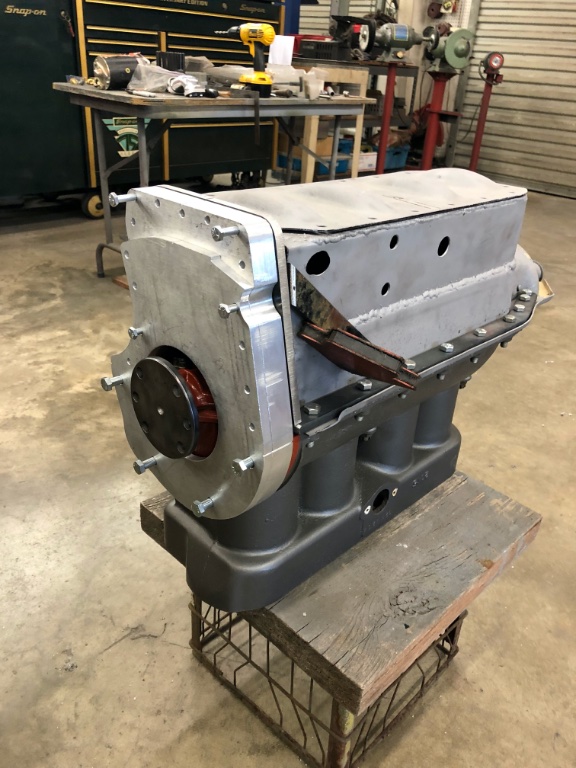

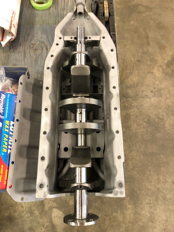

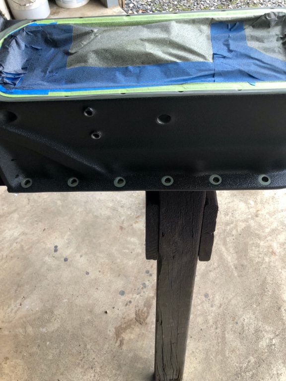

Post by Les Schubert » Sat Jan 22, 2022 4:04 pm

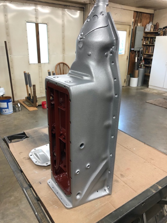

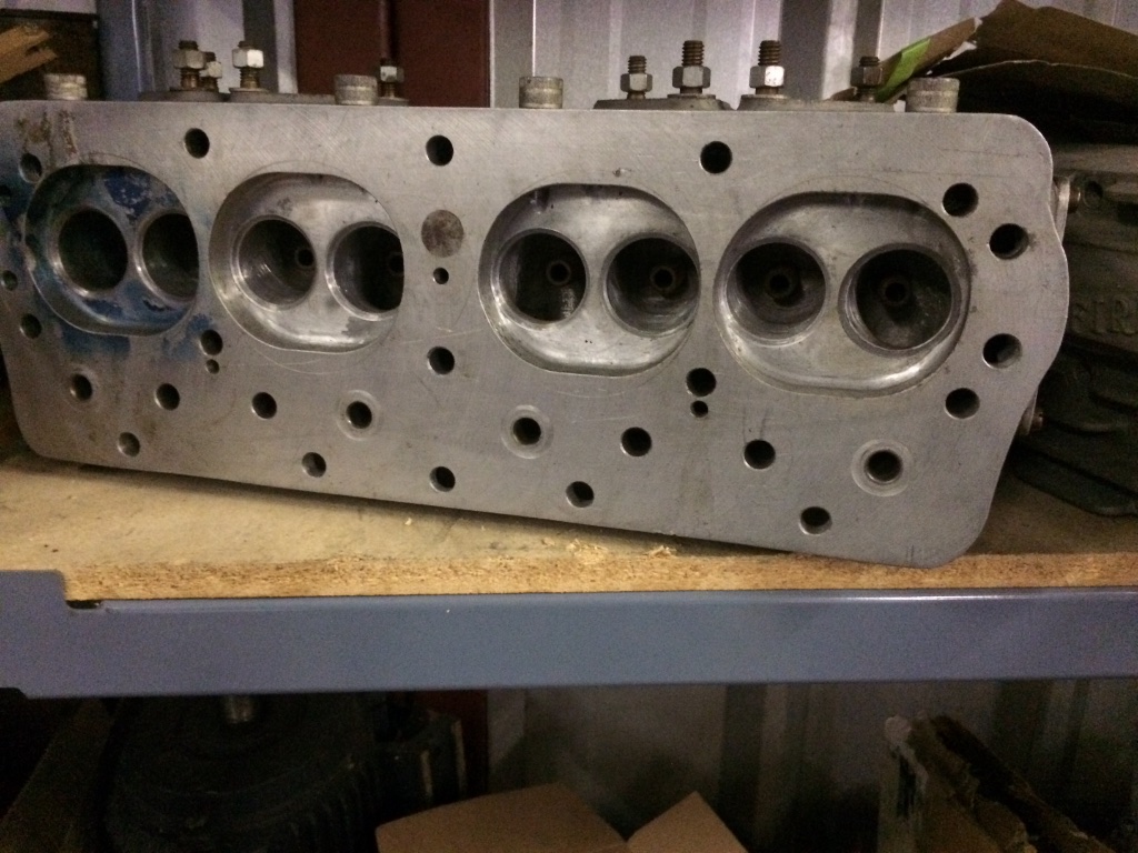

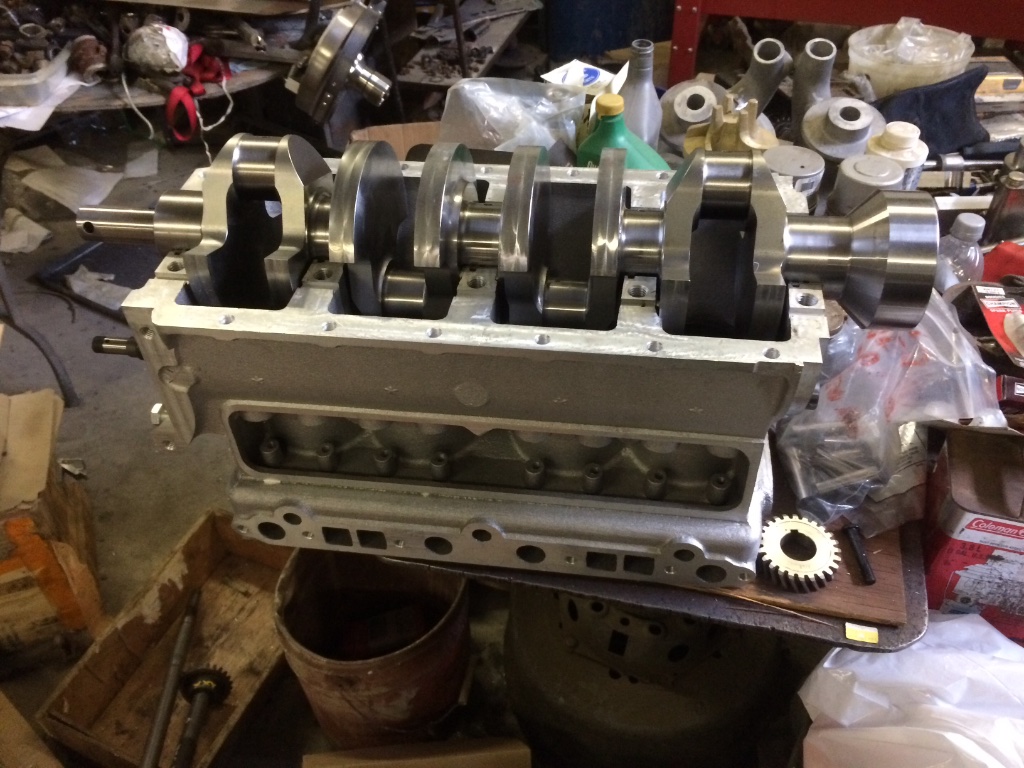

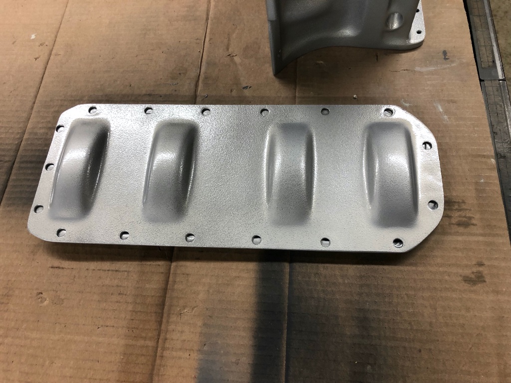

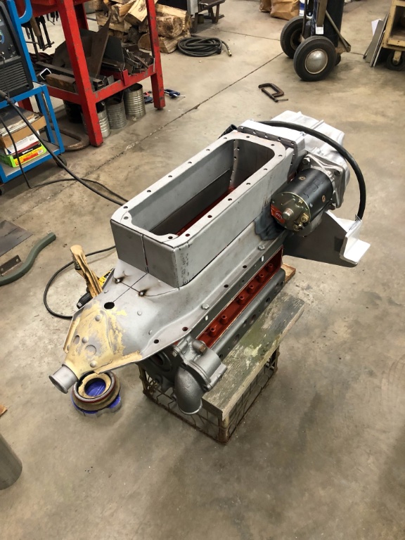

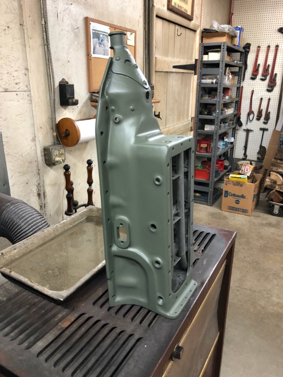

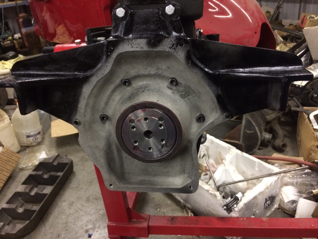

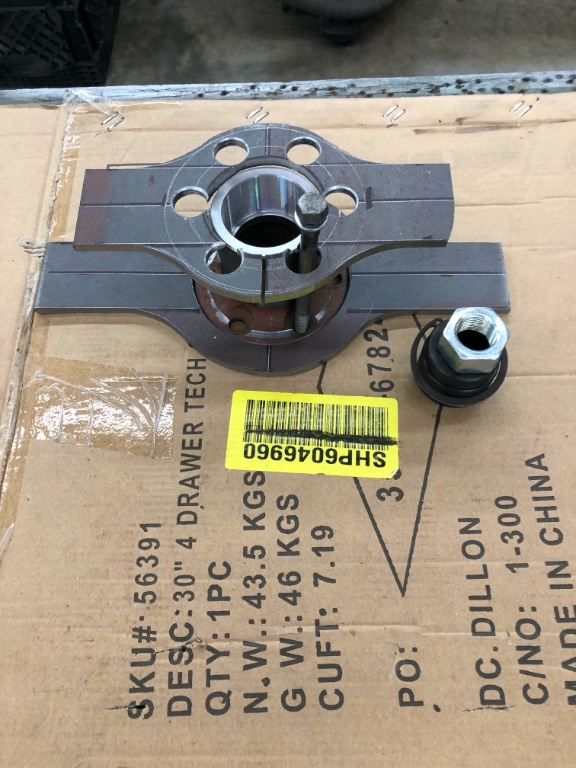

Gemsa head
The intake manifold for 2 V8 carburetors
The oil pan
304E5AA1-AC4A-4093-9476-9220C46533C9.jpeg[/attachment [attachment=0]B3E2FF41-E147-4F29-AF35-C0D13DBFD580.jpeg

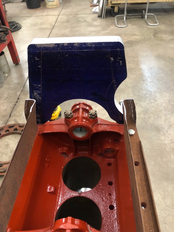

And the block

Post by Les Schubert » Sat Jan 22, 2022 4:18 pm

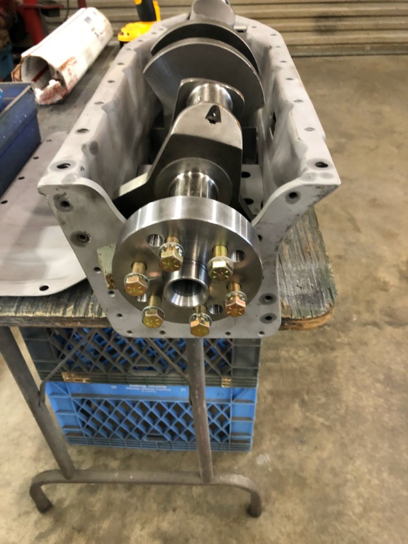

The block

My Model T engine has three main bearings; yours has five. What year did a Model T Ford engine have five main bearings?

Looks like the same year they went to aluminium blocks and four intake ports.

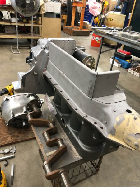

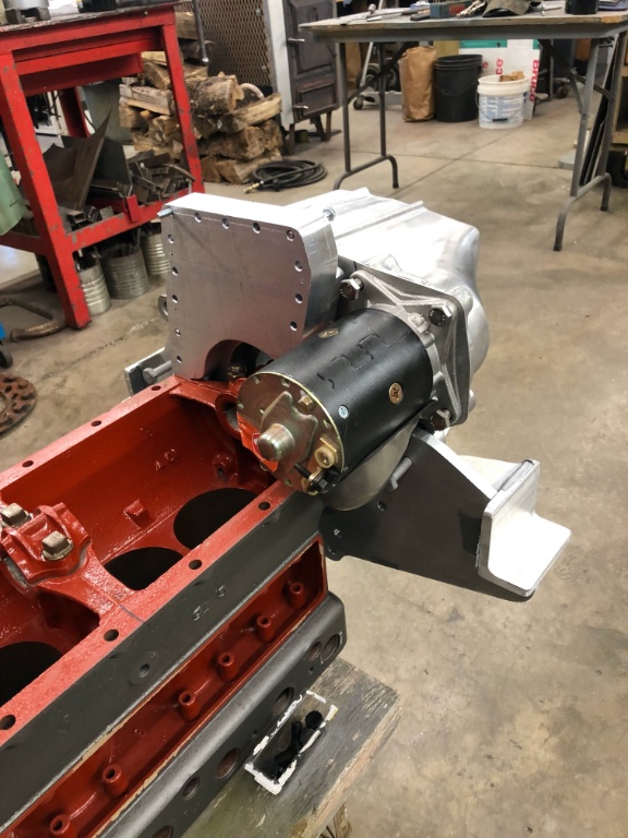

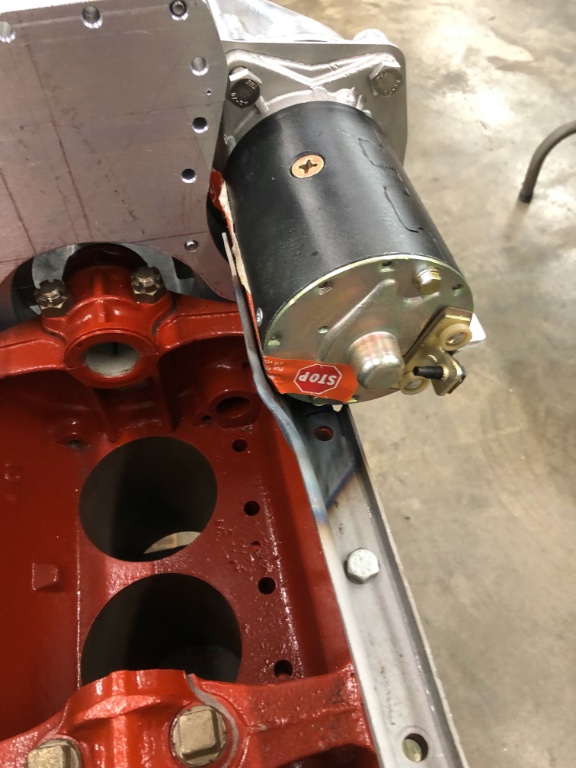

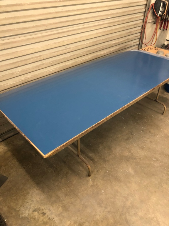

Post by Henry K. Lee » Sat Jan 22, 2022 6:43 pm

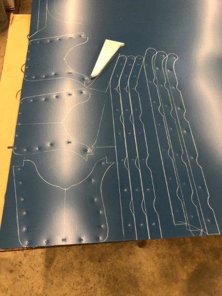

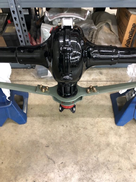

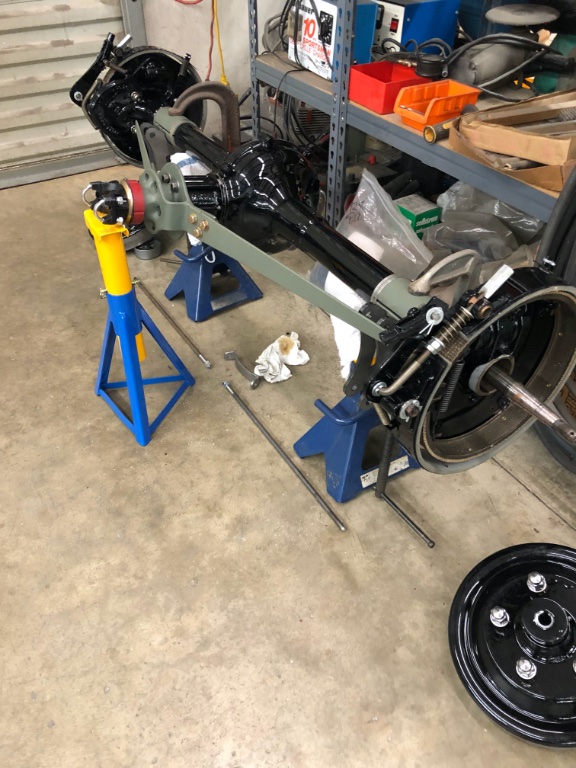

Well another 10 hour day that was very productive!!!!!
The duct tape holding the wing reinforcements on is Gorilla Tape..., All Good!

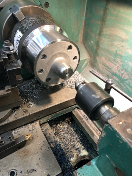

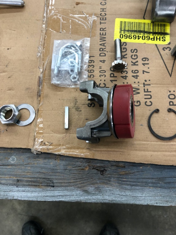

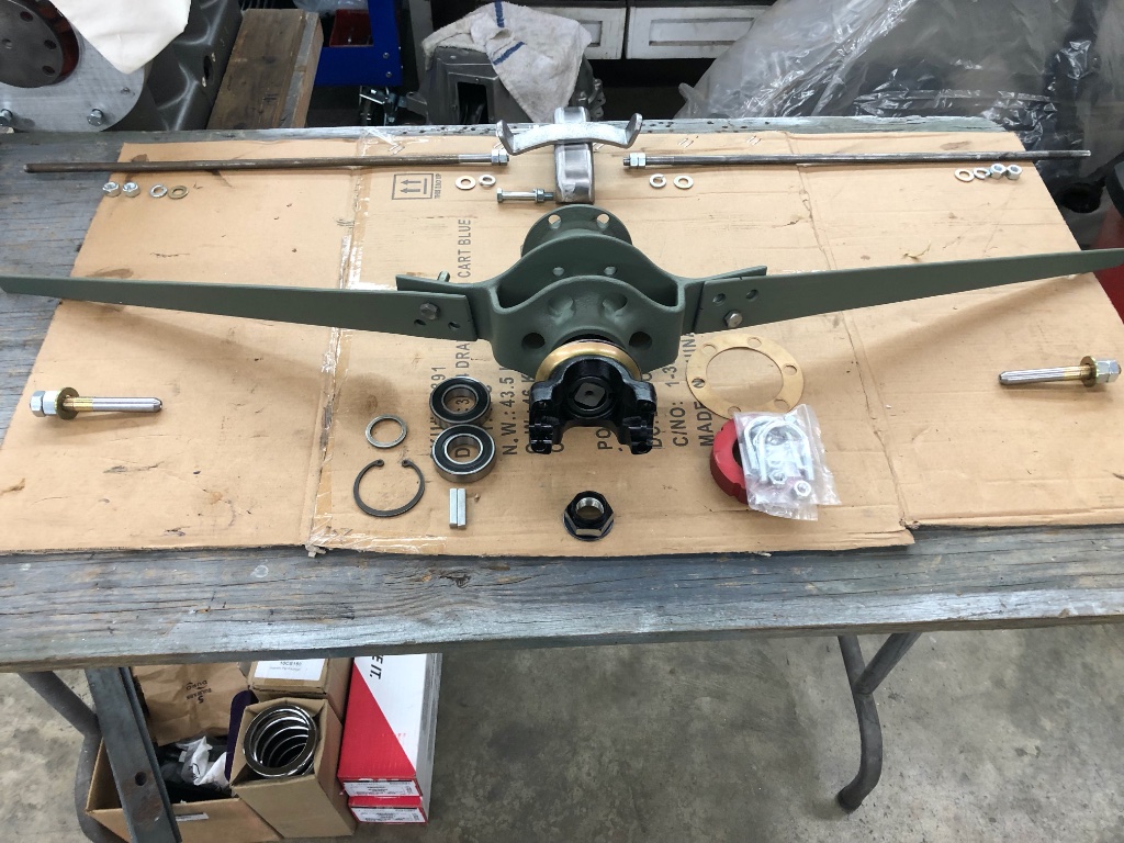

Post by Henry K. Lee » Sun Jan 23, 2022 7:14 pm

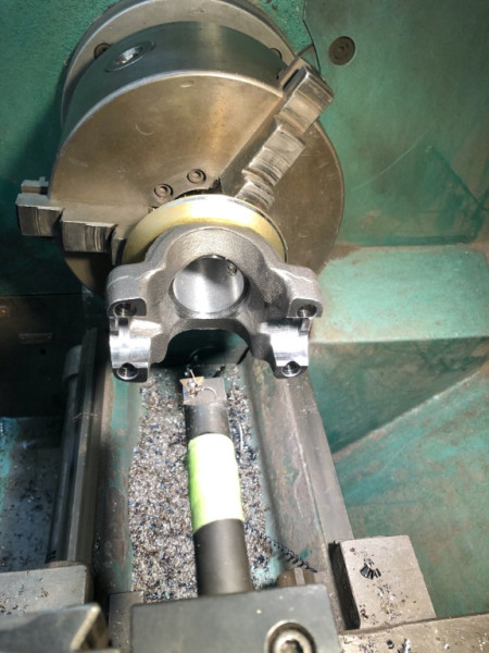

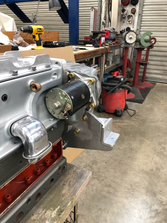

Well, got 6 hours playtime in today at Frank N. Steins playhouse!

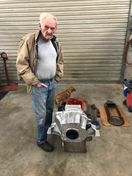

Thanks Les!!!
I still need adult supervision, Dad after a nap with the mouse getter. He will be a big 90 Feb 2, 2022. Glad I still have him.., he still inspirer's me every day!

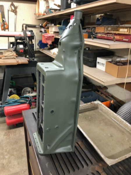

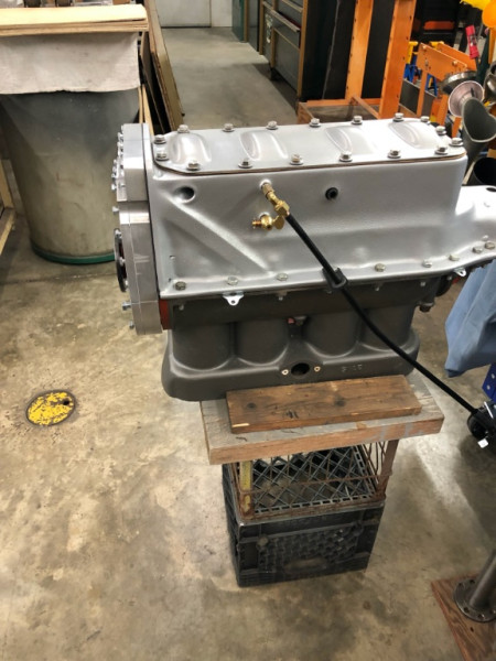

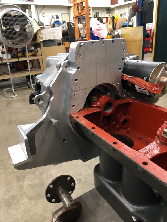

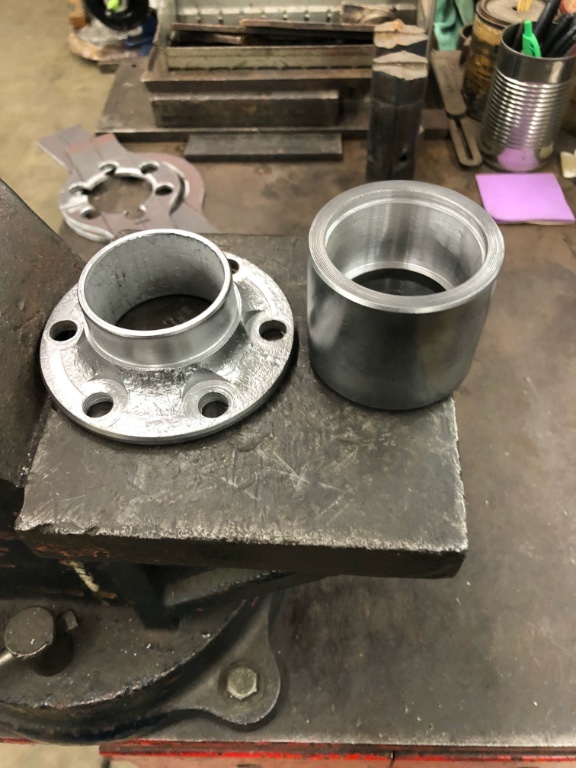

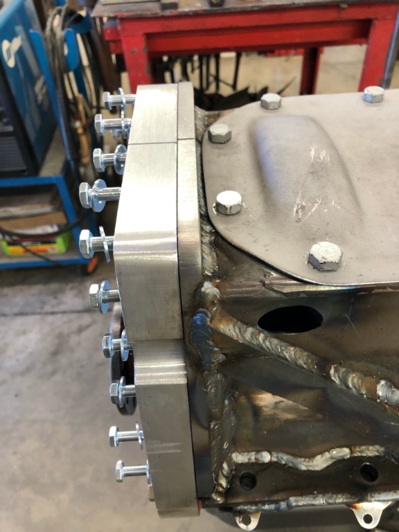

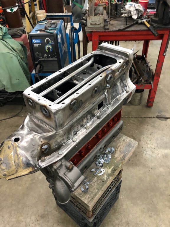

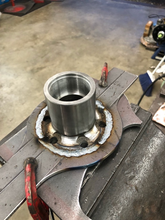

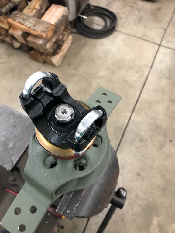

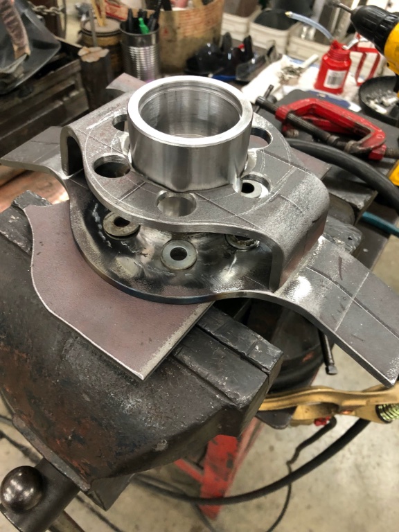

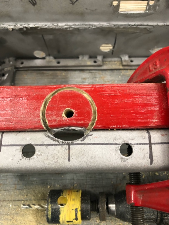

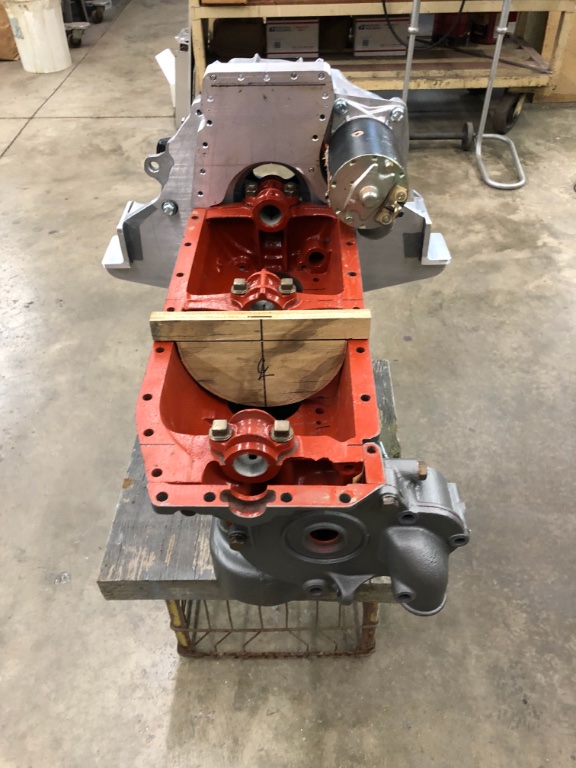

Post by Henry K. Lee » Mon Jan 24, 2022 6:52 pm

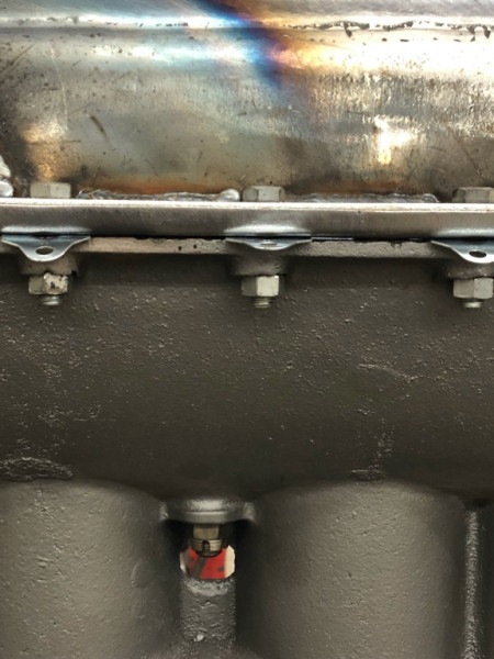

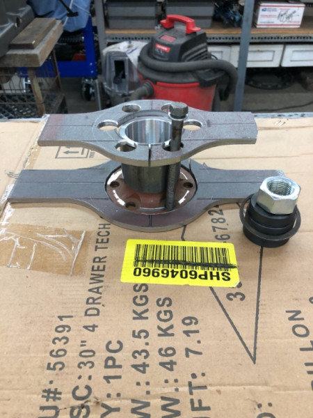

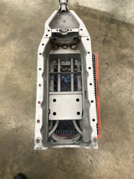

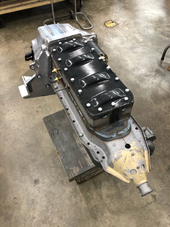

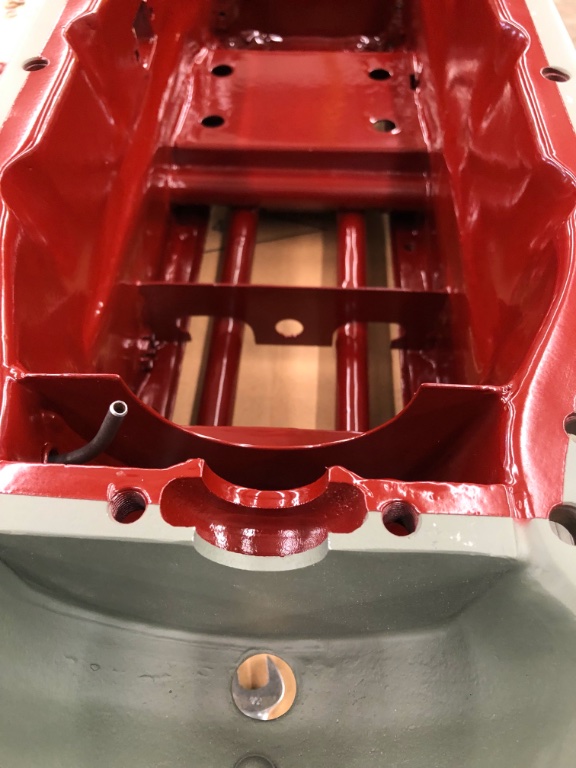

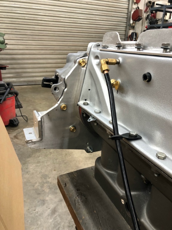

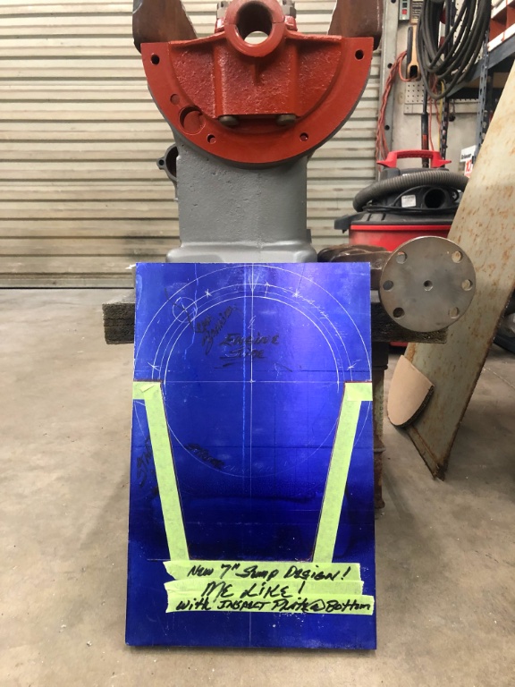

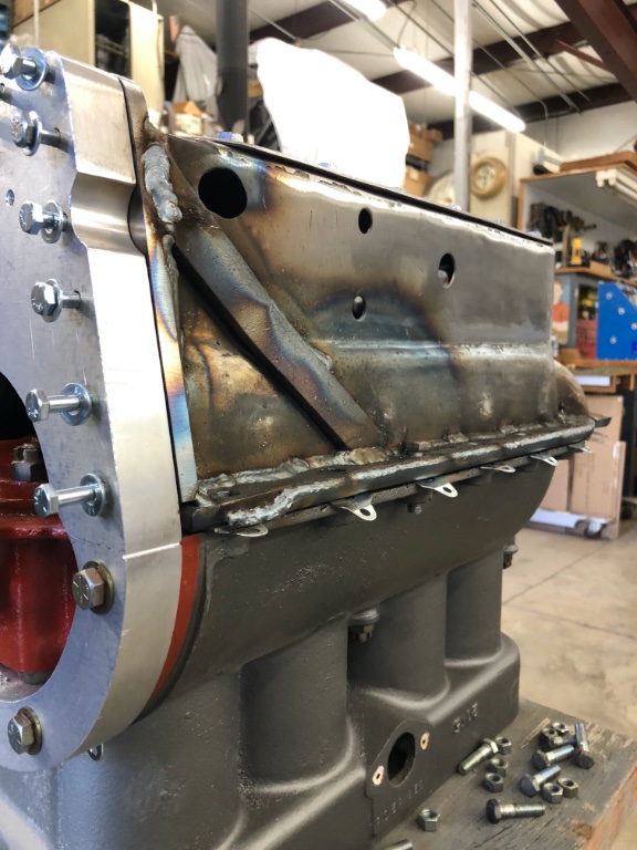

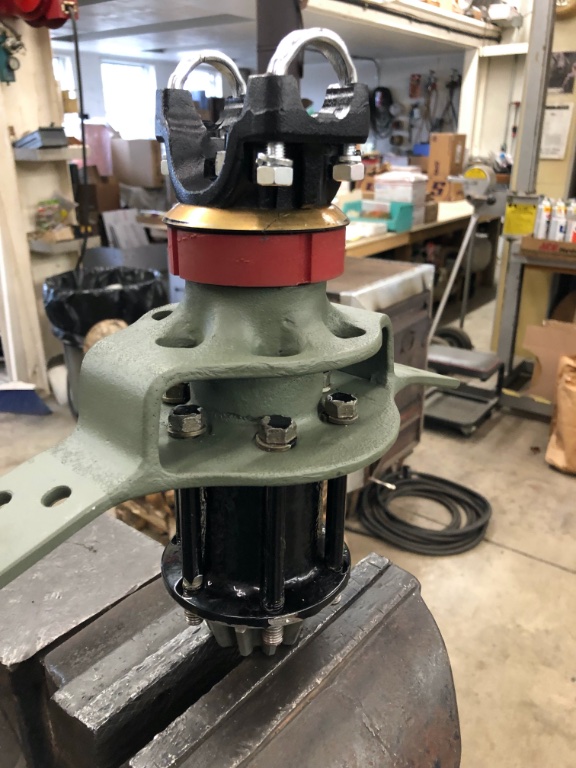

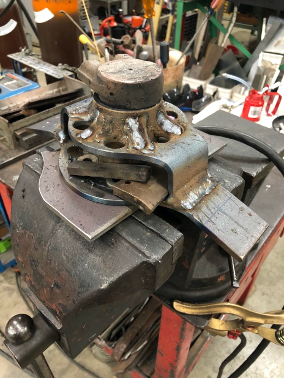

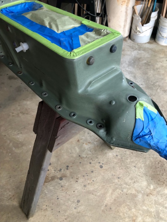

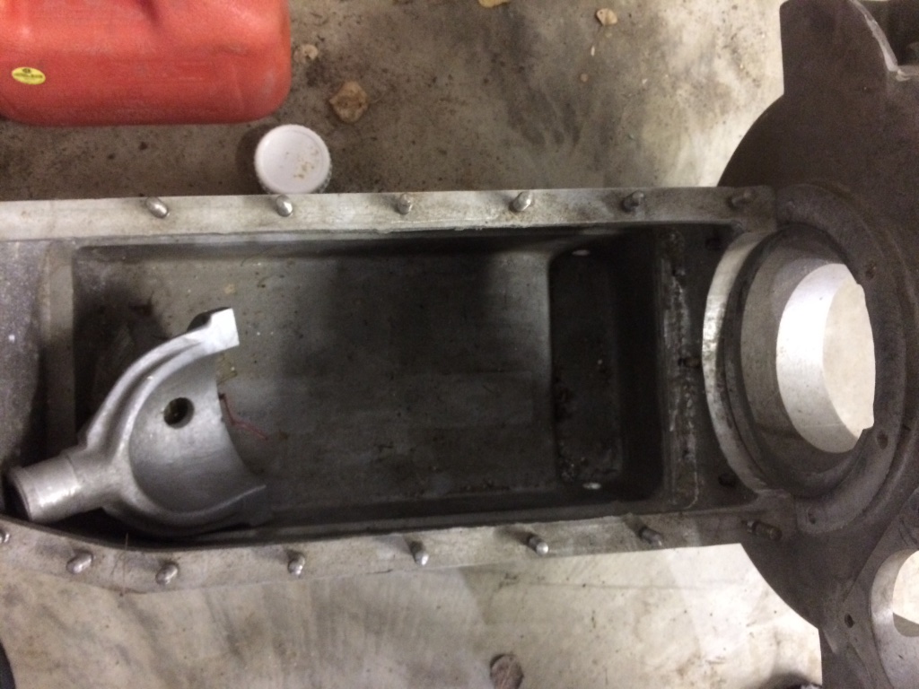

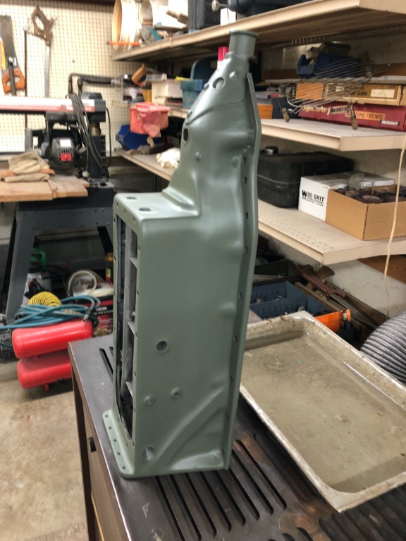

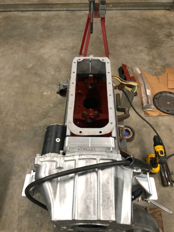

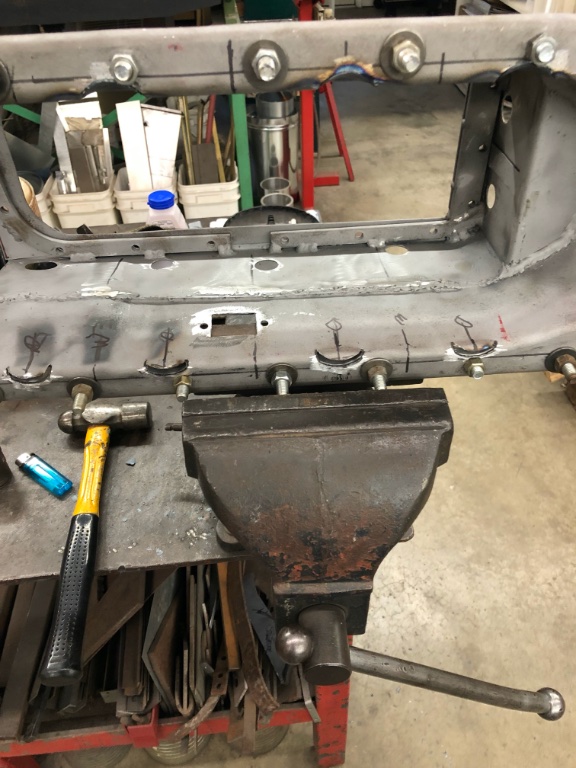

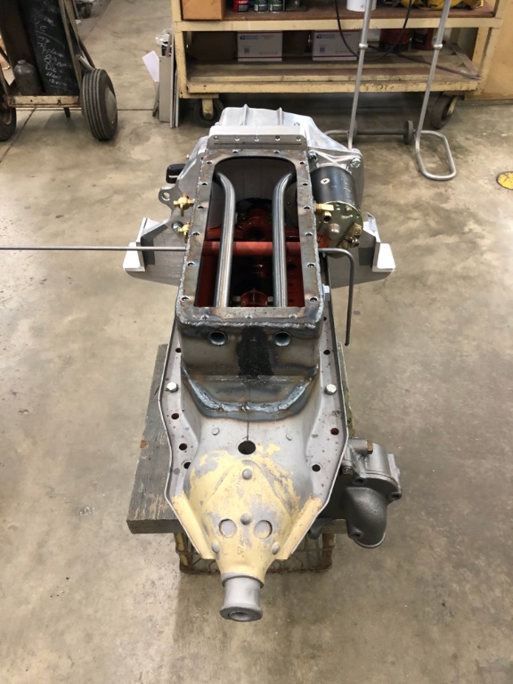

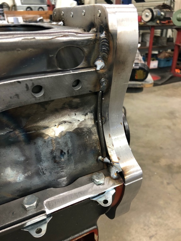

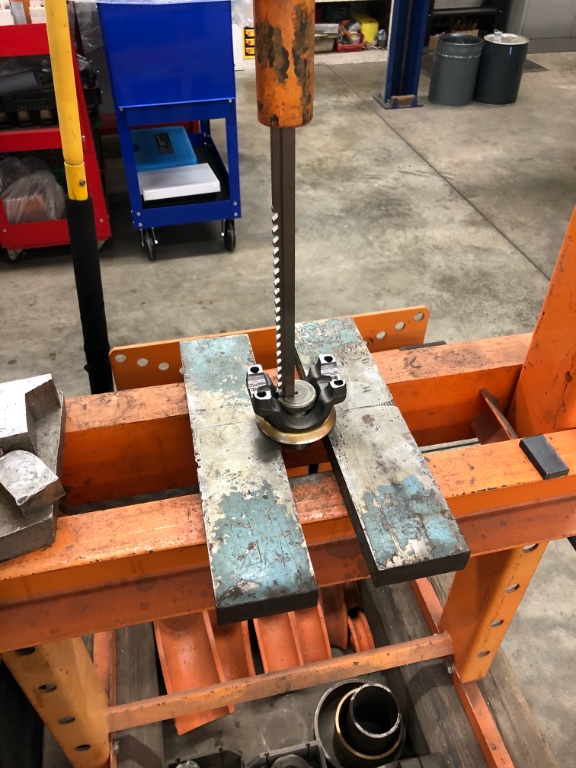

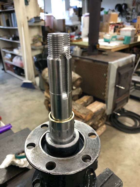

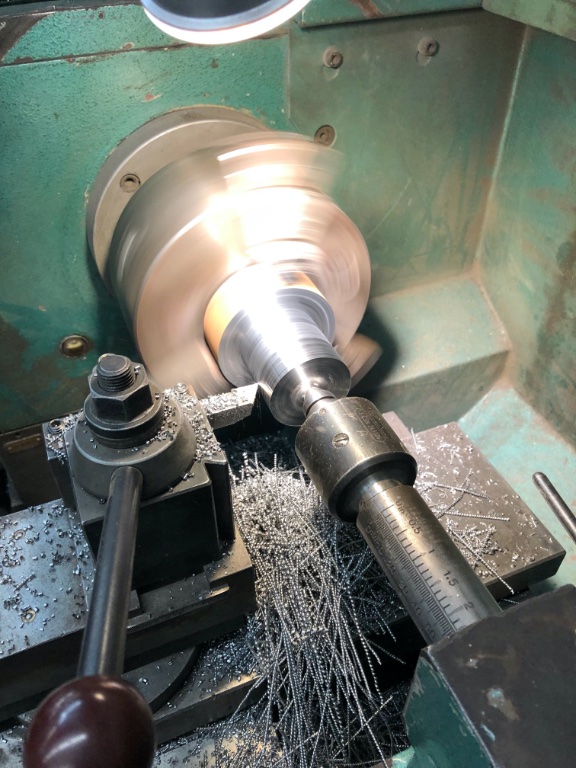

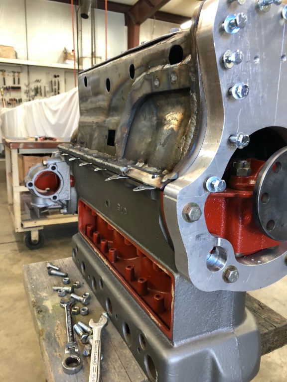

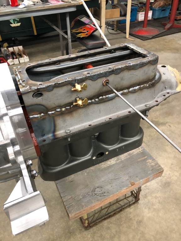

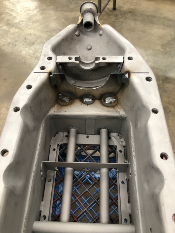

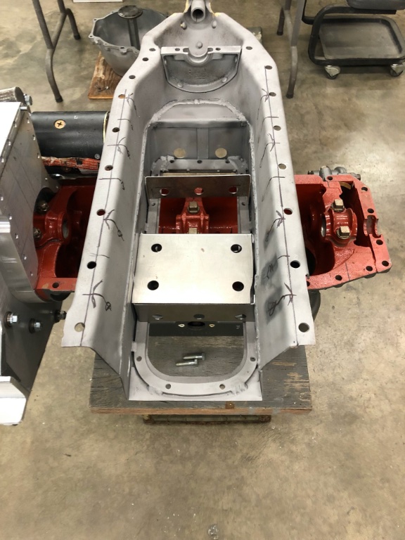

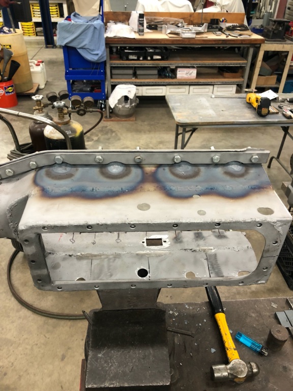

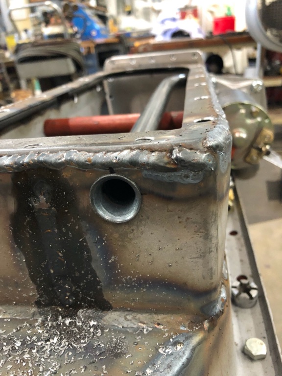

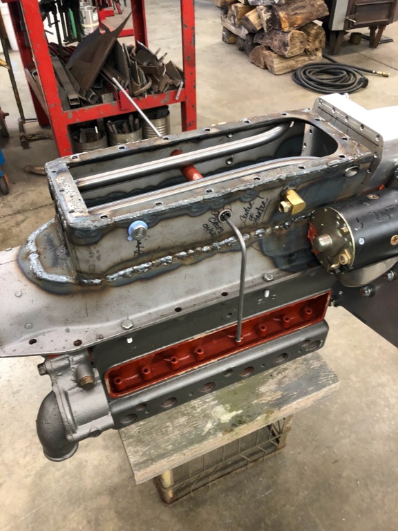

Well another super day at Frank's playhouse. Did a lot of calculating for this and that and welding. The welds look rough and are cold so to say to control any warping. I regrind them, then weld them smooth with a copper backing bar inside and out. When it is all done will look like cast aluminum after texture and paint is applied.
Installed a cross over tube (orange tubing) for the oil pressure line coming from the oil pump on the other side. Also two "Shotgun" style low air cooling tubes for the oil. These have worked great in the past, and keeps the oil about 20 degrees cooler while cruising. Still have baffles to fabricate and oil pick up...., waiting on some 3/8" plate for the back catch of the oil pan as this will hold torque as required. 8 hours spent in THERAPY!

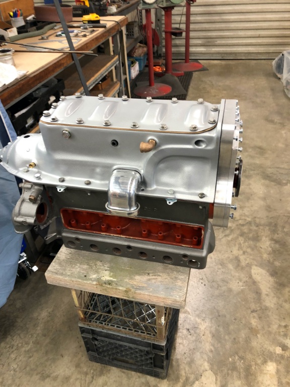

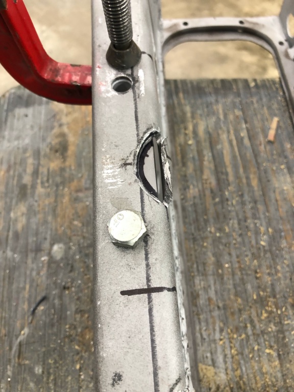

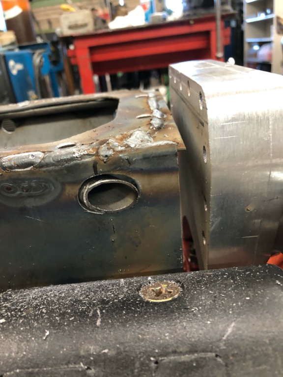

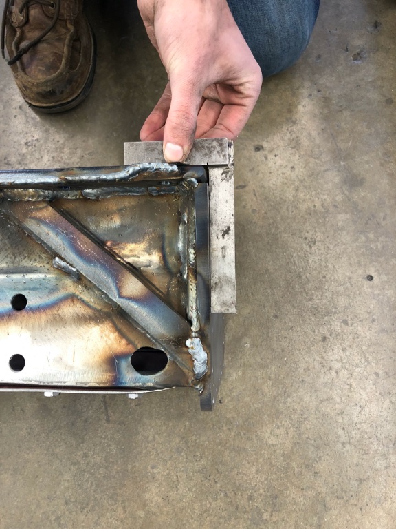

Post by Henry K. Lee » Mon Jan 24, 2022 6:54 pm

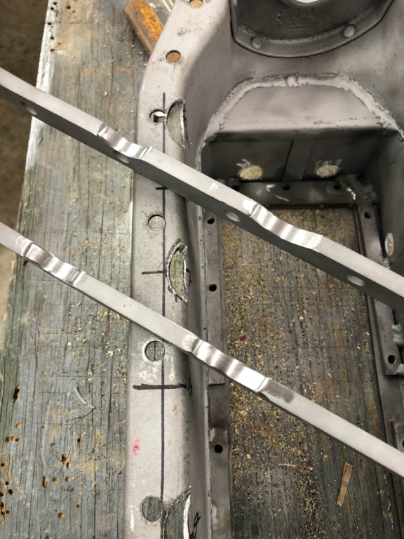

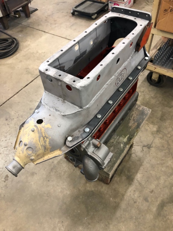

Inspection plate reused, just shorted 2 5/8" to compensate for the drag link clearance.

Post by Mike Howell » Mon Jan 24, 2022 7:40 pm
The oil cooler tubes are a neat concept! I'd like to add the idea to a project I'm working on if you don't mind, Hank.

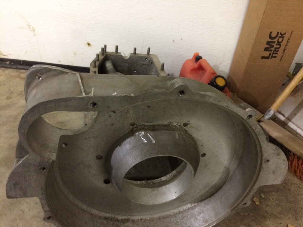

4 hours of play time today, but productive!
Setting and checking Crank Stroke Throws.
Baffling isn't it. Must have baffles in long oil pans or possible momentary pump starving (cavitation) could occur in hard braking, cornering, etc. In high constant speed engines running above 4,000 RPM's, a windage tray that profiles the crankshaft and rotating assembly is used to prevent oil striking hard into the sump which in turn causes air in the oil, causing really bad cavitation making an oil pump seize up.

Too cold outside to plant banana trees so back to the playhouse!

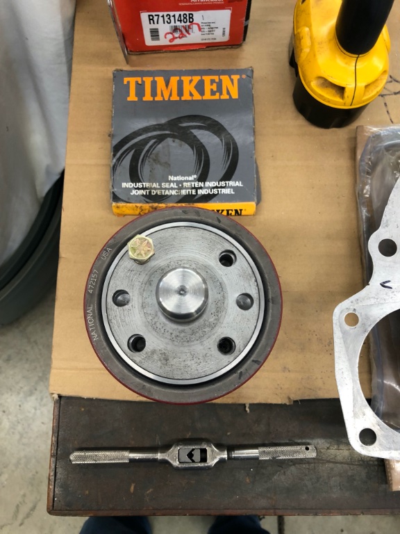

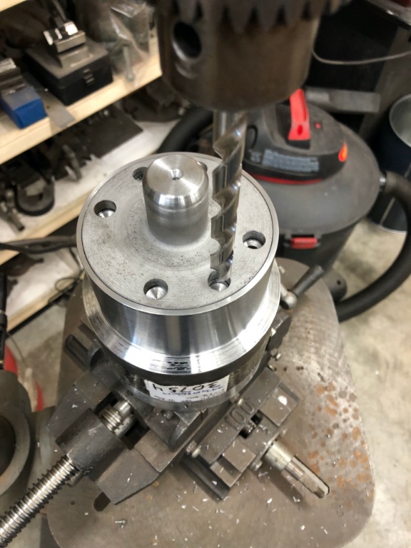

Reenforce may look extreme on the pan but controlling torque and letting the clutch take the hit is what I am doing. Using the plane on two halves are better than one theory.
Since the rear crankshaft flange adapter is 4 1/4", doing a two piece seal retainer housing. Over the top, but wanted it where no questions later, should have, would have. These housings are used in very high endurance, top fuel, Le Mans, aircraft, etc engines. Never had one leak. Pre-assembly done and everything is going as planned 8 hours later.

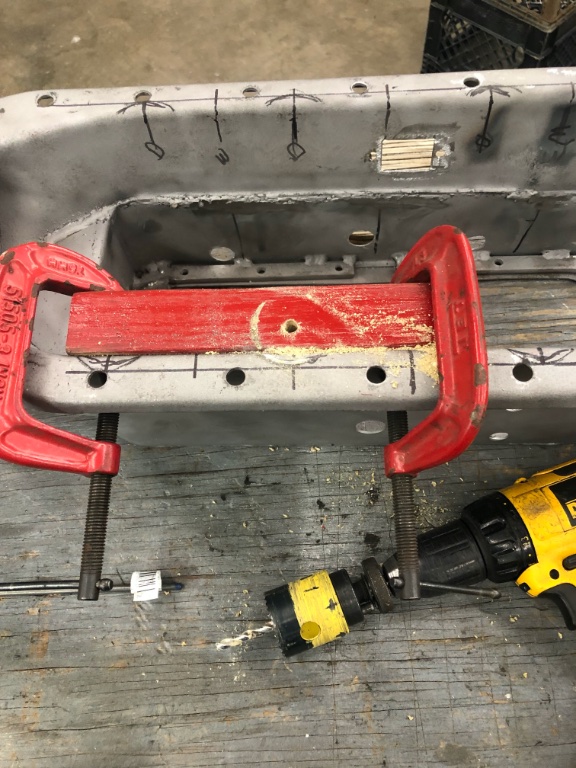

Post by Henry K. Lee » Thu Feb 03, 2022 4:43 pm

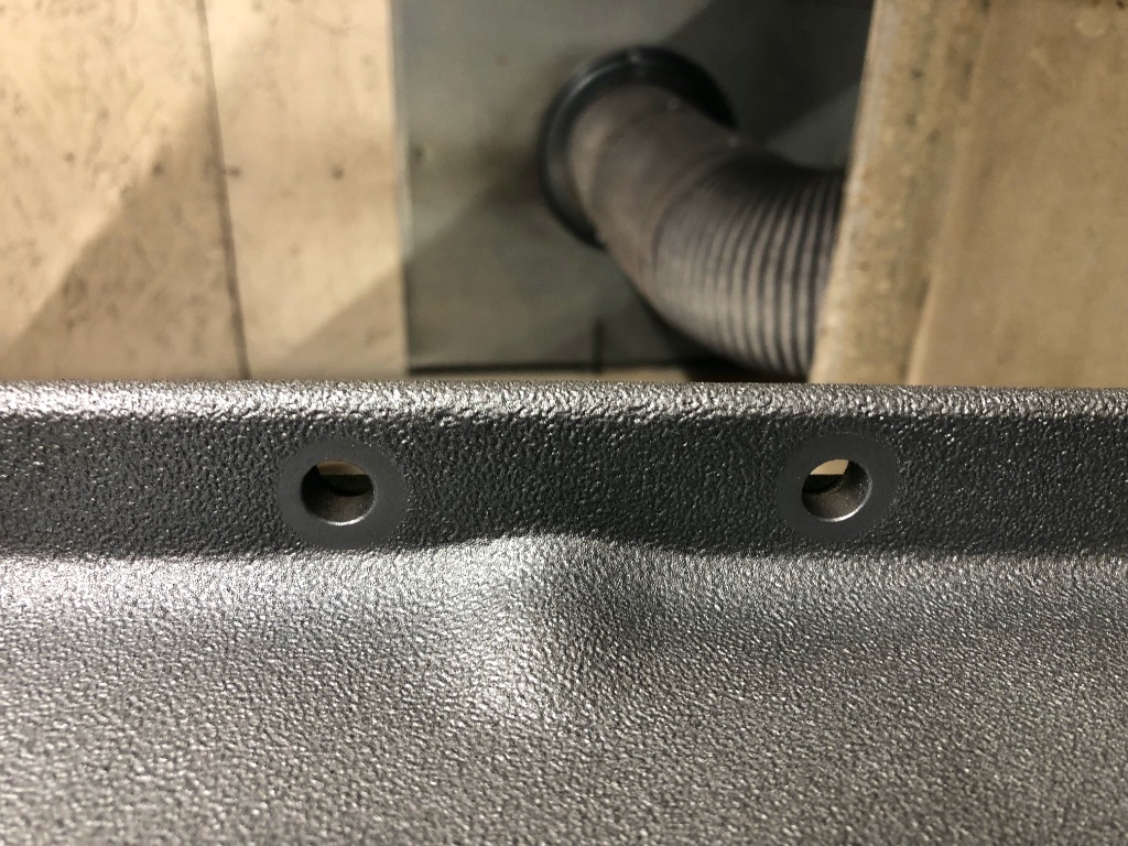

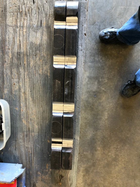

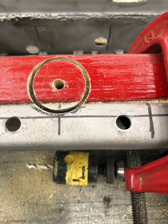

Another day of play so to say. Here are some simple methods for dimpling a pan for stroker clearances. I go a little more than needed as I more clearance is better in case something comes loose while in motion. Better to hear a rod knock than for it to strike the cases. Serious damage is a sure thing then.
Posts: 5598
First Name: Henry
Last Name: Lee
Location: South Pittsburg, TN
Post by Henry K. Lee » Thu Feb 03, 2022 4:54 pm

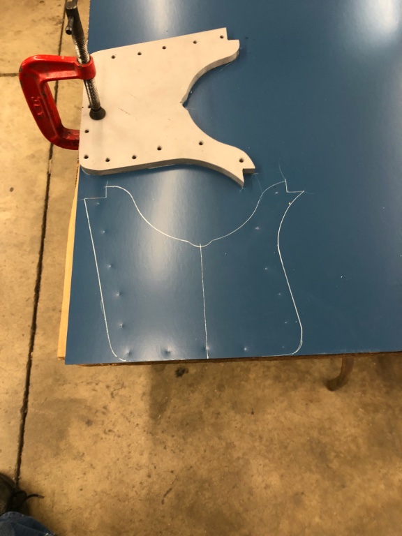

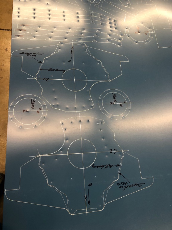

Heres you a good way to make and store prints/templates. Go to your nearest place that forms steel roofs, get a piece in blue or any other color (normally 41" width before extrusion), transfer your prototypes by scribing and transfer punches, drill holes and cut out edges. We use a place in Europe that photographs our templates with a precision scale square. It then automatically writes the program with only the program writer putting in hole sizes and threads.
Posts: 5598
First Name: Henry
Last Name: Lee

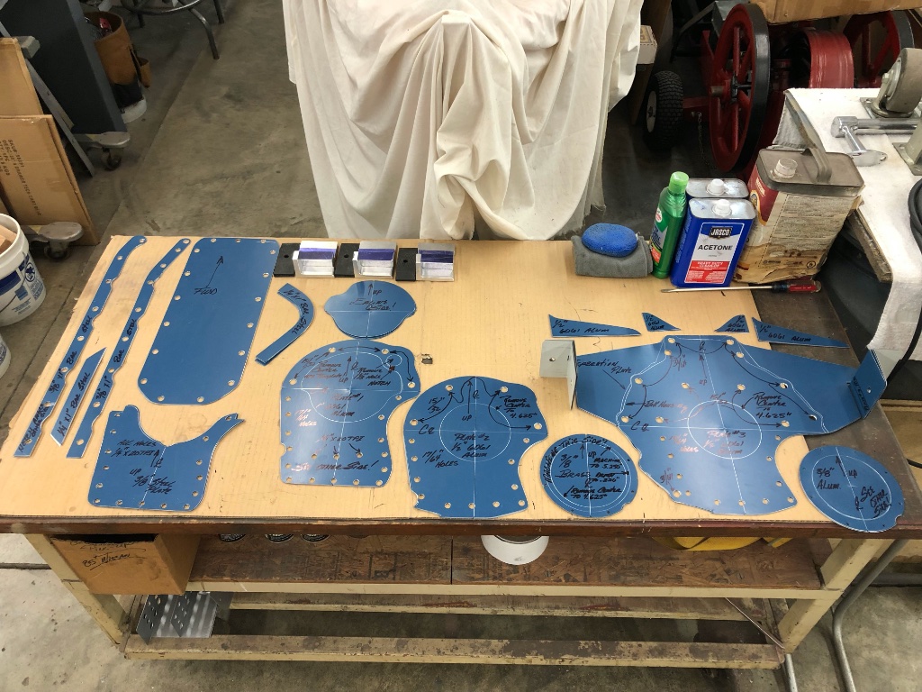

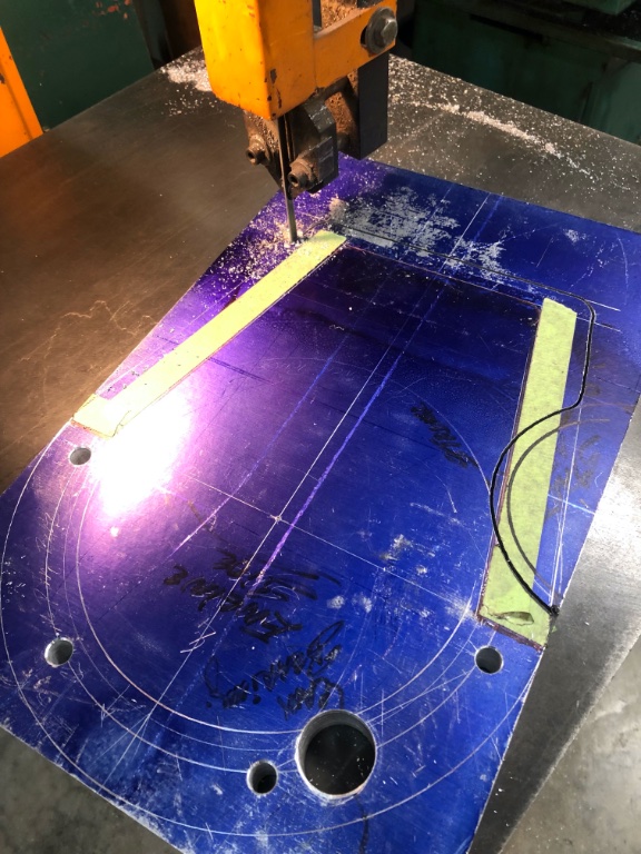

Post by Henry K. Lee » Fri Feb 04, 2022 8:59 pm
Busy day making master templates by transfer punch and scribe. Resting hands too after cutting. I am not going to make these templates or produce the adapter for sale, I am passing this on to two of our members and will let them release info as they see fit. No, I will not release their names out of respect.

A suggestion. Take those panels and get them scanned and then they can be saved to a USB key.

We use a company in Europe that does our other photo scan with a precision scale square for reference, then it is converted to a CNC program. I am not going to produce but I am passing on the torch as stated before. Just like to be organized and preserve for another day. The pattern I purchased from you a few years back inspired me to take this on.., Thanks! The larger bell housing plate (known as plate #3) and flywheel hub will be inner changeable to accommodate any other transmission as one sees fit to use.

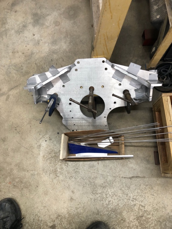

Long day of welding with plenty of cooling cycles. No warping.., PERIOD! Dead squared. Using round stock as a transition from thicker to thinner steel I was shown by an old boy in England. Really does a beautiful job. Used 1/32" shims to simulate the thickness of the gaskets. When I released the tension on all the bolts.. they all came out by hand after the metal was dead cold. A lot of sanding but worth it!

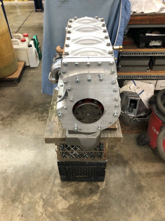

Post by Henry K. Lee » Tue Feb 08, 2022 7:06 pm

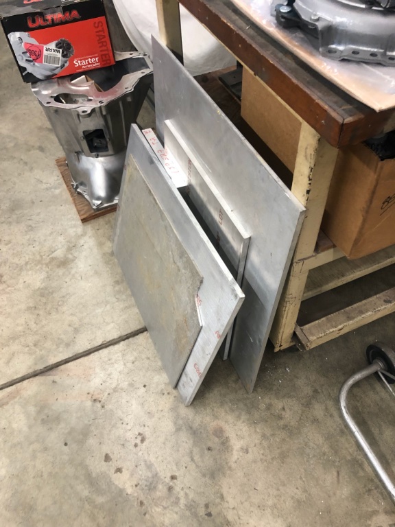

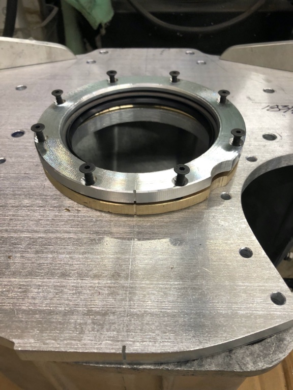

20 hours later, 3 sets of master templates finished. Now on to material/hardware list with findings and instructions.
Final fitting after bead blasting and installing bungs for oil system with baffles, etc.
Decided to install a holding sump in the front for the timing gear to keep them wet. Will have a sprayer on the side.
The aluminum plate is a little heavy for my TIG, so letting a friend install his magic on it.

Post by Henry K. Lee » Wed Feb 09, 2022 5:36 pm

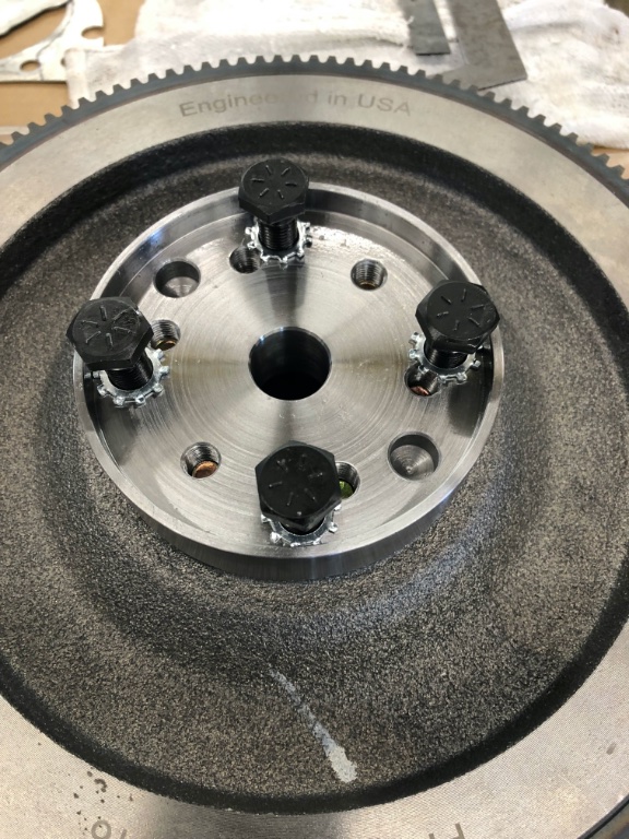

Did a pre-fit double check for clearance with the Skat crank. Needed a little more in the front for safety. Will blend in later. Modified the dimple bars for either Model A mod or Skat Stroker mod. Adapter fits nice and snug.

Post by Henry K. Lee » Wed Feb 09, 2022 7:11 pm
Thanks Dallas.., Just trying to pass on what life teaches us! Since the engine's weight is being support by the pan, and adding a mid section (bell housing), the pan needs extra to counter horse power/torque since it is not being supported by the block like later engines.

Post by Henry K. Lee » Mon Feb 14, 2022 8:55 pm
Well after about 3 hard days labor it is shaping in nicely. Weld, grind, do again. Then glaze over with epoxy and sand, sand, and sand. Worth it, now comes the texture coat , painting and coating the inside.
Tesla and others said it best..., "If you can imagine something whether in principle or art.., then gain knowledge and pursue"!

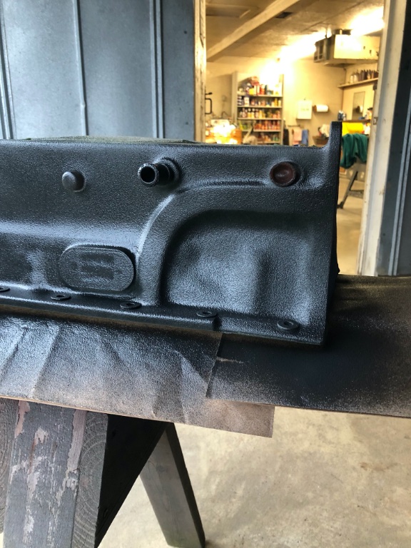

Post by Henry K. Lee » Wed Feb 16, 2022 7:43 pm

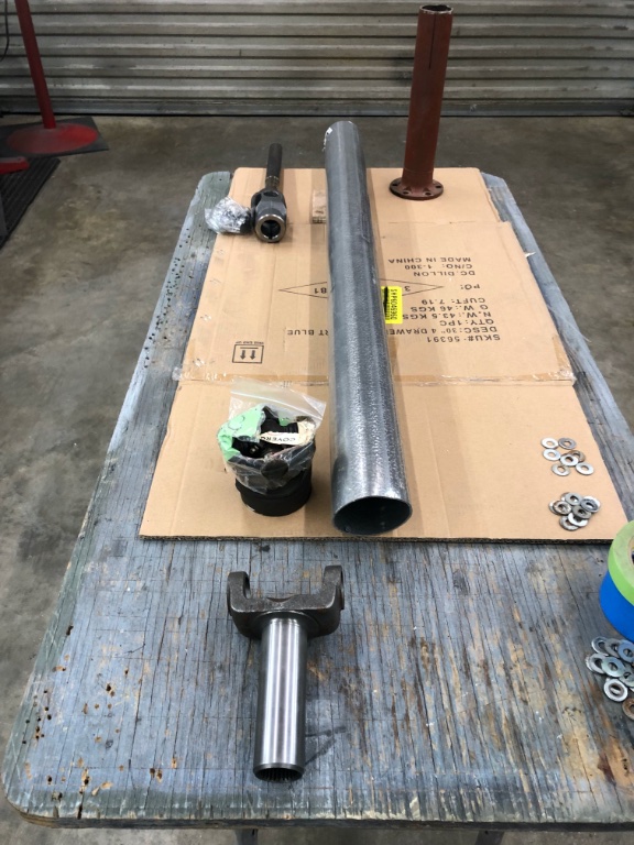

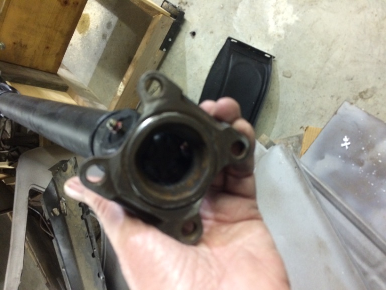

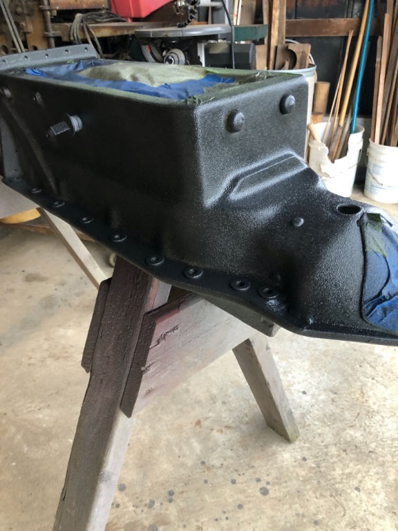

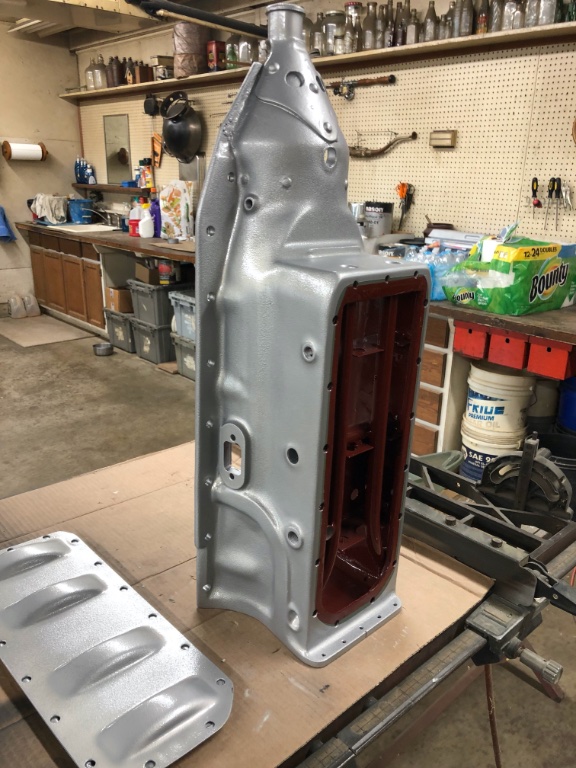

Clean. clean, and more cleaning! hand sanding inside, double wipe with acetone, then spray two heavy coats of Gyptal with acetone as a reducer. Never had a peel. Don't forget oil injection to the front timing gears.

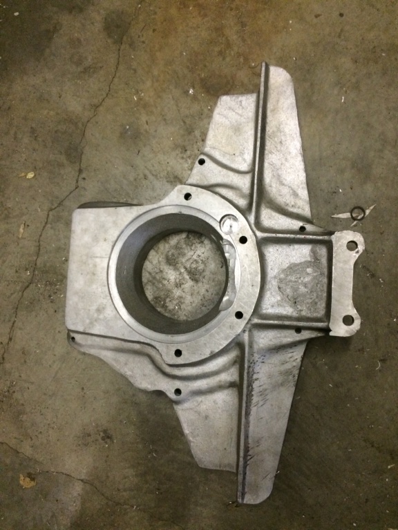

Starting the open driveshaft system using a conventional Model T rear end with mechanical brakes.

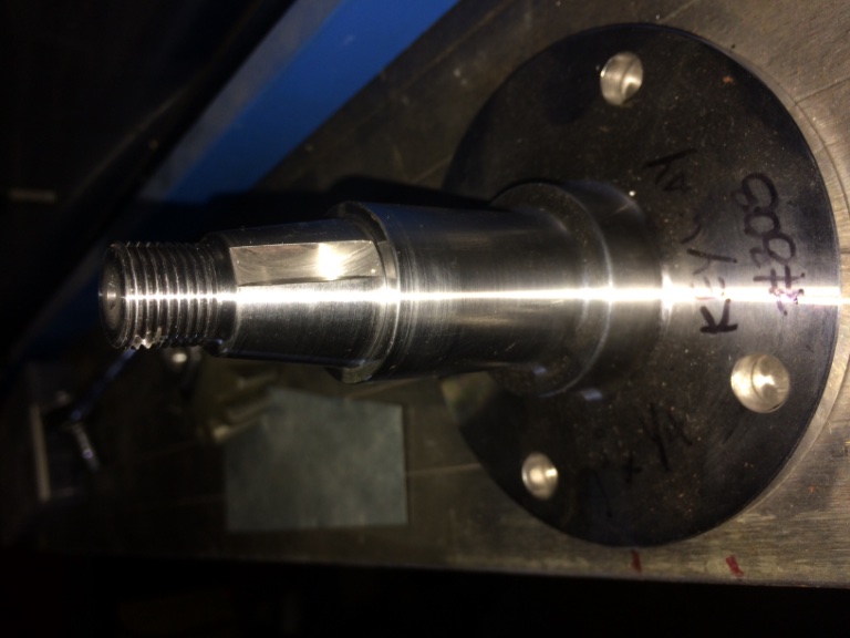

Post by Les Schubert » Thu Feb 17, 2022 2:27 pm

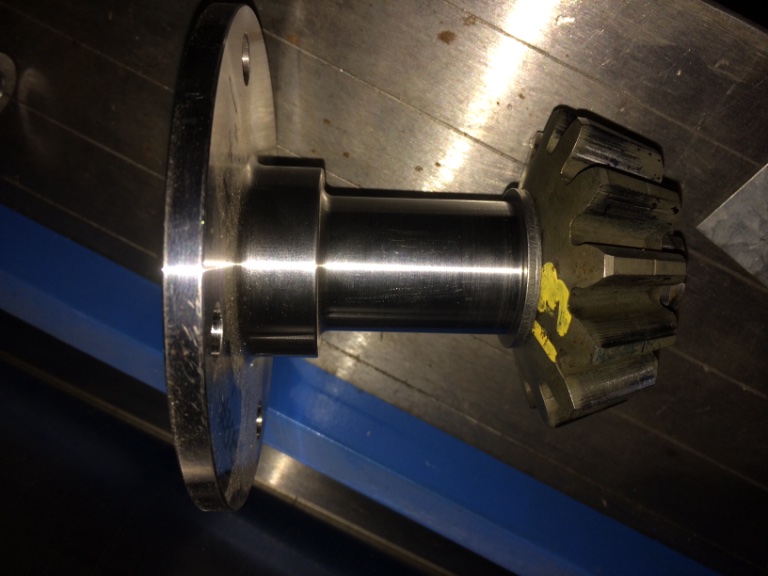

Hank
My version of the pinion shaft for a open drive shaft.
Posts: 5598
First Name: Henry
Last Name: Lee
Post by Henry K. Lee » Thu Feb 17, 2022 4:56 pm
Looks Great Les, Mine will be similar!!!!!
Posts: 5598
First Name: Henry
Last Name: Lee
Post by Henry K. Lee » Thu Feb 17, 2022 5:02 pm
Will after sanding and prep.., here comes the texture and paint!
Using old flat washers to prevent texture paint (Truck Bed Liner Spray) and plug off holes. Gives a machined after casting effect plus keeps your bolts after tightening from making a mess.
Posts: 5598
First Name: Henry
Last Name: Lee
Post by Henry K. Lee » Thu Feb 17, 2022 5:03 pm
TAH DAH!!!!!!

Post by Henry K. Lee » Sat Feb 19, 2022 8:47 pm

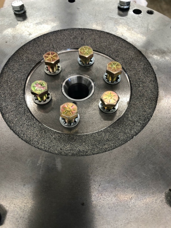

Well..., Perfect fit! I be Happy! On to the rear end mods for the open drive shaft system. Have to control torque, as one of my old professors used to say.., "it is your friend in power transmitting.., but a scorn woman from hell if not kept happy and in place"!

Posts: 5598
First Name: Henry
Last Name: Lee

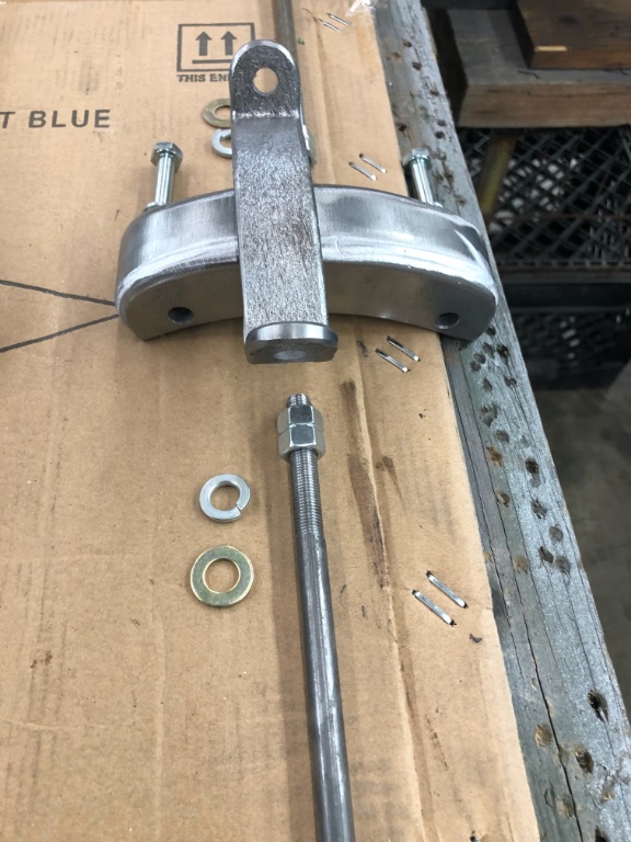

Post by Henry K. Lee » Wed Feb 23, 2022 6:46 am

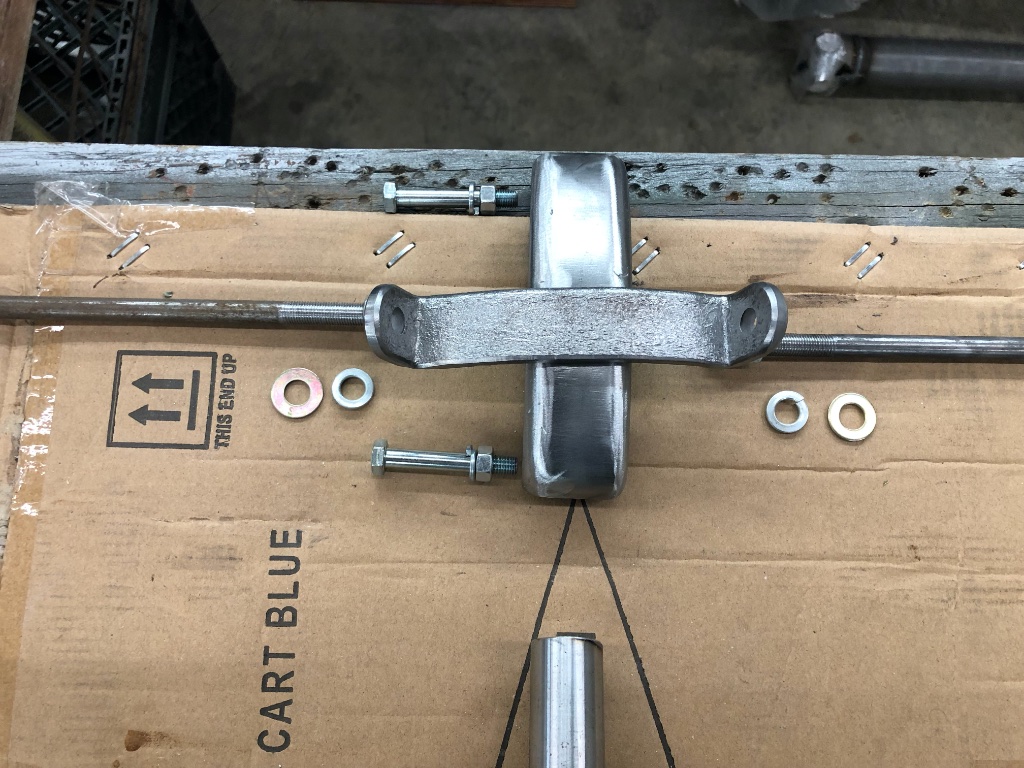

Thank You Steve! Here's more.

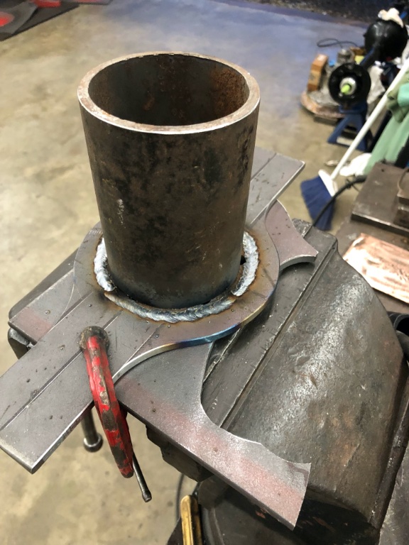

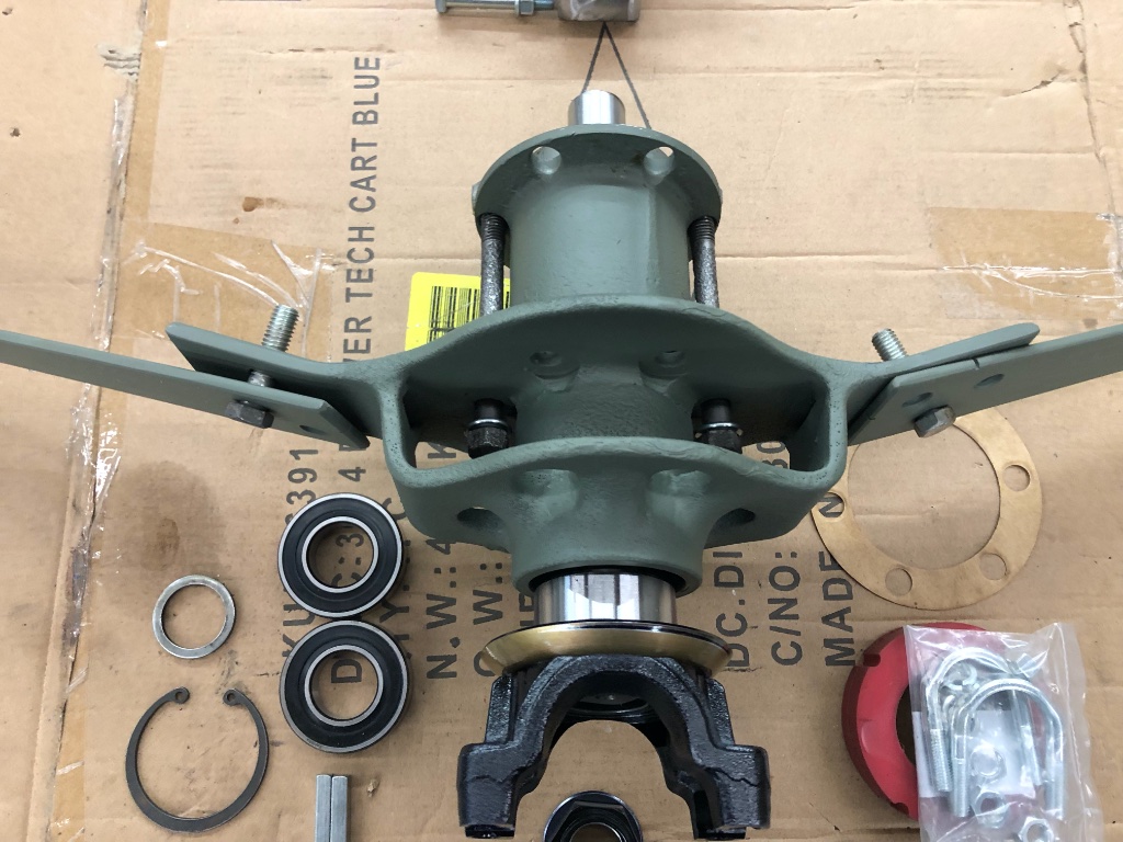

Going a little different from Les's mod. His is great, no doubt. I want to hold tight as I believe the weak link is in the casting of thin material in the housings, from torque tube/radius rod absorption to a "torque wing" retainer and back truss (holding closer to the source with a strong arm).
Using tubes and old flat washers will save you time in clean up from weld spatter, coming in hot on the welds.
Posts: 5598
First Name: Henry
Last Name: Lee
Post by Henry K. Lee » Wed Feb 23, 2022 6:58 am

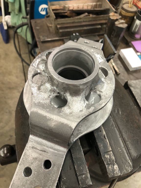

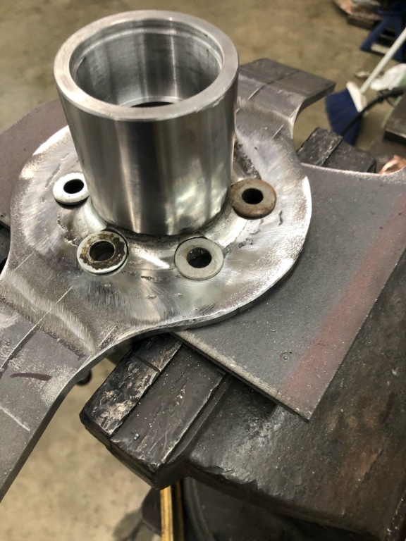

Now that the non accessible area is cleaned up, on to the next section. Welds are built up as I will shape into a casted effect of webs when finished. Looks like a shop class project went bad! LOL!
Bending plate steel 1/4" is made easy if you have a shop press, drill press V block, small piece of steel!
You will see why this support becomes important in my design later, catching/retaining torque. If there is a failure, in theory, no damage to the internal components (Safety Break Away)! Using a still available Winters Quick Change yoke modified with mild steel square keyways with a retaining nut. That front snout has two back to back roller bearings in front of a Fun Project adjustable preload pinion bearing. Stayed tune to this channel for more fun with Dr Frank N. Stein, aka..., Humbled Hank.
Pretty stuff coming soon!
Posts: 5598
First Name: Henry
Last Name: Lee
Post by Henry K. Lee » Wed Feb 23, 2022 9:16 pm

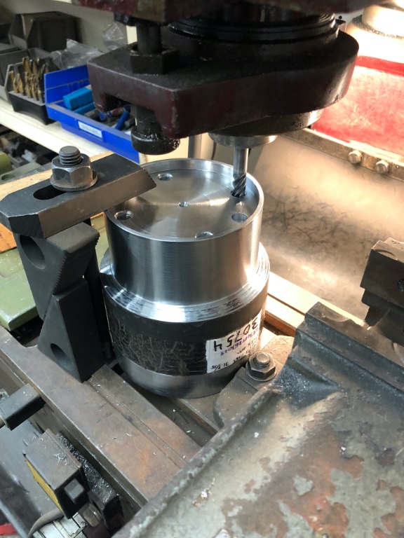

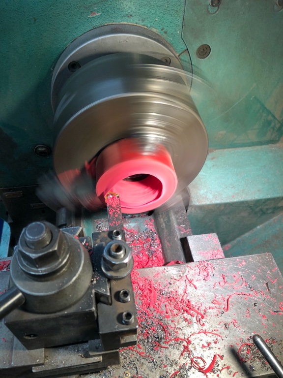

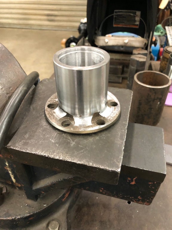

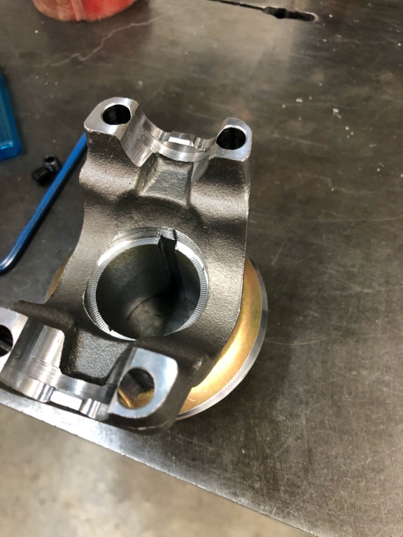

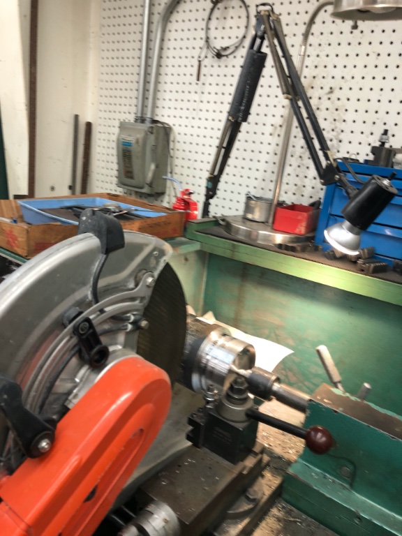

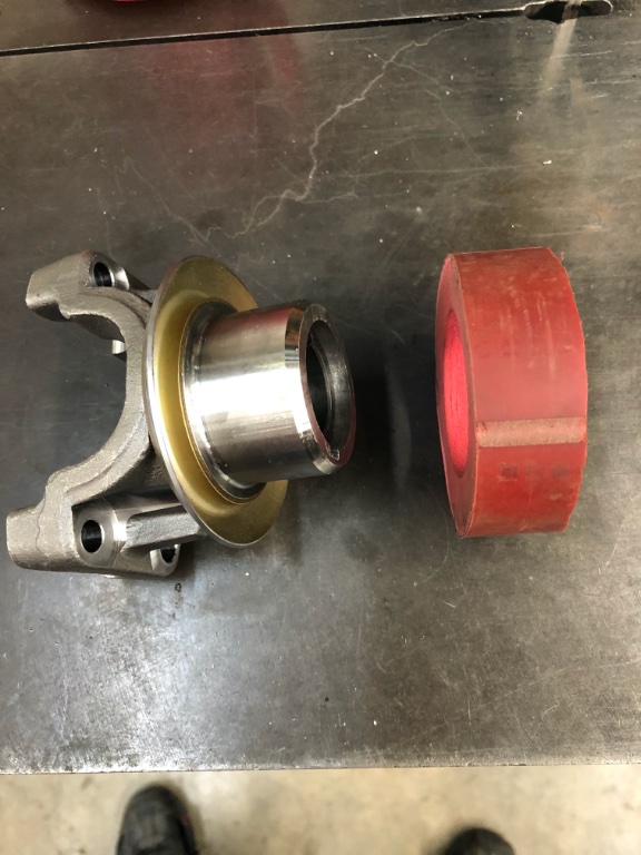

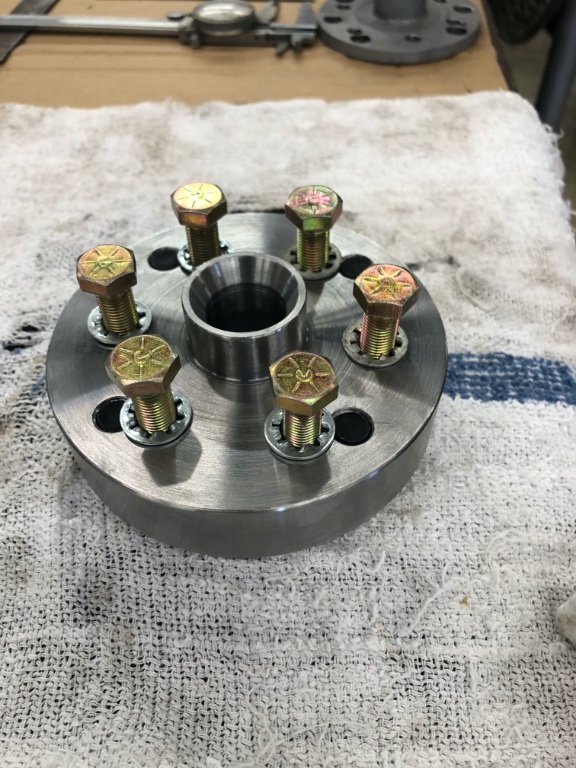

A good day in the playhouse. Machined and broached the yoke, machined polyurethane to fit behind the yoke as a harmonic silencer (straight cut gears love to resonate noise causing deep harmonics, creating metal fatigue). Grinding down the welds, etc.

OK..., Now you can get a better picture how this will work! Front torque arm/truss with a rear truss! They will tie into the rear link supports to be determined later.

Post by Henry K. Lee » Thu Apr 21, 2022 1:19 pm
Well..., After a few delays, ie, my welder not big enough, brother Rick Rice tried to, not big enough, found some really good young guys in Chattanooga that did me proud! And as a bonus.., the wife went to Florida for a week! Goof off time.., I meant playtime.
The plates dialed in on the money with the crankshaft..., could not be happier than that. Had to machine a dumbing shaft for the dialing but part of the fun. ENJOY!
Hank

Post by Henry K. Lee » Tue Apr 26, 2022 6:24 pm
Decided to press my good fairy luck on this project. Mounted the flywheel, bell housing, and starter then connect power to check flywheel run out..., within 0.0002! Holy Crap..., me happy!
