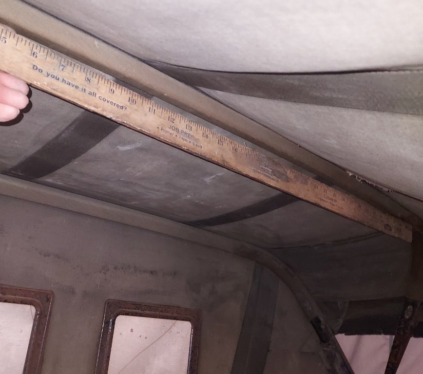

Are the top bows on a 1924 touring supposed to be flat or have a slight upward bow in the middle? The old ones are arched and the new ones purchased are flat. Just wondered which is correct?

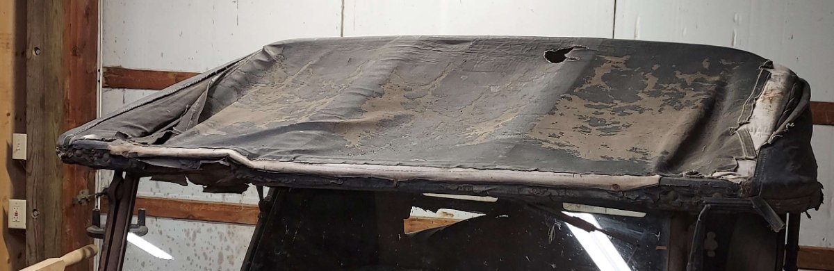

I thought it was flat, but checking my original 1924 runabout top, it has a slight curve.

That’s about the same as my old ones but the new ones are as flat as can be!

I would suggest throwing away the new flat ones and either reuse the old bows if sound, or make new ones that are correct. Many reproduction model T parts available today are made by reverse engineering or a best guess, and so some end up being just plain wrong. I have gone to the Benson Ford Research Center in Dearborn Michigan and made copies of the Ford factory drawings to make new wood for my 26 coupe. Sometimes a best guess isn't good enough. You have to ask yourself if 3/4" or so bow is necessary before you go to the time and expense of replacing the top on your car.
I have thought some beautifully restored cars had tops that didnt look quite right, almost a sunken appearance, and I must admit that until now I never really could put my finger on it. Now I know it is because the reproduction bows are flat.

Post by Humblej » Sun Jan 23, 2022 12:55 pm
John, I do not believe it is bending over time. The top material is not constrained along the sides of the top, only along the front and back of the top structure, therefore there is no side load applied to the bows from the top material. IF there was a shrinking force from the top material applied to the bows it would be along the top edge of the bows where the top is, and IF strong enough it would cause the bows to buckle away from the top material, not on the side of the top material, thereby causing the bows to sag, not crown. Looking at the condition of my original top, if there ever was a wrestling match between the bows and the top material, the top material would clearly loose, the material would stretch or split.
This is a bit of a tangential turn down a rabbit hole. Anyone with access to the Benson Ford can look this up, I will go again someday, but traveling to Dearborn is not in my immediate future.
These are the facts:
1 The question was asked by someone who has original crowned bows.
2 My original unrestored runabout top has crowned bows.
3 The repops are flat
With only those facts and without having seen the Ford factory drawings, I conclude they are crowned.
