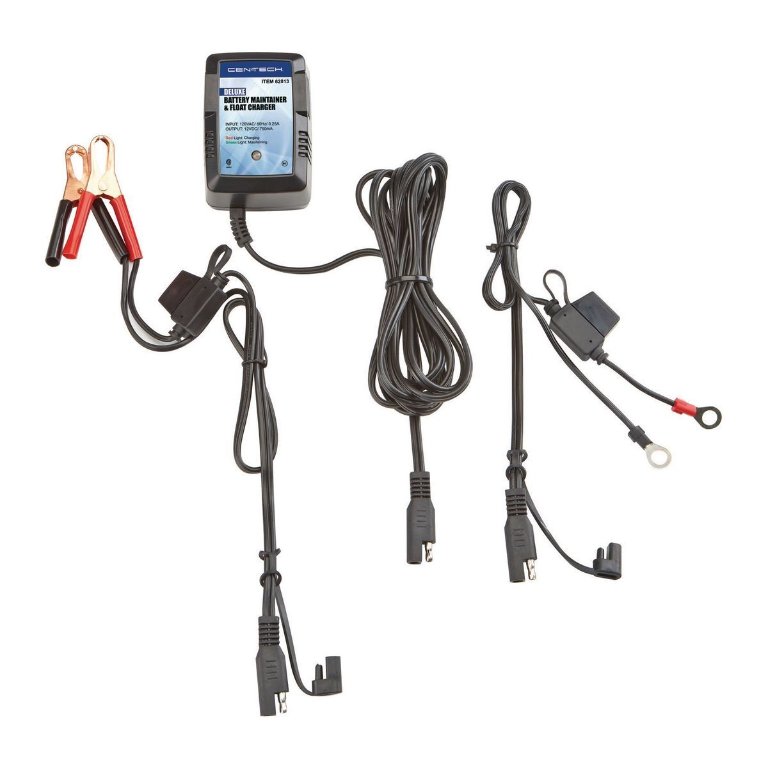

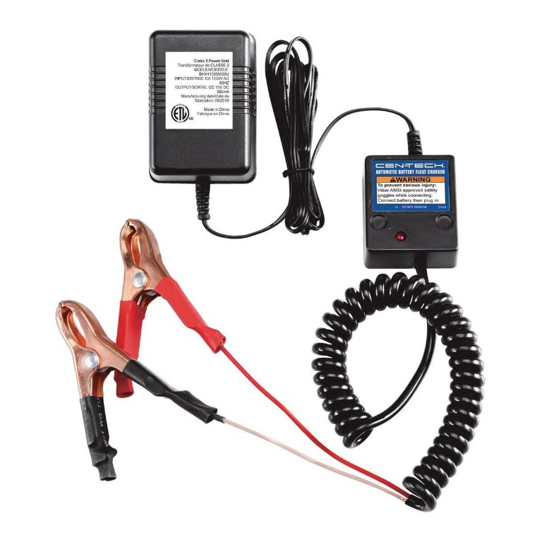

Re: Battery Maintenance
I use a harbor freight battery maintainer float charger to keep my 12 volt auto batteries from discharging during long periods of non use. 10 bucks or less on sale. They make my old car. moped and generator batteries last 2 to 3 times longer. They don't charge Your battery just keep a float voltage on it to counter self discharge in the battery. I wire the float charger directly to the battery using quick disconnect plug and socket so the only thing in the car when driving is the small plug You can hide under the floor boards or floor mat. Your 12 volt solar charger should work just fine charging a six volt battery without a voltage controller. put a 1156 12.8 volt auto bulb in series with the solar cell and the six volt battery and a blocking diode to keep battery from discharging through solar cell at night. solar charger will only be charging during daylight or about 40% of the time or much less on cloudy days so overcharging should not be a problem. photos show cheaper charger with only alligator clips. and deluxe model 20 bucks which is already set up for quick disconnect and battery connect options.

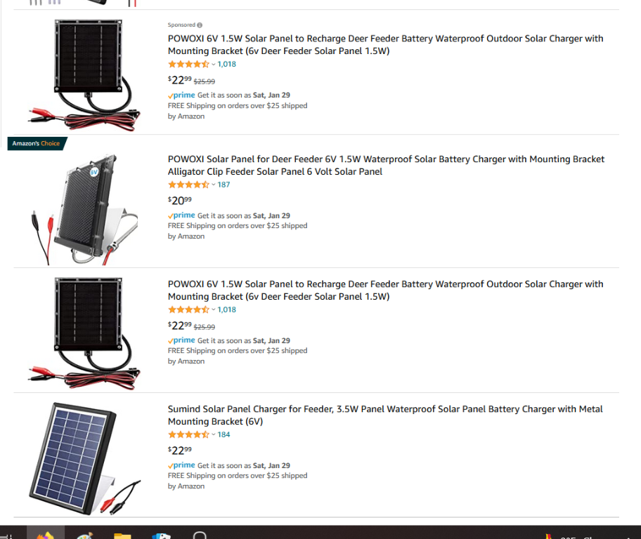

- Posts: 6541
Yes BUT not like a cut-out and adjustments need to be made.John Codman wrote: ↑Wed Jan 26, 2022 11:54 amAn excellent question. I don't know the answer, but if someone on this forum knows the answer for certain, I hope that he or she will enlighten us.speedytinc wrote: ↑Wed Jan 26, 2022 11:50 amExcuse my electrical ignorance, but wont a "12V" solar charger charge a 6V battery also without modification? Doesnt the battery, itself, regulate the amount of voltage it will take?
Like a diode cutout will charge any battery 6, 8, or 12V?.
Do I need to do some experimenting to confirm?
The main purpose of a cut-out is to prevent running the generator as a motor when the engine is shut-off. Its secondary purpose is to connect to the battery when its voltage threshold setting is reached (example 7v for 6v) to charge the battery without being able to regulate when enough is enough (that's what a voltage regulator does).
Trying to keep it simple: A 12 volt charger/maintainer would over heat a 6v battery at some point in time and then explode. No point in describing the work around, in case you miss a step. Many of Today's chargers and maintainers have circuity to prevent over charging a battery (reverse current etc) and are designed for the respective battery voltage size and to recognize when enough is enough, so they also have voltage regulation matching their advertised voltage.
