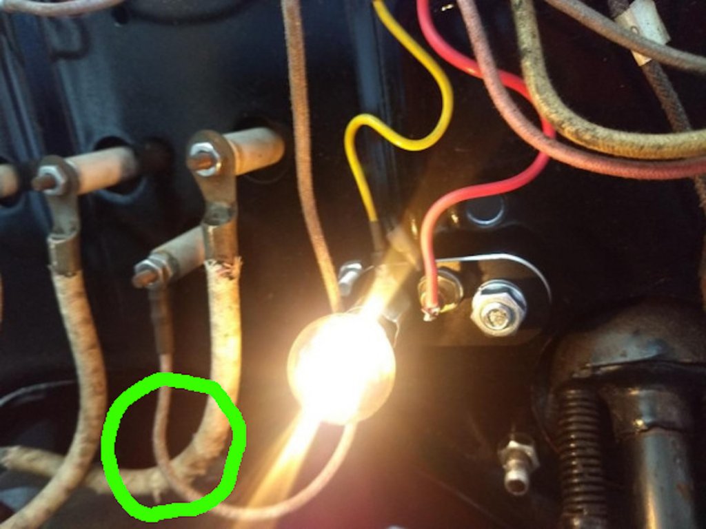

Does it matter if the diode is before or after the the 1156 bulb? I made mine magneto, bulb, diode, then battery. Searching old threads it’s say magneto, diode, bulb, then battery.
http://www.mtfca.com/discus/messages/411944/494541.jpg
Been running it a year that way. No I’ll effects that I can tell.

The bulb and the diode are in series so that part doesn't matter but you MUST make sure the diode is correctly installed since the cathode end (striped "banded" end) must point to the battery positive connection. The anode end of that diode must be pointed at the magneto connection. If you want to see a simpler version of this same device, I make them up with a printed circuit board and all parts mounted such that you only have to slip the thing onto the 2 ends of the coil box connections at the bottom. These are the Magneto (MAG) and Battery (BAT) connections that are the bottom 2 connections of the 10 connections on the engine side of the coil box. I will attempt to attach a picture of the device all built and ready to install. You can put it on or take it off in a few minutes with no wiring alterations other than removing the outer thumb nut on each side, then slide the Printed Wiring Board in place and reinstall the thumb nuts. If there is no picture posted here then send me an email or PM and I will send you a picture of the device.

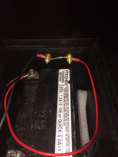

I have a 12 volt motorcycle battery install for my head lights and for hand crank starting. I only have to put in on the battery tender if it’s a long night drive. I am using LED bulbs.

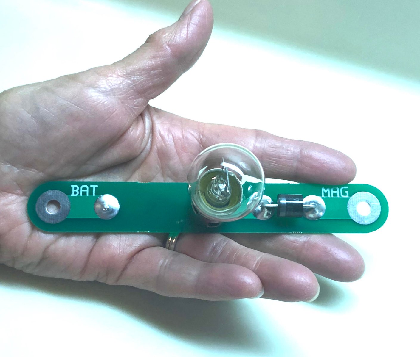

What a lot of folks don't seem to understand is that the light bulb acts as a current limiter to prevent the charging current from getting large enough to overcharge a small battery or large enough to pull the magneto down so the car won't run on magneto. This device was written up many years ago in the MTFCA elecrical manual and it is essentially a copy of the way the phone company used to limit the current to a given phone that was powered through the phone line. They put bulbs in series at the central office and those bulbs would light up bright if there was a short on the line but otherwise simply limited the amount of current that was available to the consumer's telephone. Telephones operated on very large 48 volt storage batteries and for many years they were essentially just a larger version of the batteries that were being used in our cars. Those batteries typically last for more than 20 years unless there was some major calamity that drained them completely.
The typical cell phone has a small voltage battery in it that is often about 3V or so. It is charged from a 5V source in the USB which is a regulated drop from the cars 12V supply. That makes it all battery derived.
The small charger I pictured above uses a lamp as a current limiter and a single diode to provide some charging current to the 6V or 12V battery that the car might have in it. If you rarely drive at night this charger will charge your battery with a small current that is there the whole time the motor is running. I have had them on my brass cars and never had a battery go bad using only this small charger to put back the current taken from the battery by a motor that is in very good tune and fires right up on the first spin. Full wave will increase the efficiency but it really doesn't make enough MORE power that you might need to keep up with headlights and tail lights. LED's will reduce the needed charge amount but the starter will need that larger reserve of a full size battery. This small charger does not need any switch or fuse because the bulb serves as a fuse and the diode is super heavy duty for the amount of current taken.

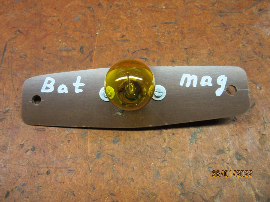

Can you buy that little green strip all made up or do you have to make your own?
BE_ZERO_BE
- Posts: 663
- First Name: BOB
- Last Name: CASCISA
- Location: POULSBO, WA
Re: Magneto battery charger
Contact John Regan for that item.
Respectfully Submitted,
Be_Zero_Be
Be_Zero_Be
- Posts: 6592
The green strip is just a piece of circuit board. Most anything that provides electric insulation will work, like a wire junction box which also provides an enclosure and mounting --
- Posts: 5274
Homemade. Nothing fancy. Simple & functional.

Yup, all that's needed. Good picture of how to wire as well!speedytinc wrote: ↑Thu Jan 27, 2022 6:17 pmHomemade. Nothing fancy. Simple & functional. diode reg 3thumbnail.jpegdiode reg1thumbnail.jpeg

To Day , I made this Thanks to John Regan .
Toon
Toon
Magneto to 1156 bulb in oil light
Bulb to Diode in battery box
