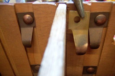

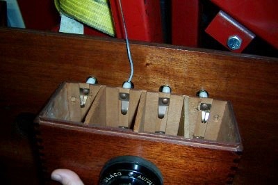

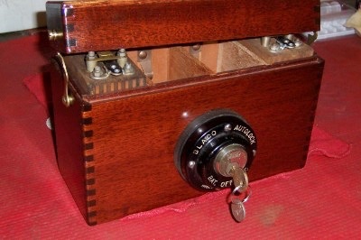

Years ago got a repro box at swap, and made it work for the later coils, just had to replace the outer contacts with the original offset style, so the coils would line up.
Believe the lower strip was anchored with flat head wood screws into the base of the box, as nothing was showing underneath the box. The dividers were removable, but the later coils fit fine. Ohly had to add brackets for mounting and latch hooks to secure the wood lid.
The switch was included on the repro box, it was a later lock type, but liked the round shape as it looked from a distance like a round Kingston or Heinze.
That switch was already wired up

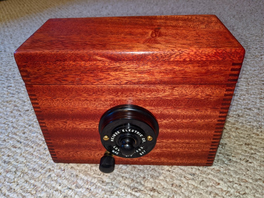

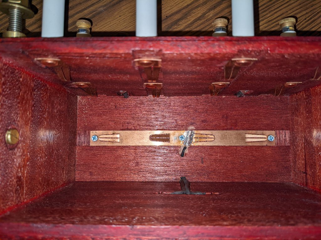

I had the same question about a month ago when I was building up my Heinze coil box made to fit later KW coils. There was no way my rivet puller was going to work, so I used three countersunk #6 screws as shown in the picture below. The screw heads are about as flush as a pulled pop rivet would be. The coil box is the first thing I've gotten finished so far on my 11 touring restoration project.

Neal thanks! What kind of sin did you us on your coil box? That looks great!

I used Laurel Mountain Forge Cherry stain that I bought from Track of the Wolf. Prior postings on the forum site said that this is the closest stain that matches the original stain used on the firewalls when T's were made.
