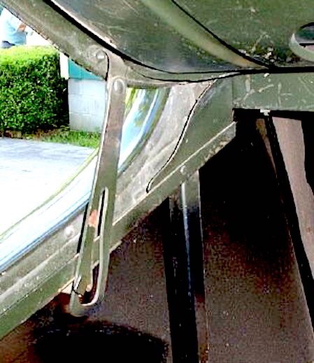

- Posts: 4089
Re: Deck Lid Support Arm Metal Gauge
Took this photo of another's '27 Coupe, close up of that deck support. May help your construction.
