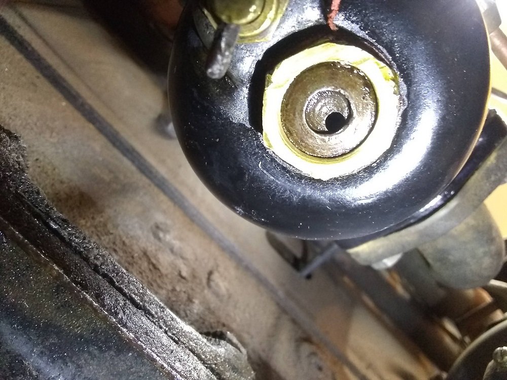

I’ve included the photo below to illustrate a couple things. The painted body shows the fuel vent hole next to the brass model plate. If fuel is coming out of that vent hole then gas is not being shut off by the float or needle valve that the float closes. From your original post, it appears you do not have a Gross Jet style valve, shown in the middle of the photo. The gross jet has a reputation of sticking open, causing fuel to overflow.
Another reason for over flow is if your float adjustment is not quite right. I find it takes me a couple tries to get it right. On one occasion I found a glob of Permatex on the float which kept it from rising.
If the fuel is not leaking out of the vent, but still dripping, you might have a leaky gasket or seal around the bowl.
Another area that might leak is shown in the photo of the unpainted body. There is a hairline crack on the inlet that the fuel line connects to. This can happen if the brass elbow is overly tightened. It’s recommended to use sealant rather than over tighten to get it to line up.

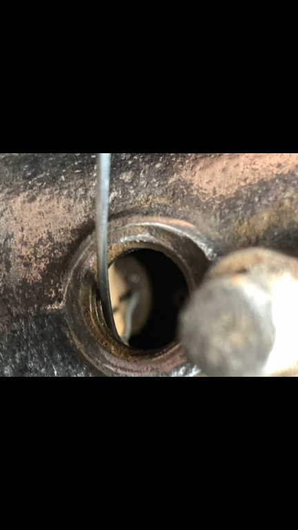

Thanks for the details and photos. Correct, the carb doesn't have a Gross Jet valve. Here's the interesting thing, which might just be my ignorance of how the L4 works, but the fuel is not coming from the hole above the bowl adjacent the air-valve shaft. It's coming out of the hole in the body where the bowl nut fastens. I've confirmed that the fuel is not seeping out from the nut threads but is actually coming out of the pictured hole even to where it makes air bubbles. It only comes out of this area when the fuel petcock is turned on and the engine is off and when I try to start the engine but can't. Your thoughts?

That hole is in fact the overflow tube for the bowl, when the fuel level is not being shut off fully by the float valve, or the float level is terribly maladjusted.
Odds are strong that your float valve is failing (very common) or your float is leaky and is not buoyant enough (not as common as people would have you believe)
