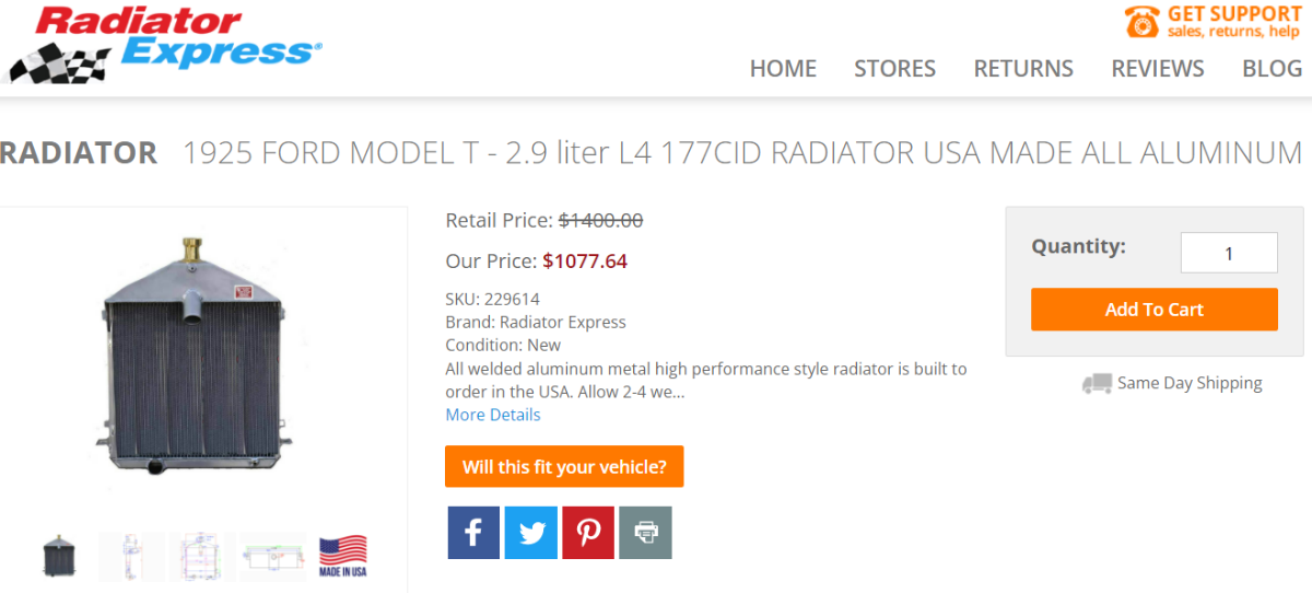

Re: Who is making good early T radiators now?
Not the early radiators, but apparently, Radiator Express makes a version of the "black radiator" style. From what I can see, they look terrible and are expensive. Interesting though!
https://www.radiatorexpress.com/product ... 14/1485417

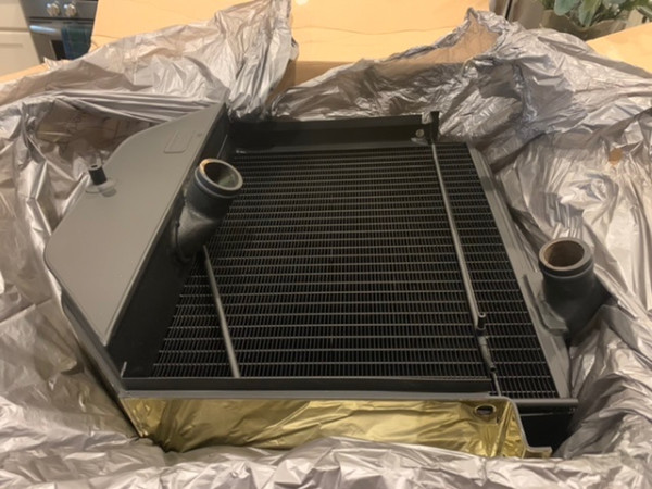

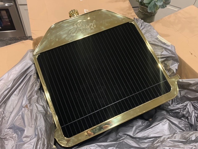

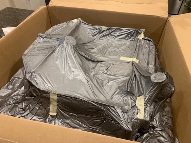

Some of the best money spent on any Model T is for a new radiator.
I have 3 T’s and all of them have a Brassworks radiator. They look great and cool great. No complaints from me. I don’t have any experience with a Berg’s radiator. I have only heard good things about them and have taken a look at them at their booth at Hershey and their quality looks just as good as Brassworks.
When you open the box for the first time for a new brass radiator you will understand the cost. They are a work of art!

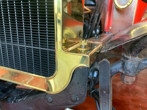

I have owned several brassworks radiators over the last 20 or so years. Never had a problem, though I Have seen a few radiators fail because they were not attached properly with the correct mounting hardware, either too tight or no spring or leather pad, and they had no ability to flex with the frame movement.

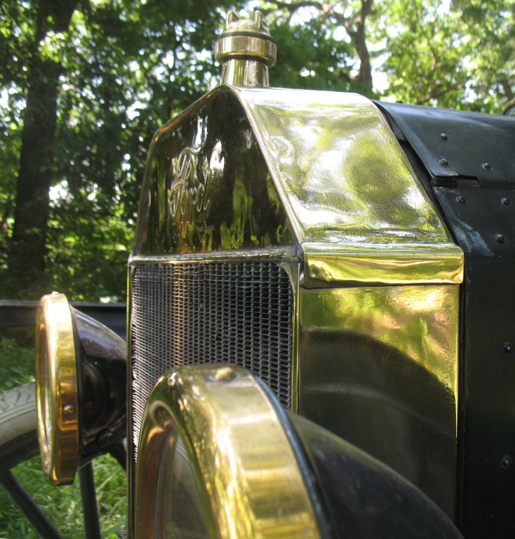

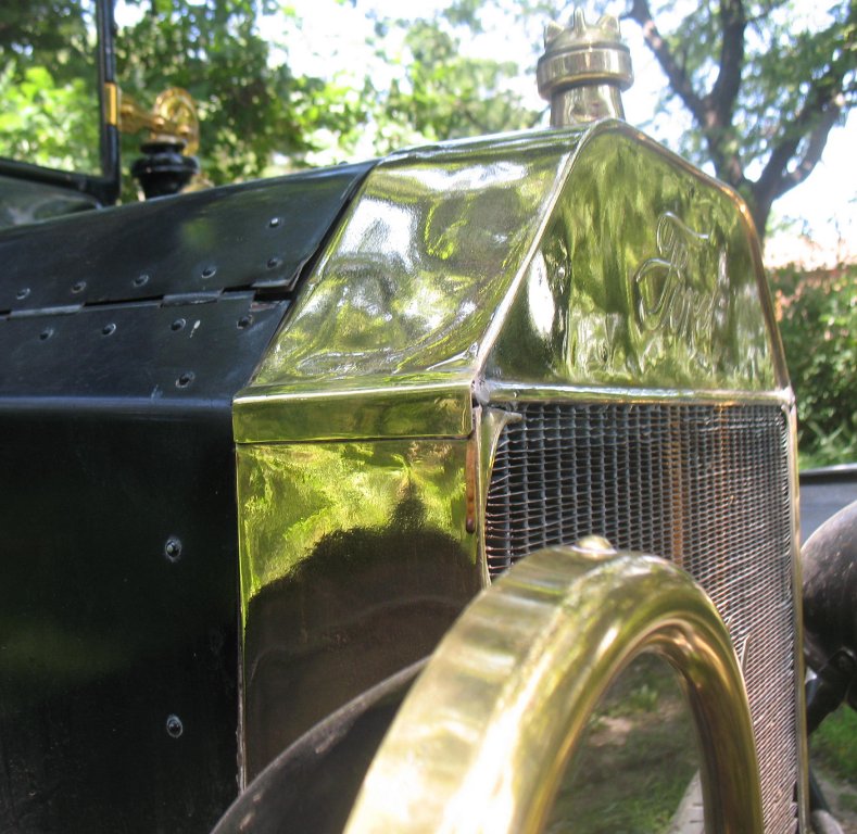

This has nothing to do with new radiators, but may be useful in deciding whether to repair or replace. Even an original radiator can crack and leak along the top side seams, as my 1915 did.
That can be fixed with a reinforcing brass patch. The cognoscenti will recognize this as a repair, of course, but most people won't know the difference. On a 100+-year-old driver I prefer the repaired original appearance over the new.
