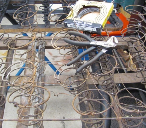

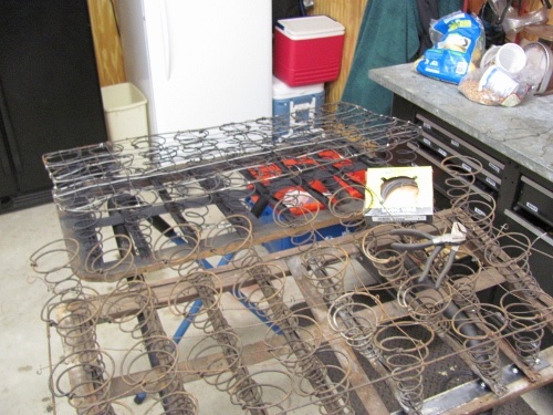

For proper repair of coil spring seat base, you can reshape the coils by stretching them back level to each other, then re-tie and reinforce the placing with music wire, that is hardened, and you have to use tough pulls and good tools to wrap and twist the wires in place. Works for times you cannot get a replacement seat spring. Did that for this aftermarket body, wanted to preserve the original springs that were OK, just sagging in spots.

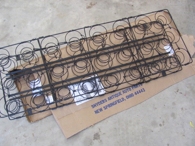

If you decide to replace them, Snyders makes excellent replacement springs that will fit perfectly.

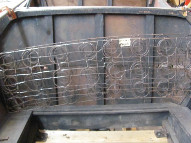

The photos of my repairs to the seat springs and the rear backrest with music wire proved successful. But no so with the front seat backrest, the wear and tear of decades made me fixing that impossible. I tried, but the music wire just pulled the old coils and frame out of whack. So, contacted Snyder's and they made me a new backrest spring, correct coil height and wire frame just like the old one.
Snyder's began business by making Model T seat springs, and that success let them to spring board (pun intended) to all sorts of new parts for the Ford.
From the old
To the new Snyder's that fit fine.

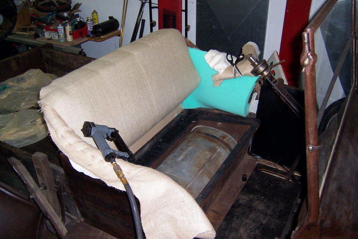

Regardless of which method you use to repair or replace the springs. Your car came with a round gas tank and the springs when all the way down in the seat frame will be about an inch above the top of the tank. If there is no base which covers the tank below the seat, you should take a thin sheet of plywood about 1/4" thick and cut to fit in the frame so the springs will not bend down to touch the top of the tank. You can cut a round hole over the filler of the tank so you won't need to raise the wood to fill the tank. The metal can cut into the tank and at least wear the paint off the outside of tank and cause it to rust, or even wear through the metal of the tank. I have been working on a 20 for a friend and there is nothing between the base and the spring. If I put a straight edge across the base, it is about an inch above the tank, but we put in a new tank and put down the seat and drove the car about 5 miles. The paint was already worn off the top of the tank. So what I am saying is important.
