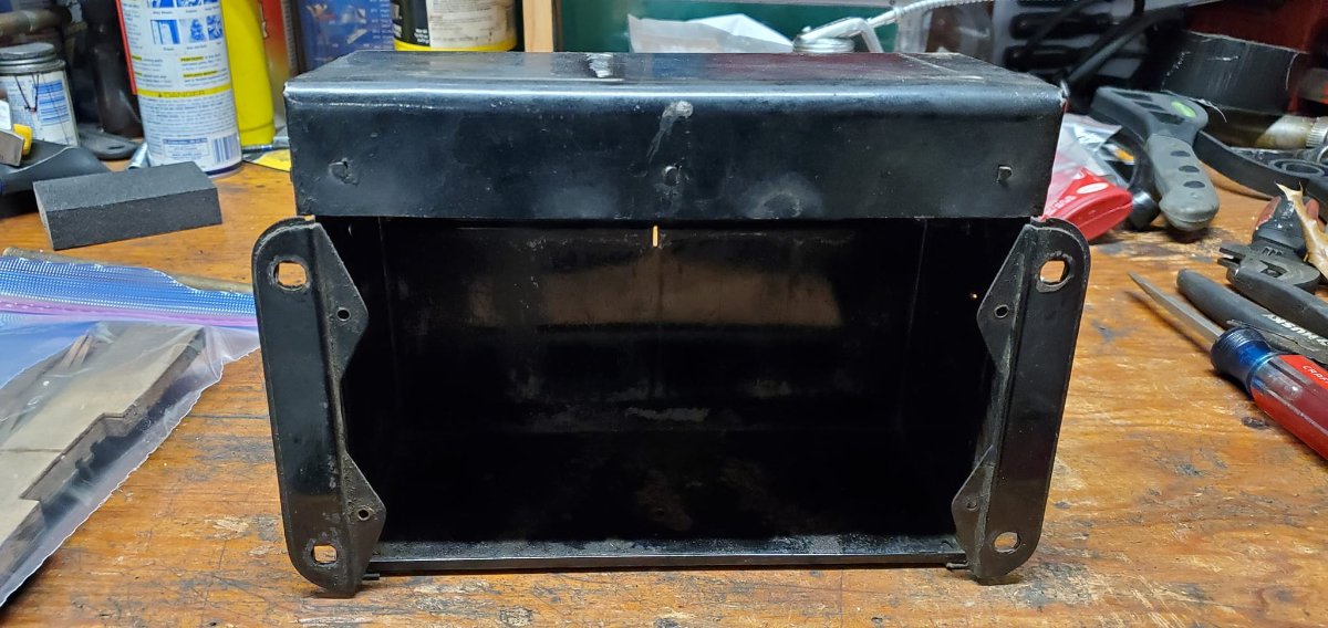

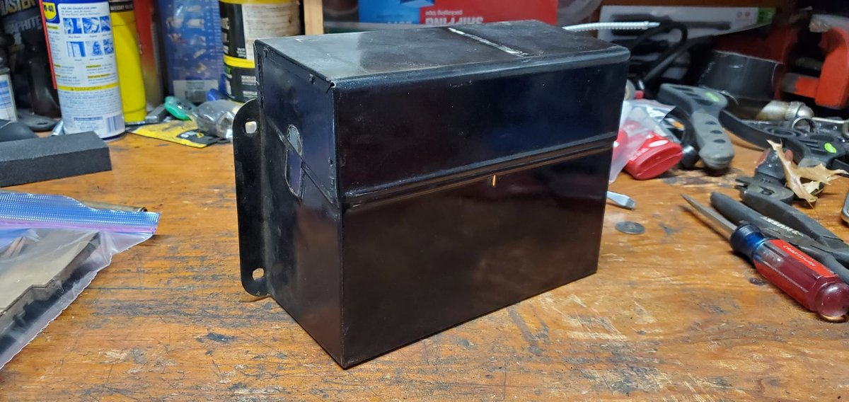

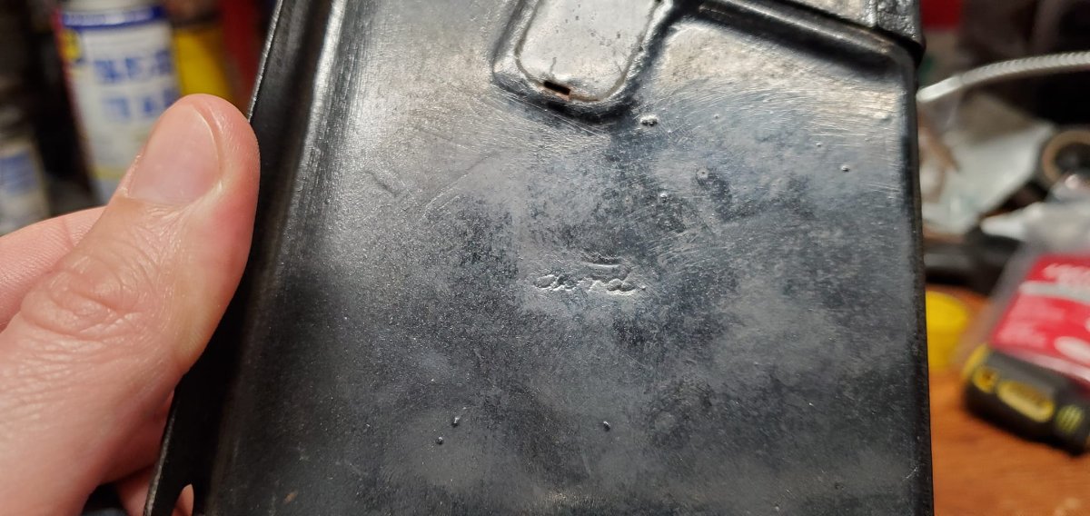

Hello everyone,

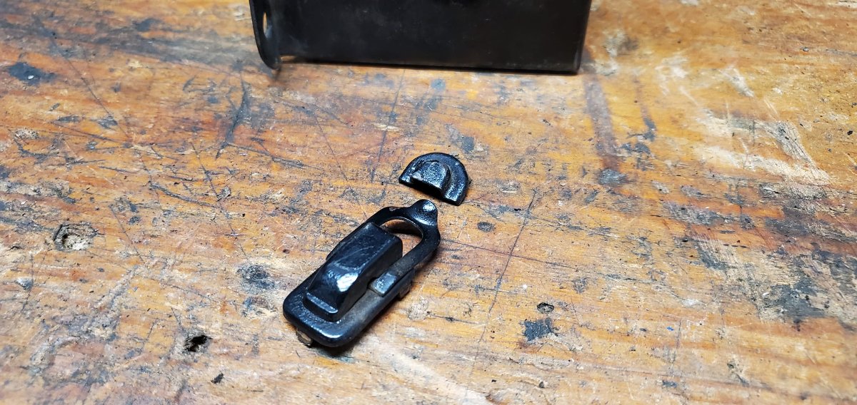

I have a May 1923 Touring car with short radiator and metal firewall.
I have the coil box apart for a rebuild and I wanted to make sure the side latches really should be nickel?
The judging standards show no mention of it, and the ones that I just took off are painted black.
From the standards: "Ford design steel coil box with sloping cover with no switch. Cover was the three-piece design. painted black."
23' Touring coil box latch finish?

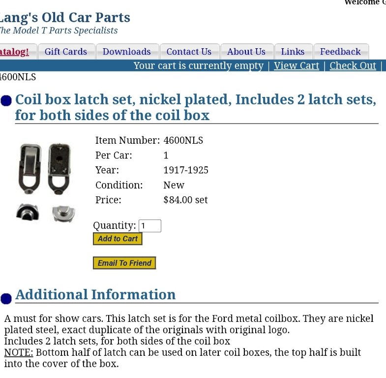

Yes, the tab fastened type latches, supplied by Corbin were nickel plated at least in '17-'24 style box with the ribbon divider between the pairs of coils.
Today that nickel is almost gone on most boxes, but if you inspect the folded tabs inside the lids, you can see remains of nickel on the exposed tabs.

Metal coil boxes were painted at the factory with one coat of M-101 black japan enamel (first coat) followed by one coat of M-102 black japan enamel (second coat). The paint was oven-dried after each coat was applied. The boxes were painted by dipping them in the above paints which gave a very high-gloss finish. This dipping process explains why many original boxes have paint runs in the paint on the boxes and their covers.
The original latches on the 1913 to 1916 metal boxes were brass plated. They were attached to the boxes after the painting process. Beginning with the 1917 models, these latches were nickel-plated.

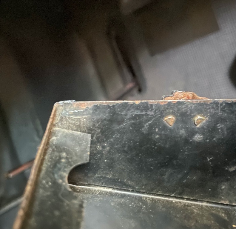

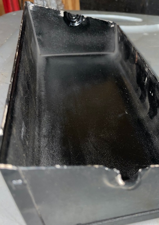

Next question to the group, after the box is sand blasted and painted... what is a good way to bend over the latch tabs?
Thank you so much! I am at work and couldn't access the encyclopedia. That really helps.
