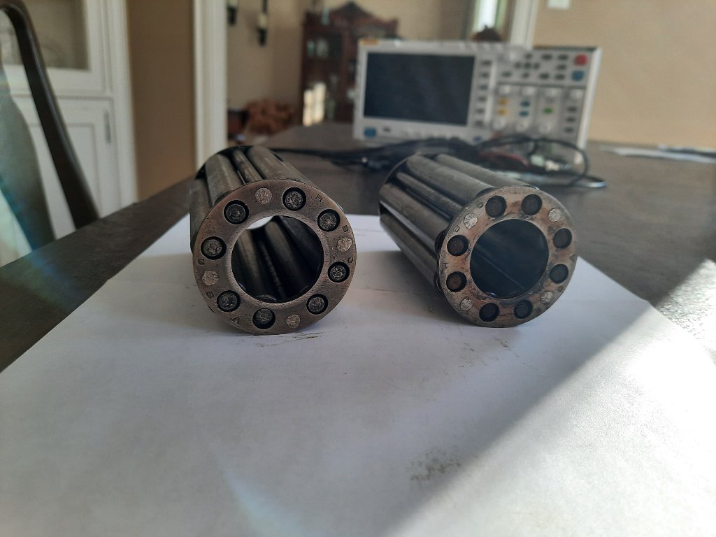

Pictures of my used bearings. Tim Wrenn helped me

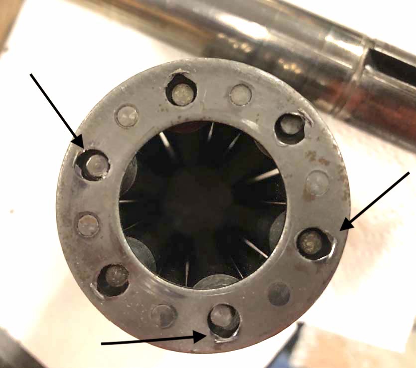

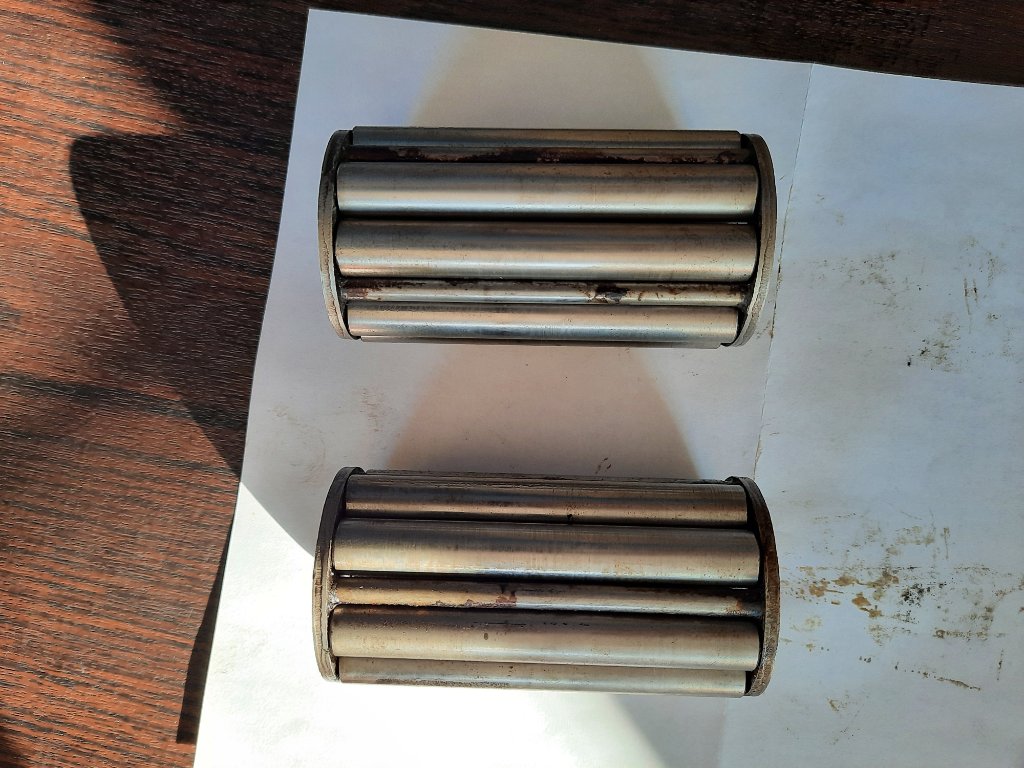

In response to several posters, picture were posted and arithmetic shows that the inner bearing misalignment more than the outer brgs.
Picture shows no wear or damage to the cages or rollers taken from my car. Thought to be 1970 or earlier.
Let's just hope that the wound roller bearing stay plentiful. Just loosen the radial play, which is a hard sell.
The pictures were taken in the dinning room while my wife was in the shower. She tolerates coil tuning in the house,, but not oily innards o21stf whatever.
Now it's time to check the condition of the wheel brgs in my car as well as check for axle seal leakage. Maybe still will be my next topic. No outer signs of oil, but I will examine inside.
Anotherpicture
