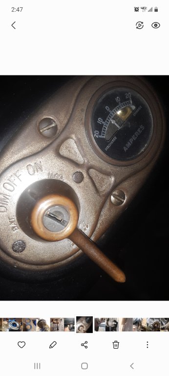

So cruising down the road and something clinked.... looked down and the glass from the Amp meter was laying on the floor....26 fordor.... how common is that ? And any tips on fixing it ??
- Posts: 6544
Re: Amp meter glass fell out.
Is this an original or repro ammeter. There isn't much to a small ammeter, a case and a bezel (that the glass fits into) that is press over the case. So either the glass diameter was to small or the bezel is worn. Be careful in taking it apart.

Hmm. Thanks, I need to look closer when I get home... I was sure it came out from behind the dash. It is an original meter, I think. The only pic I have of it is when I needed to see what for key number I need..

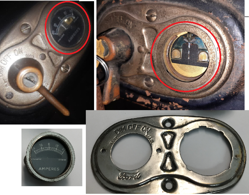

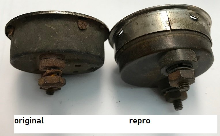

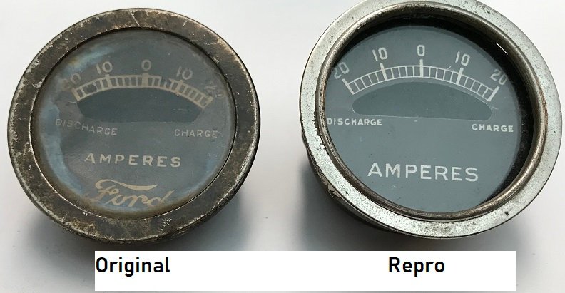

Your meter is a reproduction, the Ford Model T meter has a wider flat-face bezel that is nickeled to engage the switch plate, plus the Ford will have script on the meter faceplate.

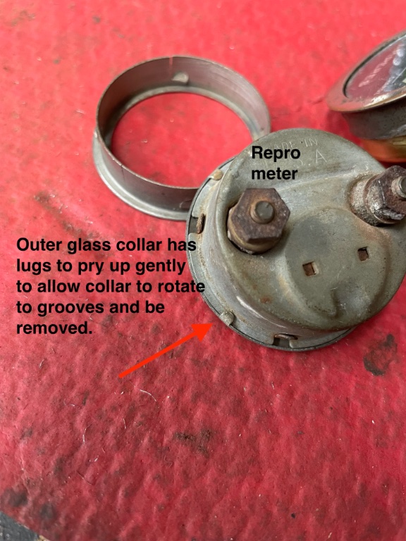

For the repros, those have a smaller rim or collar to encase the glass lens, you pry very gently on the locking tabs to get the collar to wiggle. Then rotate the collar to allow those tabs to clear the notches in the meter case, and remove the collar, insert the glass and install in reverse.
Comparisons, the lower left is a repro or Model A meter but I installed an original flat face collar to mimic the look of an original T Ammeter. The thin alum collars of the repro Model A style just don't look Ford T to me

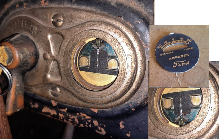

Four pics I have, the gauge itself comes out the back... I'll just slide em in if I can get the correct order..
- Posts: 6544
I don't know why your showing 2 glass plates - only used 1.Larry e rutt wrote: ↑Sat Feb 26, 2022 12:48 pmFour pics I have, the gauge itself comes out the back... I'll just slide em in if I can get the correct order..
Also the needle pivot appears to be on top instead of the bottom to match the face plate. ---
Once you remove the ammeter, pulls out through the front of the face plate, the vacated space should look like the one I added. It looks liek you have an extra bezel - may explain what the problem is. --
Your ammeter is a repro

Thank you so much. I did put it back together, nice detailed instructions. However, something strange is going on. If you look at my first photot the faceplate does not have the ford script on it.. My second photo of the parts the faceplate does have ford written on it... And two glass pieces , that is really strange
- Posts: 6544
Good have happened when someone took the old face plate and bezel and put it on the repro case. Anyway did you use the flat bezel on the case and how did you secure it?Larry e rutt wrote: ↑Sat Feb 26, 2022 8:10 pmThank you so much. I did put it back together, nice detailed instructions. However, something strange is going on. If you look at my first photot the faceplate does not have the ford script on it.. My second photo of the parts the faceplate does have ford written on it... And two glass pieces , that is really strange![]()
