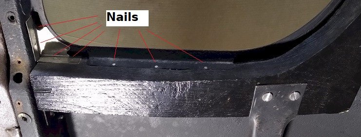

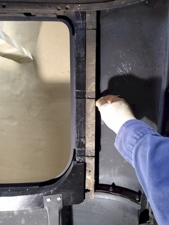

There are two threads with the same question...
On your other post, I show two different window styles.
Please tell/show us which one you have.
Ignore the 2x4 poking through the window.

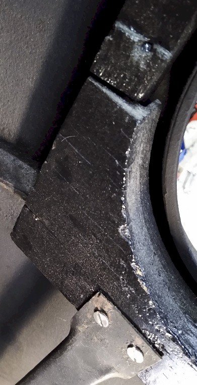

The lower piece of wood is:
1-3/4" square at the B-pillar,
13-1/2" long,
5" tall towards the rear,
1-1/4" at the top, from front to rear,
The B-pillar 1-3/4" tapers to 1-1/8" at the rear.
The back side of the block to the rear is cut out for the #2 piece of wood.
View of the curve that follows the window steel.

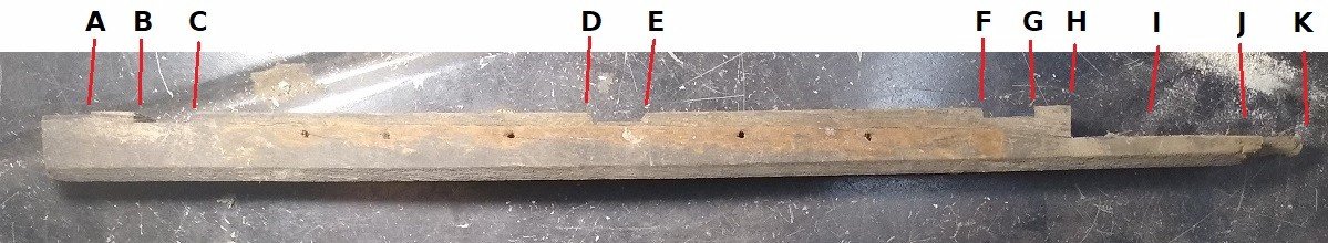

The bottom 6" of piece #2 has a slight taper on the back side.
A- 3/4"
B- 1-7/16"
C- 2-5/16"
D- 8-9/16"
E- 9-7/16"
F- 15-1/8"
G- 16"
H- 16-11/16"
I- hole 18"
J- hole 20-3/8"
K- 21-1/2"
1-1/16" square
From the top to A: 1/16" cut out (behind the steel).
From B to C: 5/32" cut out.
From D to E: 5/32" cut out.
From F to G: 5/32" cut out.
From H to K: 1/2" cut out (to fit behind #1 piece).

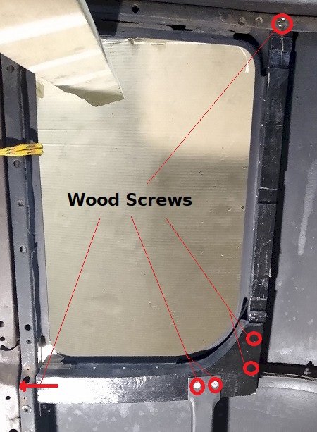

The two holes are countersunk drilled from the back side and the screws are installed from the back side.
Of the four long edges, only the back side to the rear corner is beveled, 7/32".
At the top is a countersunk hole for a wood screw.
Insert the finished piece in position and mark this top hole.

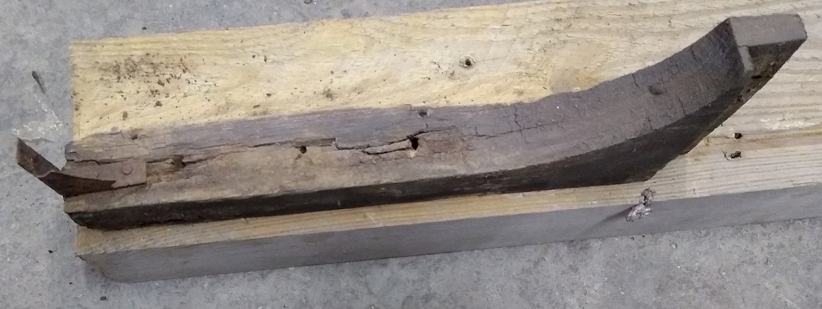

Let me encourage the O.P. by saying that I only had the left side and built the right side in reverse with simple tools.
The old piece, unpainted 21-1/2", was originally on the left and needed to be replaced.
The lower block on the right was tapered with a hand held belt sander.
