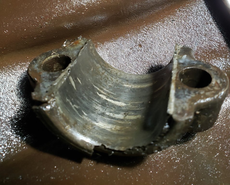

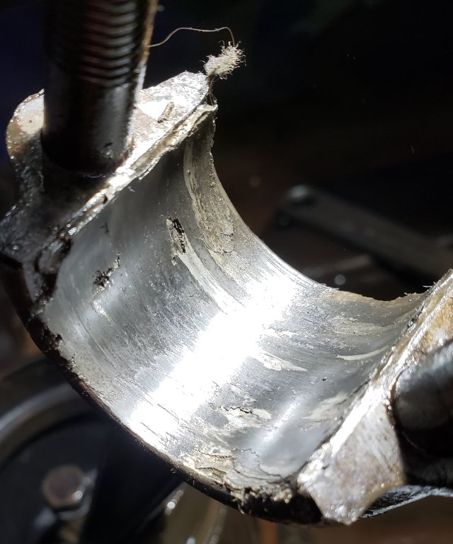

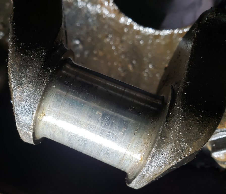

Re: About a 1/4" - update
Post by Petrah Phyre » Sat Feb 19, 2022 8:26 pm
Measured the piston drop and it ended up being 0.10". Drained the oil/water/babbitt sludge. Pulled the inspection cover. Noticed right away, the side babbitt was peeling and all of the shims were on one side. I assumed you would balance them. Pulled the piston and as you can see, the babbitt looks to be a bad pour. Leary about the rest of the block. I checked and I have a full set of rods with fresh babbitt that look to be in good shape. Checked the wrist pin and it is loose as well. I know I have a set of new domed pistons somewhere, I'll just have to dig them out to see what I have. May just need to button it all back up until after our move to SD.
Posts: 7890
Re: About a 1/4"
Post by TXGOAT2 » Sat Feb 19, 2022 8:36 pm
Looks like mostly babbit damage. That's way better than steel on steel.
