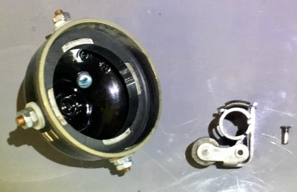

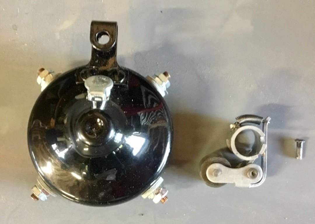

As I mentioned in another thread, I am going back to the original type roller timer. It has been so long since I used one, I forgot how best to lubricate one. Over the years, I have read methods going from one extreme to another. Everything from using 3 in One oil to packing the housing with Vaseline. Those of you who have used, or are using an original roller type timer, how did, or how are you lubricating it? Thank you, Jim Patrick
