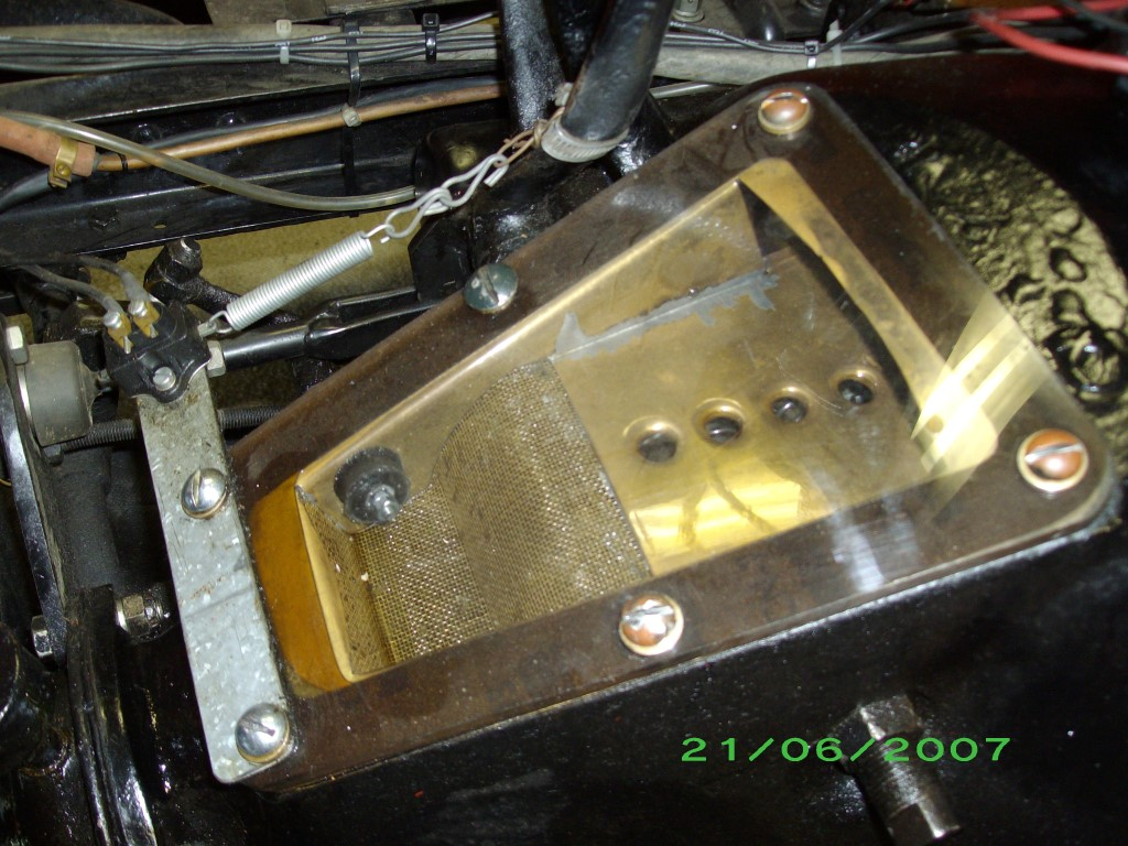

- Posts: 6579
Re: Oil Change and Trans Oil Screen

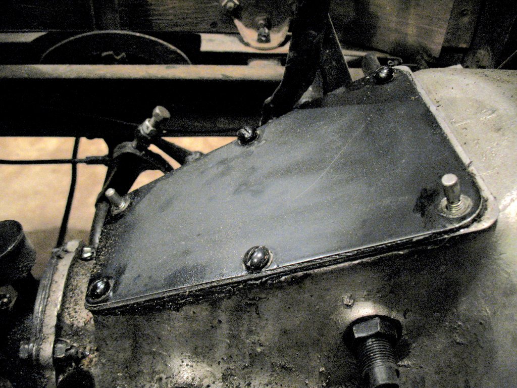

Here are some pictures to help ou see it fit into the transmission housing. Some suggest making the holes larger other not. Most all recommend strapping down the magnet, not sure where it would go even if if broke up but tht might be one a earlier design. This is a good pro/con like http://www.mtfca.com/discus/messages/50 ... 1437749776
The only difference in doing it before or after changing you oil is what is in the oil before you added it. AND be careful not to drop anything into the transmission, so move all screws, nuts washers, keys etc well away . If you drop something in, you must remove it before you can drive again.

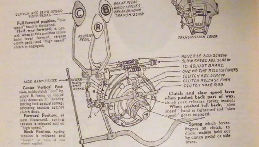

Thought I'd check in this evening with a status update. My '23 Touring does have an oil screen already installed. I cleaned it, which just involved wiping it down with a rag and re-installed. My friend who was helping me suggested putting a good magnet in the screen to pick up any stray metal fragments. Since any magnets I have lying around fall into the "not good" category, I'll add that to my shopping list.
We also checked the rear end oil level and it was very low. I added about half a bottle that just arrived from Lang's along with some other parts. I'll monitor for leaks, have a clean container under the rear.
Something was going on with the linkage between the high-low pedal and transmission. The little part that has a clevis on one end and then a 90 degree bend at the transmission end was well-worn so I ordered that as well. They sell the individual pieces that make up the linkage, so I guess if you want to save a whopping five bucks you can just order the part that looks more worn out and wait for the other part to wear out farther down the road. I bought the whole thing, it's secured with cotter pins at both ends. I just hope there isn't some strange adjustment I should be aware of when installing. Right now I have the pedal at the highest point of travel and that's how I'm installing the linkage.
Thanks again for all the help and suggestions.
Gerrit
Gerrit
- Posts: 6579
Good instructions from Model T Ford Fix. Also a good reference for other solutions
https://modeltfordfix.com/adjusting-the ... nd-clutch/

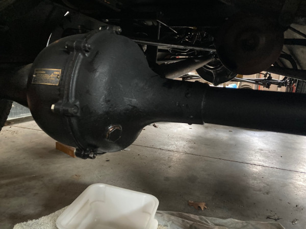

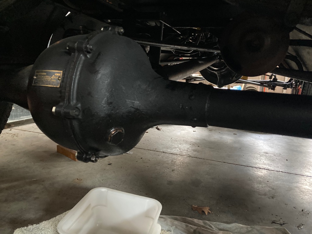

On the subject of the rear end oil level, this is what I have. I think I'm ok. You'll notice it's also a Ruckstell rear, very pleased with that. Thanks for all the information.
Gerrit
Gerrit
- Posts: 8636
Caution!!!! The Ruxtell axle requires a different grade of lubricant than the Ford stock axles. Oil capacity and oil level checking may also be different. Get good information before proceeding.
- Posts: 7411
For those who are wondering, the lowered filler hole begins with 1919. From 1919-1927, fill to the hole. The Ruckstell book says oil level is the same as for the stock rear axle: 1919-1927 fill to the hole; before 1919, ½" below the hole. Use 90W or 140W, not grease or 600W.
It's good to have the books and use them.

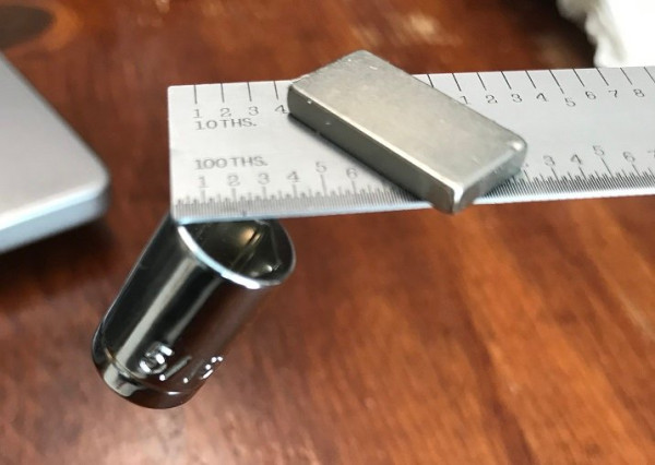

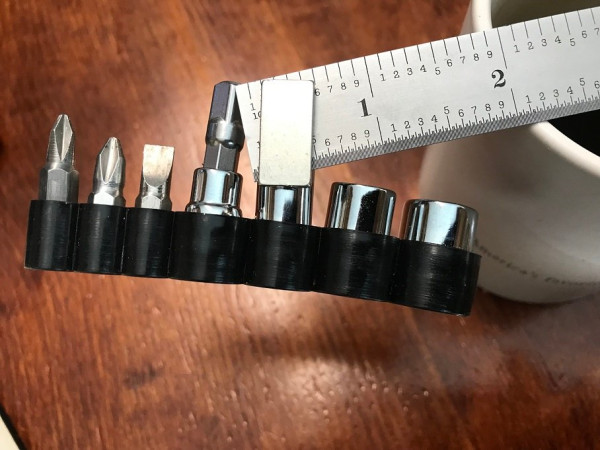

Gerrit - I would install a rare Earth magnet and never worry about it coming loose. You can google K&N magnetics. Don't go too big or you will never get it off the oil screen. If you have never used one of these magnets you will be amazed at how powerful they are. Buy the highest grade that they carry (the higher the number the higher the temperature they will handle).
To give you an idea of the magnet's strength, I bought a few 3/8" discs to try to find an imbalance in a flywheel (not a T) they would remain in place at 1,200 RPM. I did not need to go higher.

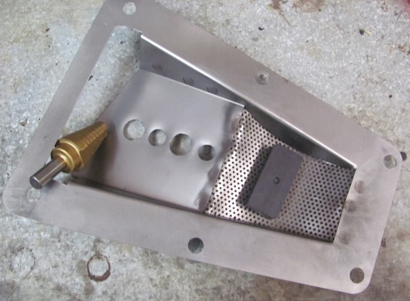

- Posts: 6579
Great idea, likely will make the whole tray magnetic in the process. You can't pick the magnet of the ruler in the picture, you need to slide it off to an edge. Since a picture is worth a 1,000 words, just a little demo on how much strength these rare earth magnets have. --John Codman wrote: ↑Tue Mar 08, 2022 1:38 pmGerrit - I would install a rare Earth magnet and never worry about it coming loose. You can google K&N magnetics. Don't go too big or you will never get it off the oil screen. If you have never used one of these magnets you will be amazed at how powerful they are. Buy the highest grade that they carry (the higher the number the higher the temperature they will handle).
This is about how much the magnetic strength from a short distance. That's about the max weight at that point

This is the ceramic magnet you can get at Menards. About $2.50 for a pack of two.
Same as the one up above in Frank's post.
You can start a big discussion if you want over whether it should be placed vertically or horizontally in the screen.
