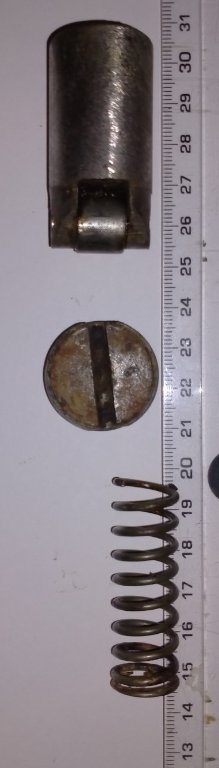

Sorry Marttyn
Here is the plunger in detail,
Cheers
Adrian
