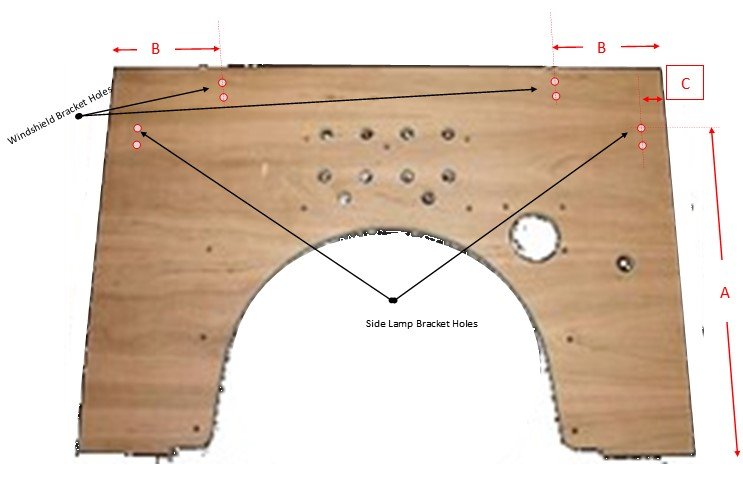

I am needing the factory location of the holes for the side lamp brackets (-both the 'A' measurement and the 'C' measurement), ...and the location the windshield clips are mounted inboard (-the B measurement) from the edge. Can anyone help me with this??
Thanks!!

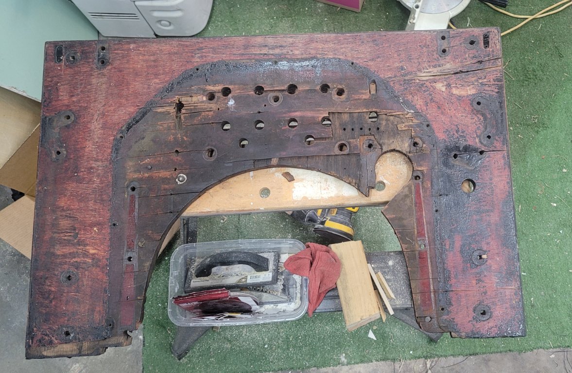

But I have hanging on my shop wall a NOS 13/14 firewall and those holes are not drilled in it. Guess the dealer was on his own with those holes. I think I have a used dash in another building and will look when I get a chance. Dan

On mine measurement A is 16"
B is 4 1/8"
C is 2" at the top hole and 1 3/8 at the bottom hole, but my brackets had offset holes.
Hope that helps.
B is 4 1/8"
Hope that helps.

Be careful taking measurements off an original artifact. Even plywood shrinks significantly over this many years. jMHO

The measurements I have are from an old set of wood plans for a 1914 Roadster. The windshield frame brackets are 4 inches from the outside edge and 3/4 of and inch and 1 3/4 inch from the top of the firewall. The top hole for the side lamps (for jno Brown) are 5 1/2 from the top and 1/3/4 from the edge. If you have E & J lamps use 8 inches from the top and 2 inches from the edge. It is recommended that you drill the top hole and position the bracket with lamp and adjust straight then drill the bottom hole. I hope this helps!
