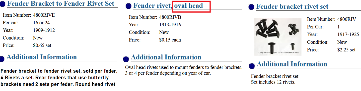

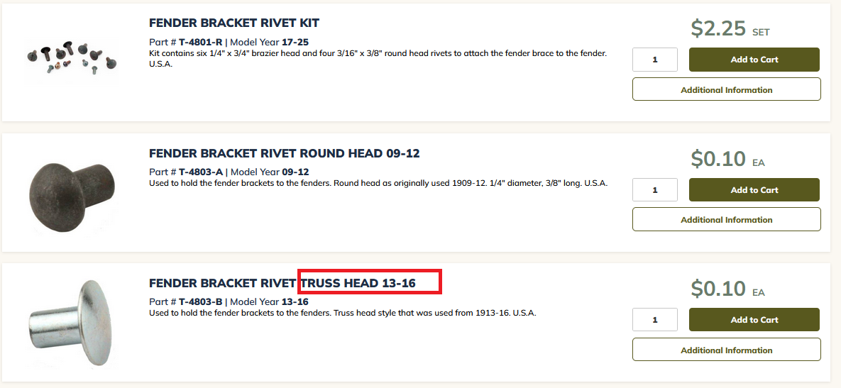

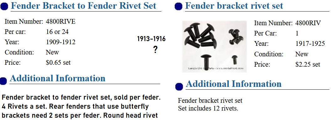

A lot of the rivets in Jim's catalogue are listed only by size. He does specify ¼ x ¾ brazier head for front fenders, but I don't see anything listed for rear. That's why I asked about size. I'll ask him.
Lang's catalogue shows a ? for 13-16.
If Jim doesn't have them long enough for the rear, I'll ask Mister Google.

Snyder's says truss head! Looked in Lang's offerings again. Used a different heading for 1913-16. Truss or oval. that is the question :?

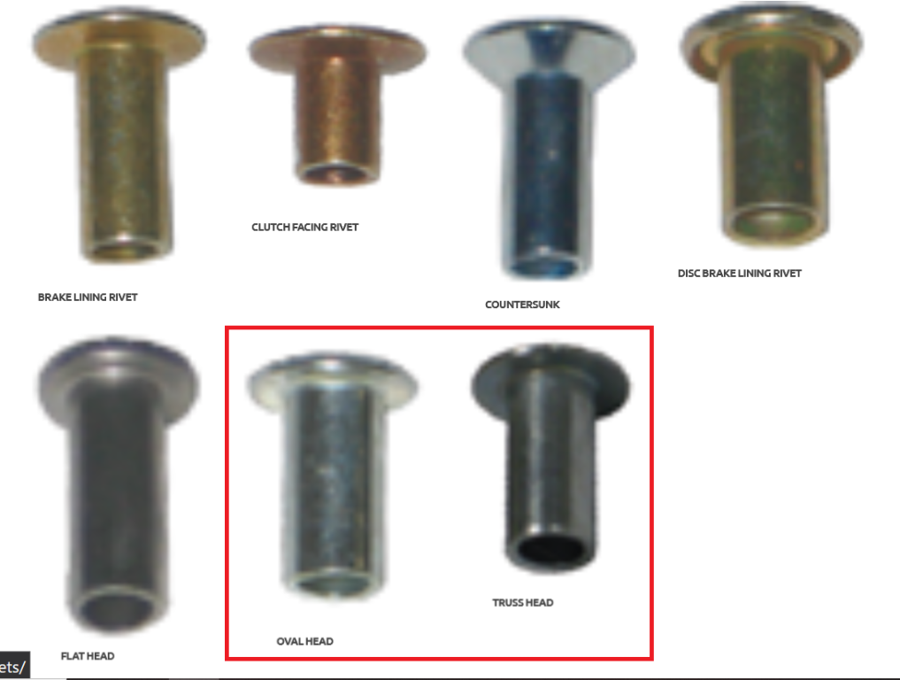

One online source says truss and brazier are synonyms. I suppose I can get truss heads, and if the heads are too big I can turn them down in the lathe to match the originals.

I had been looking at rivets, entirely different application., and yes came across the same definitions truss= brazier. This site gives all dimensions (head sizes been the one of interest crown & diameter) for oval & truss https://prairierivet.com/products/solid-rivets/ doubt if the buck needs to care
