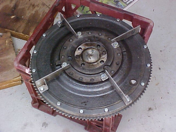

I use distributors all of the time. Use slingers instead of magnets. Slingers pump plenty of oil. I use mag post oil line with mag pin assembly removed. No issues so far with oiling.

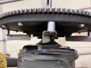

I did a transmission last year with magnets and NO mag ring. After pulling the engine and then removing the transmission I found 3 broken magnets. Doing the ring test on the remaining magnets 8 more broke in my hand, for a total of 11 broken magnets out of one engine. All 16 are now in the scrap pile. It went back together with Texas T oil slingers.

I had to remove a friend's engine just to replace those slingers, after one broke loose for no apparent reason.

I use nothing but distributors with 8 slingers slightly cut down on width. Some real oil moves!

Texas T slingers "had" a reputation for coming apart. Dont know about now, but wouldnt take a chance. I make 4 slingers from T6 90 degree x 3/4" x 1/8" extrusion, full magnet length on spools, Running them in 3 of my own & a dozen or so customers. No issues. Moves a lot of oil.

Hank, do you use bought slingers or build your own ?

I believe the Texas T slingers have been updated with a gusset to prevent the failure issue from the older style where they wear bent. I use broke steel or extruded aluminium and make my own spools. Someone told me they had a cast Ford spool crack when tightened down with a grade 8 bolt.

Hank, #1 do you make your own slingers, and #2 why do you cut them down on the width?

Do not make my own anymore.., cut down the width to break down over loading unnecessary drag, add 8 total for better balance.

Using 8 slingers instead of 4 might reduce horspower loss at higher speeds by causing troughing effect, which would introduce slippage. With 8 slingers, liquid oil would only have 1/2 the time to flow in behind one slinger before the next one came by.

Narrowing the vane will reduce torque and drag. I use an outside oil line as well.

That is correct. Mine have been in since 2010 without any problem. However, the supplied ring gear screws were not to my liking, so I used 6mm x 1mm screws which self lock into the ring gear.
