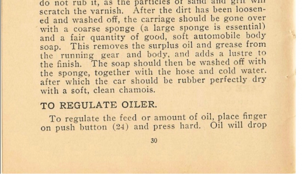

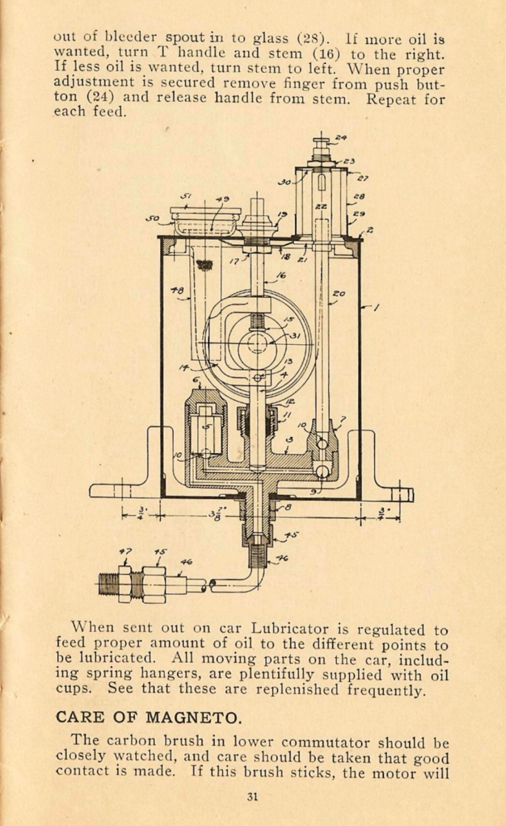

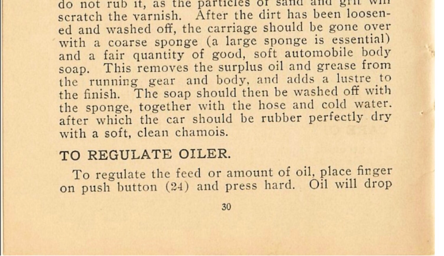

Below is a link to the 1907 Model K operations manual. Below that, two pics of the portion dedicated to the oiler:
https://www.dropbox.com/s/nk0z9fdemjvwj ... l.pdf?dl=0

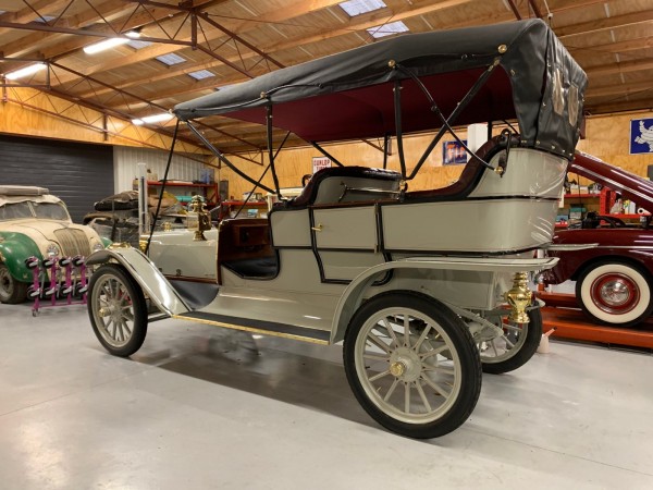

Thanks Howard. Quite a beautiful Model K. If anyone ever questions the colors, I hav found articles describing a K with red leather upholstery, and another of a K touring with white body color.
Please keep us posted as you get it on the road.
