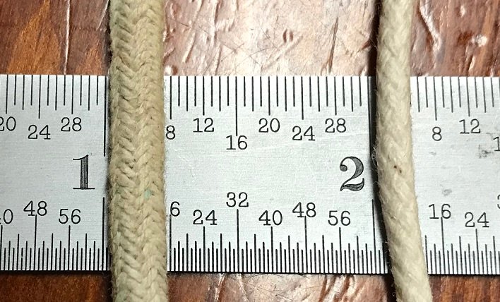

The repro the vendors sell is not the same OD as the original. I believe someone had said it was just window sash cord.
Length is 23.5 (60cm) inches OD 3/16 (4.76mm) inch [repo 1/8 inch (3.75mm)]

TRDxB2,
Thanks for that. Appreciate the photo.
Now to look around for something... the wife's away and some of the sash cords look tempting

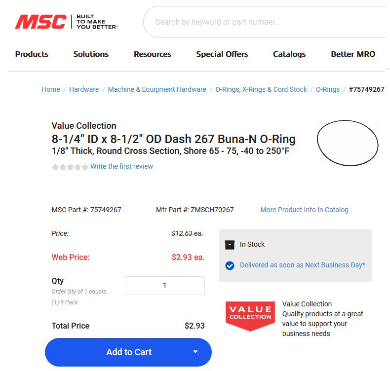

Whatever you use make sure it can compress to make a seal. I wonder if this would work.....
