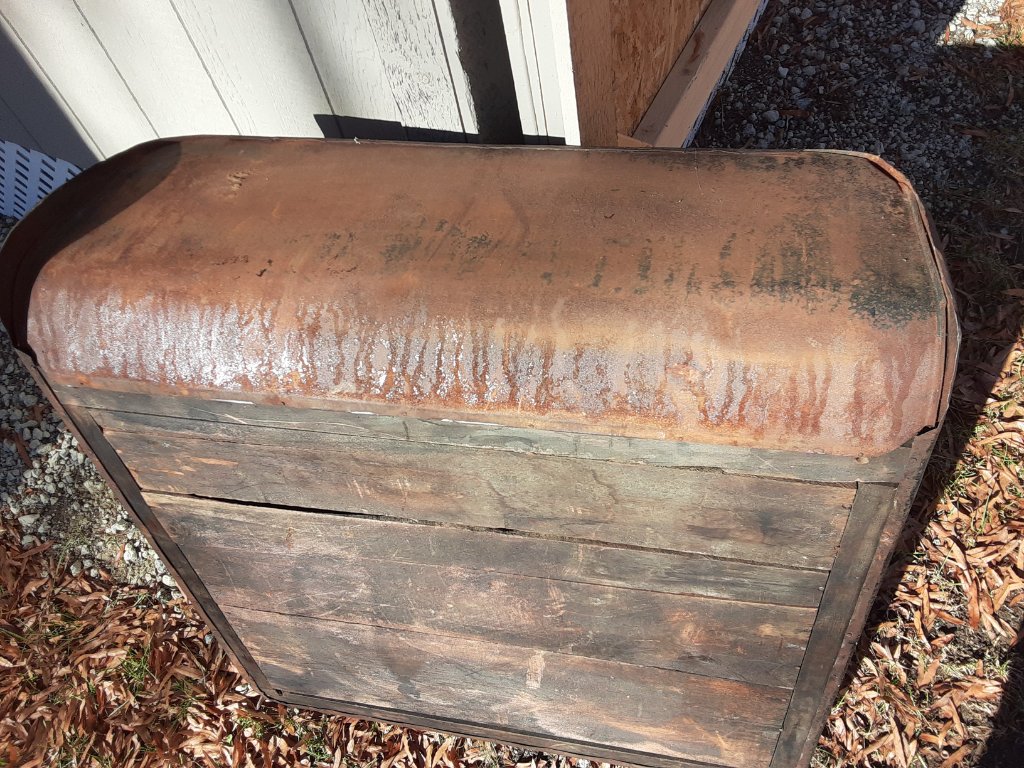

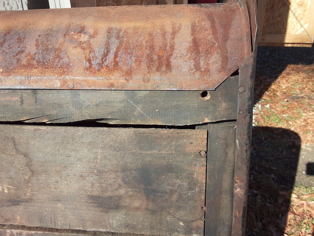

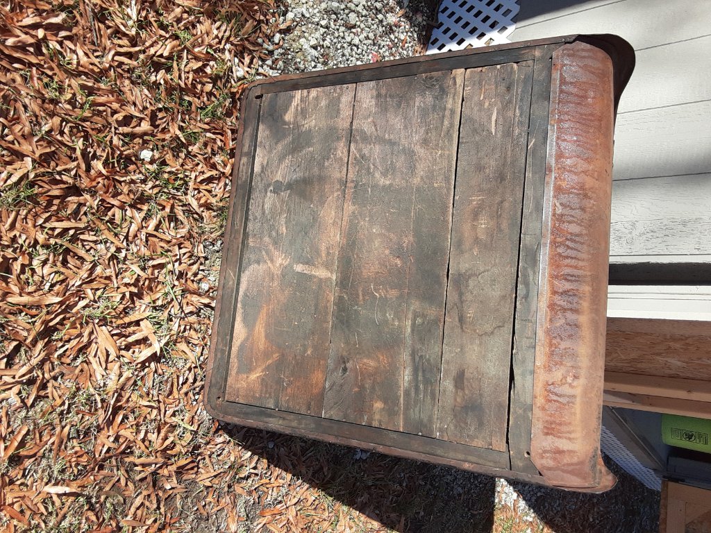

Here are some photos of an early trunk deck I have. hope they help. Darryl

Re: 1914 Ford Model T Roadster
Darryl, thanks so much for posting those photos. Many turtles are found with all that removed making it hard to know what was there.

The originals were spot welded into place at the top and sides. Nailed of course on the bottom. I tack-brazed mine I made into place since I don't have a spot welder.
Turtle decks as with bodies were produced by several companies. They varied somewhat in details and materials from one manufacturer to another. I can see some variations between the one Darryl B posted photos of and mine, also one I borrowed from a good friend to copy that front panel from to replace my missing panel.
Also, a lot of these turtle deck/trunks had a wooden floor as shown in the photos. A few originals I have seen did not have that floor, nor any sign that it ever did, just the wooden framework around the outer sides and front. Bolted down, the body's rear deck is the only floor in the trunk.
