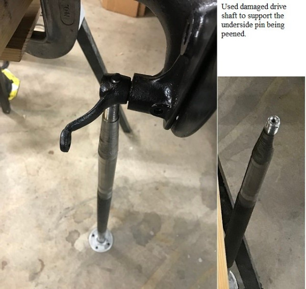

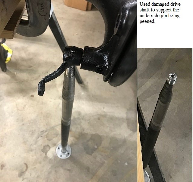

- Posts: 6553
Re: Roll Pin For Driveshaft?
Made a peen tool (bucking bar) from an old axle for brake cams, u-joint .. those awkward places to get to when assembled
