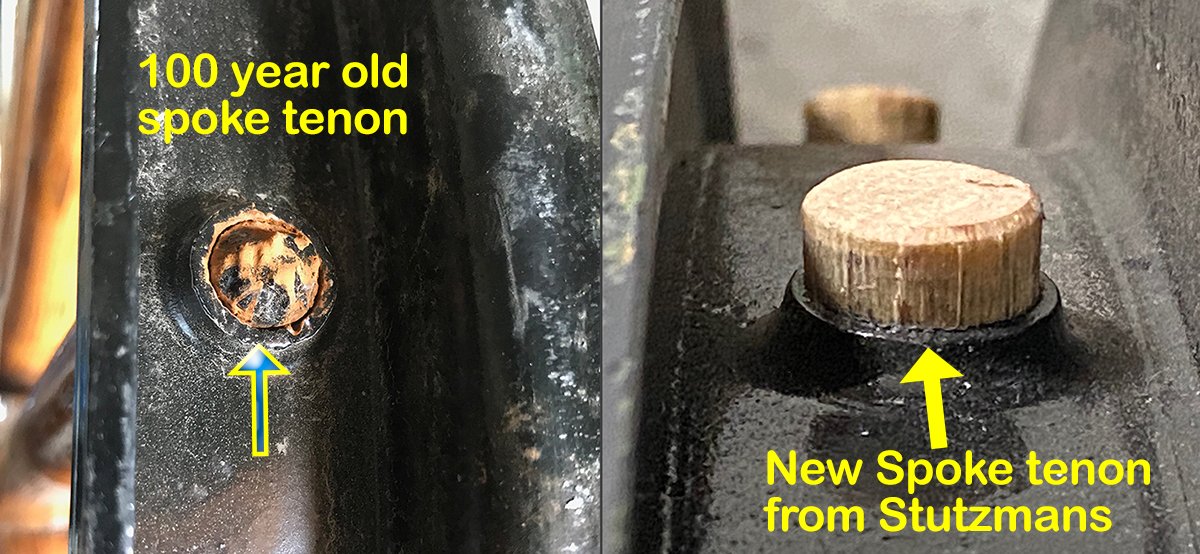

Recently I've had occasion to discuss whether or not spokes needed replacement with a couple of different owners. I had others tell me that spokes were fine that I thought should be replaced. Comments like: "Just soak them in a kiddie pool" etc. I thought I'd share my own personal experience and see what others have to say.
I have a mix of new and 100 year old spokes in the wheels on my car. I check them for looseness but in particular, I look at the condition of the tenon poking thru the wheel felloe. If the spokes are tight and the tenon in good shape I consider the wheel to be OK. If the top of the tenon is eroded (looks like a wart to me) I consider the wheel to be unsafe. Too much side load and I fear the tenon could shear right off.
Photo one shows an old spoke with an eroded (warty) tenon and a new one recently re-done by Stutzman.

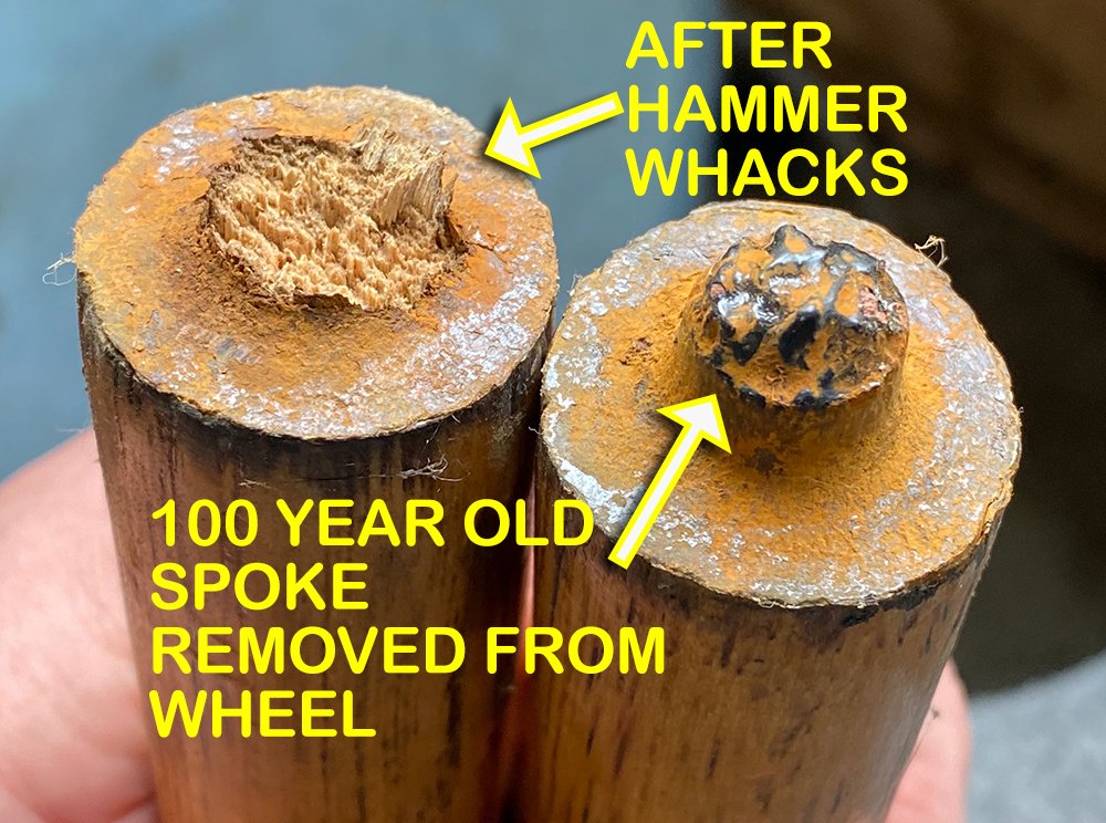

Photo two shows a removed eroded spoke next to a similar one with the tenon sheared off. I laid the tenon on the edge of my workbench and gave the spoke a couple of moderate whacks with a hammer. The tenon sheared off and went flying. I didn't have a new spoke to test but I suspect it would have taken a lot more force to break the end off.
Would those with more experience care to chime in?

Wood deteriorates more rapidly when it is in contact with iron or steel. Any place in a structure that tends to trap moisture will cause wood to decay more raidly. The condition of the body of a spoke is not a complete indicator of its overall condition. The exposed body portion can look good and the tenon and butt of the spoke can still be bad. Spokes can be tight at the hub and loose at the rim. A wheel can appear to be tight, but the tightness may be due in part to rust at the point where the spokes and felloe meet, and rust and dirt in the hub. Such a wheel would tend to loosen up in service, and the hazard that decayed outer spoke ends presents is obvious. Failure would probably occur when rounding a curve, and it would probably be a total failure of the wheel.

None of those old spokes are fit for use.
Looking at the shoulders, (the flat area surrounding the tenons), you can see that they've been worn shiny by movement between them and the felloes. That means that they've been worn too short for use. Some will shim the tapered ends to force the spokes outward and to reinstate tightness, but most likely, the relative movement that wore on the shoulders, also wore on the tenon diameters, making them too small, even if there aren't rotted to nubs.
