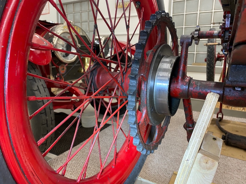

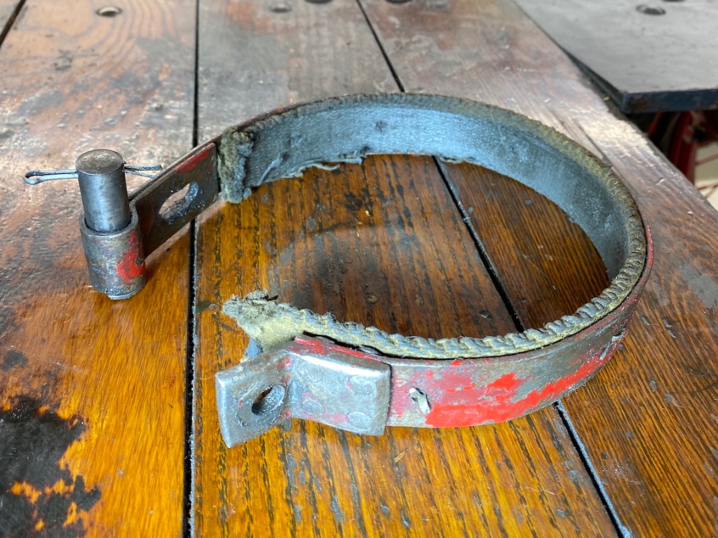

I am relining the service brake on my 1906 Orient Buckboard runabout. All you forumeers grumbling about marginal Model T brakes take note: the Orient system utilizes one external band, a full inch in width, contracting around a massive 5" diameter drum on the left rear wheel.
I have a couple varieties of Model T woven lining on the shelf and would like to repurpose one of them for the Orient project. Photos below. The colourful linings at left have this handwritten note in the box: "Multicolour edges are old Montgomery Wards. Very (too?) thick"
My questions: First, are either of these linings a better choice for this application? And second, is there a better type of lining out there that will give superior performance?
Obviously, I hope to use something I have on hand but if there is a more effective lining available, safety trumps convenience and cost.

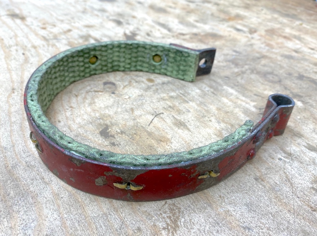

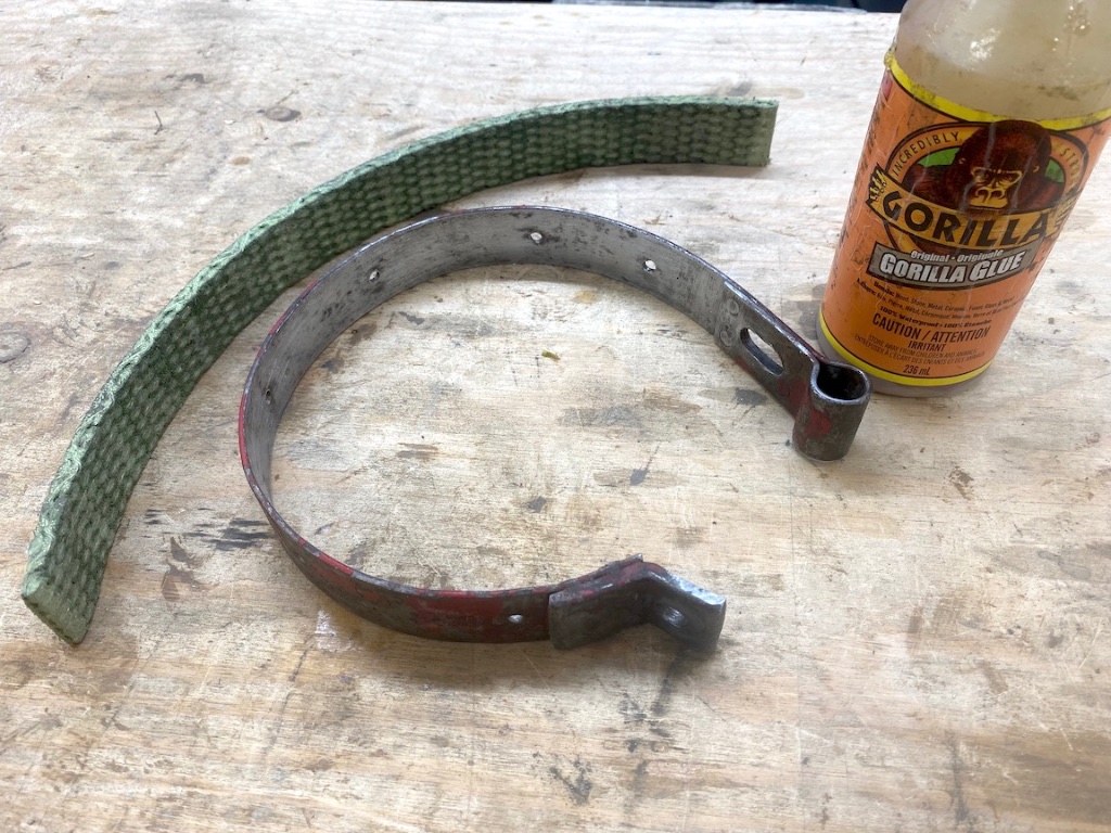

I think the lining install went OK. That Green Grabber is flexible but hardly pliable —I gradually compressed it around a former, hoping to let it settle into shape slowly and forestall a break in the weave.
I then glued the lining to the band with Gorilla Glue prior to countersinking brass rivets into the lining. Second photo shows the 1" leftover glued to a bit of steel bar as a test; there was no dislodging the lining from the sample steel after curing overnight.
There Is enough spring-back from the installed lining that an at-shoe return spring is not required.

Re: Woven brake lining question (non-T application)
Modern, yes, but also necessary for this application — there was a lot of spring-back from the lining and there is no way the rivets could have held it snug to the band. The brake drum is only 5" diameter and the lining was not happy with that much curvature.speedytinc wrote: ↑Sat Mar 19, 2022 7:16 pm...Glue wasnt necessary. Bonding the linings is a modern thing.
