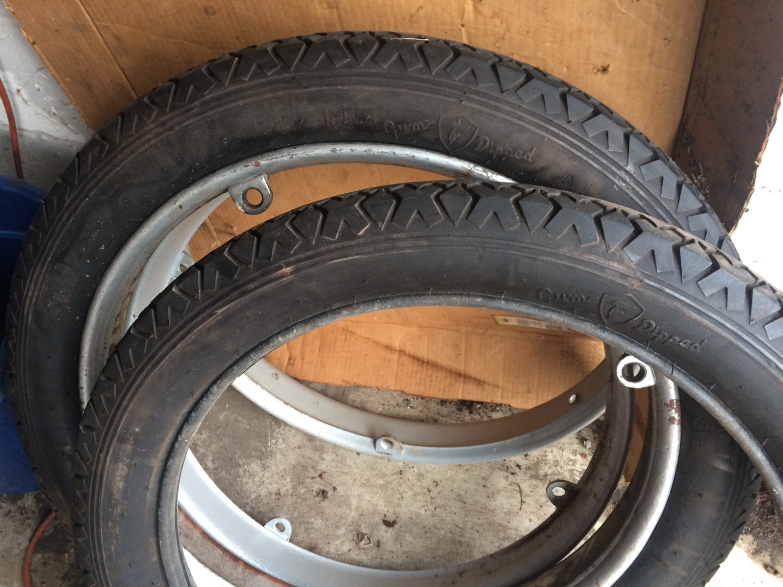

Post by Bob McDaniel » Tue Apr 02, 2019 12:33 am

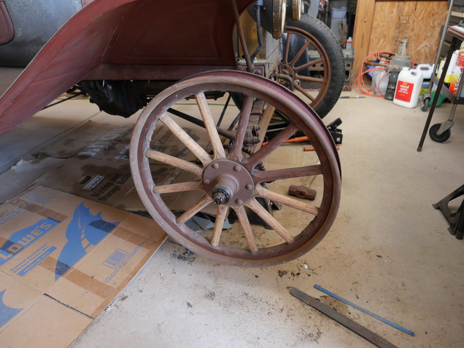

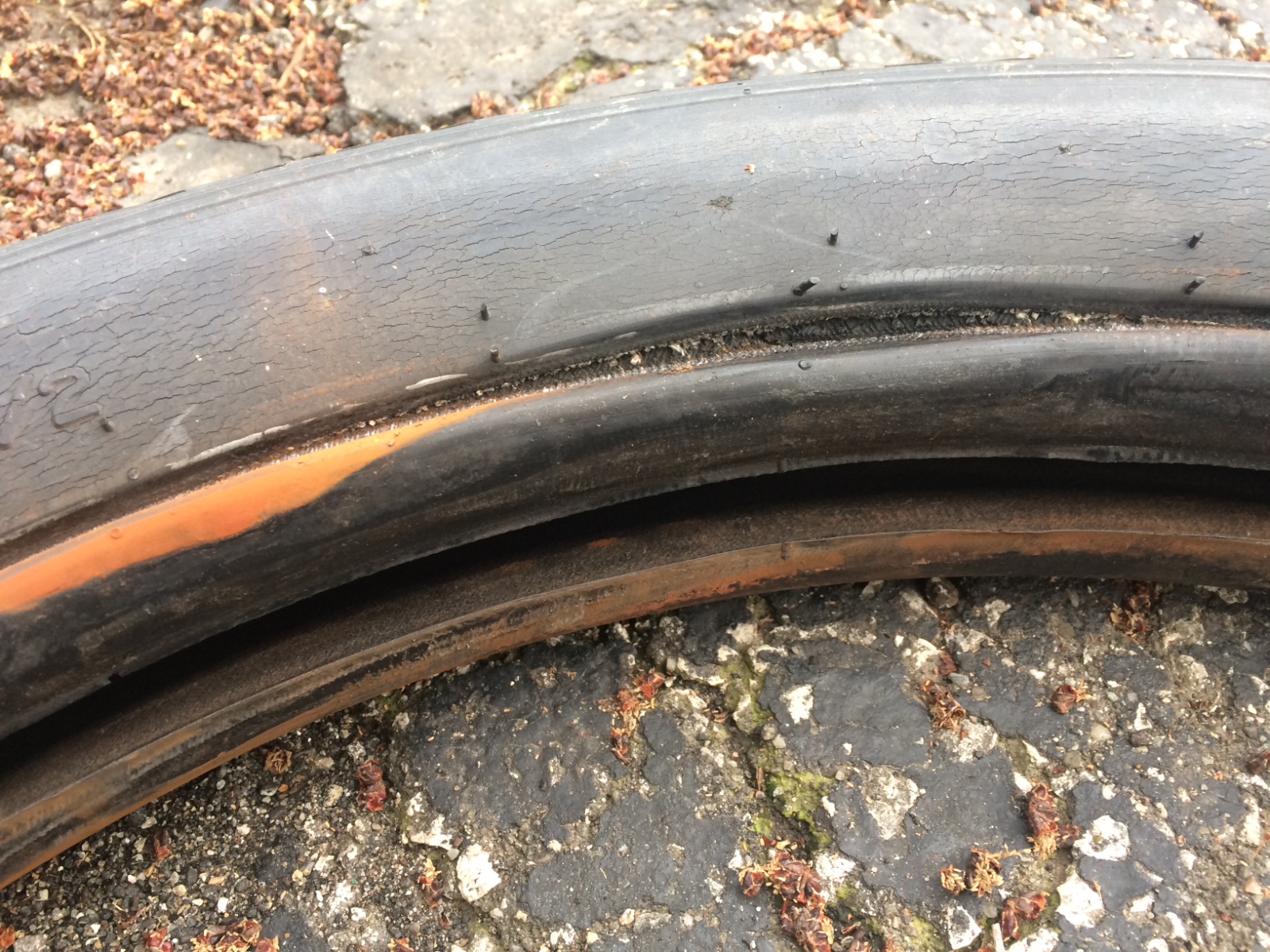

Pulled the wheels off the 09 and replaced one rear wheel that was racked and not safe. Looks like the darn thing would be under warranty but the local Ford dealer is out of them. Glad I had a good spare. Getting it ready for summer!

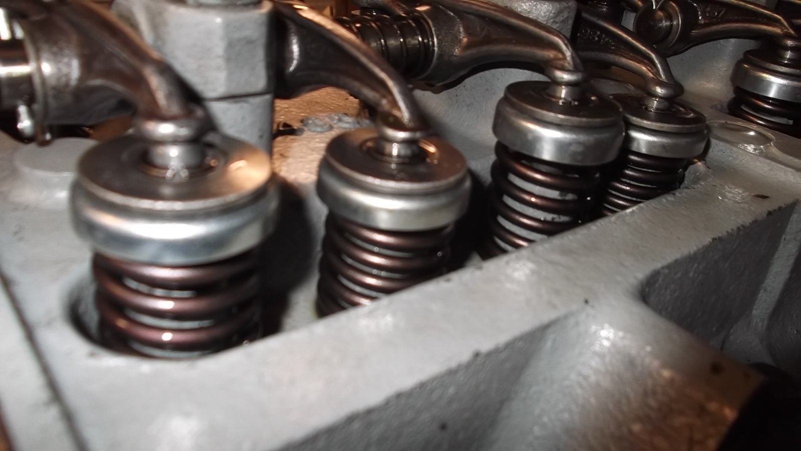

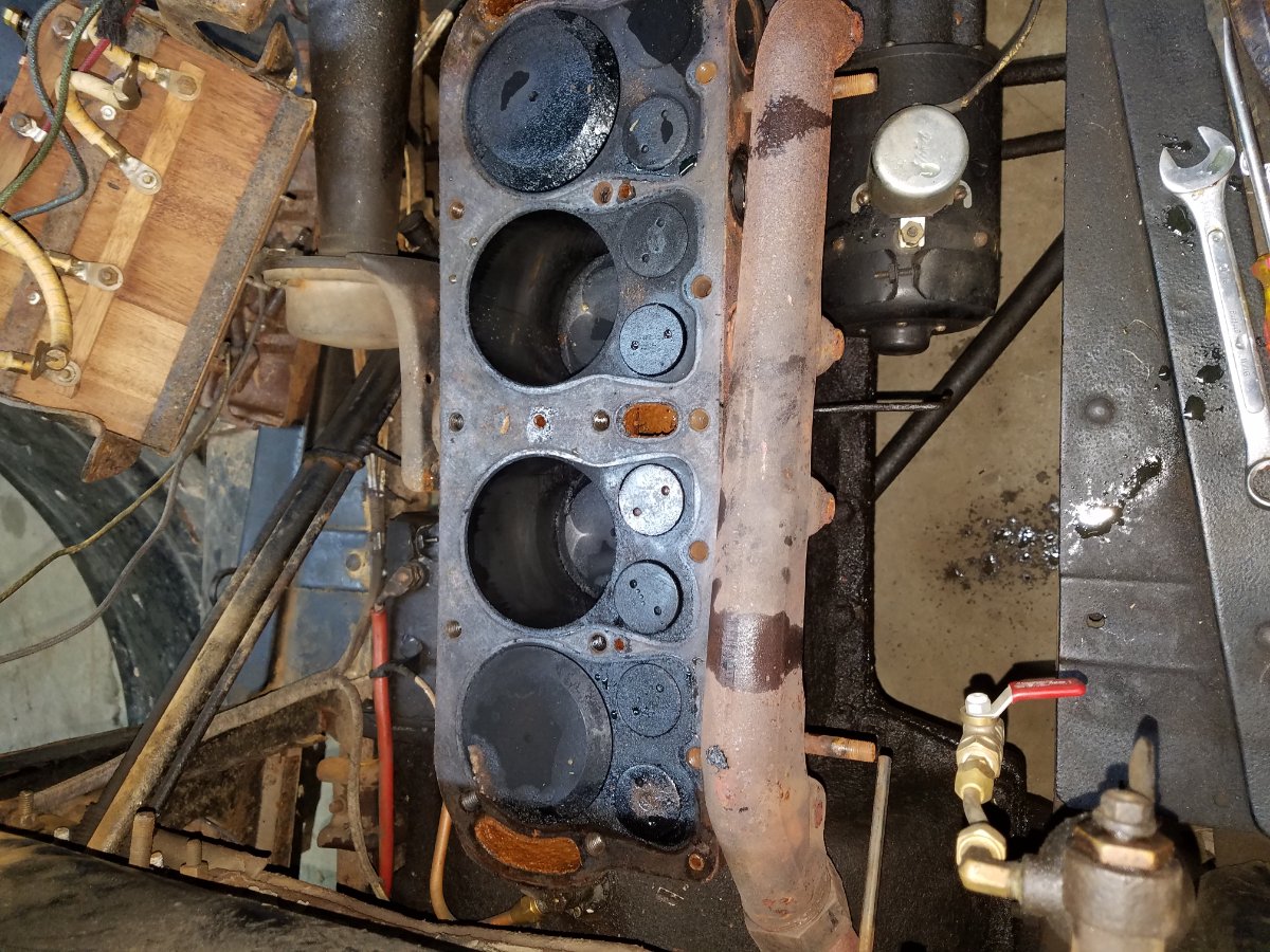

Post by Mark Gregush » Tue Apr 02, 2019 10:38 am

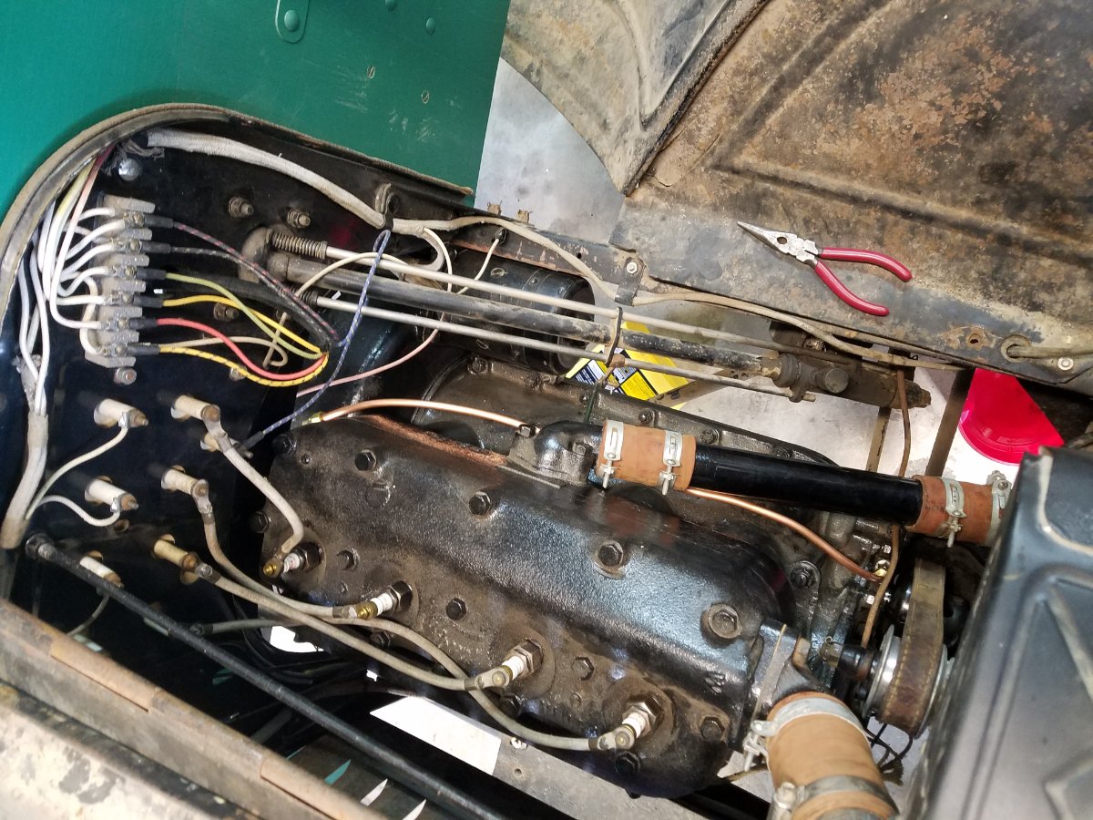

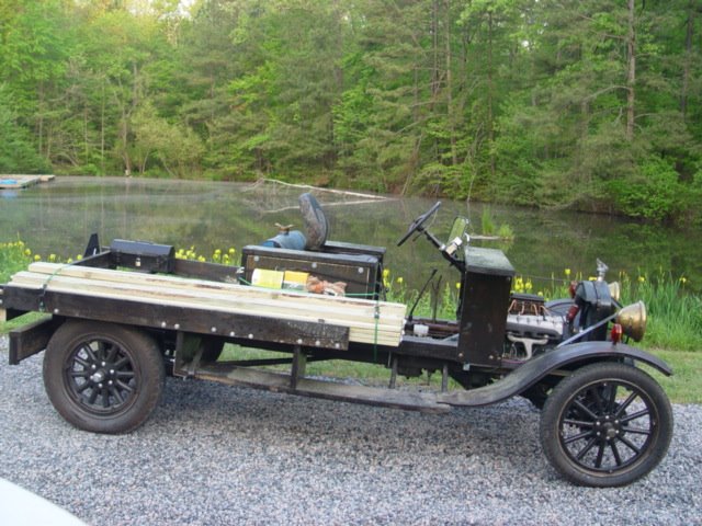

Sorry to say I pulled the Chevrolet over head conversion off my T. Not disappointed with the results, just don't have room or money to keep experimenting with it right now. It ran fine but with the carb setup I was using was slow. I will have the whole shebang at the Portland (Oregon) swap meet (EXPO center) this weekend.

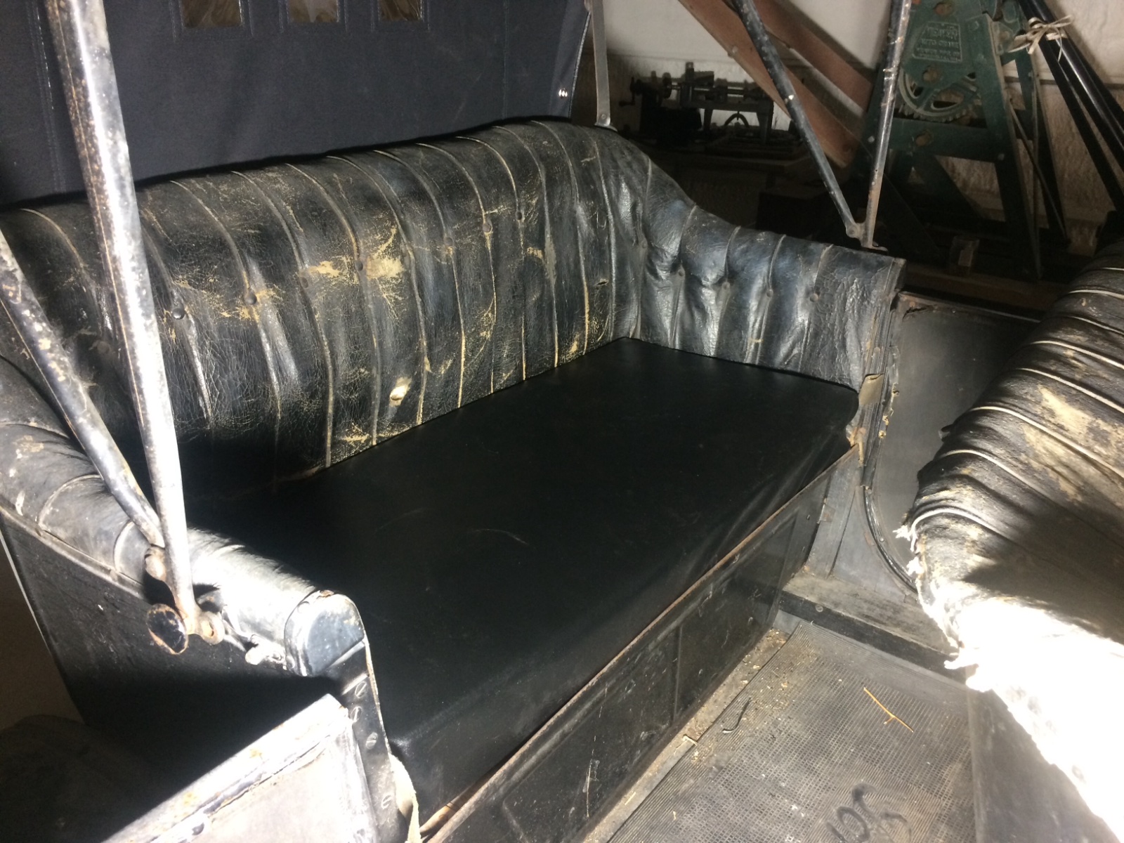

Post by Jem » Tue Apr 02, 2019 5:06 pm
Got it out the shed and dusted off the cobwebs

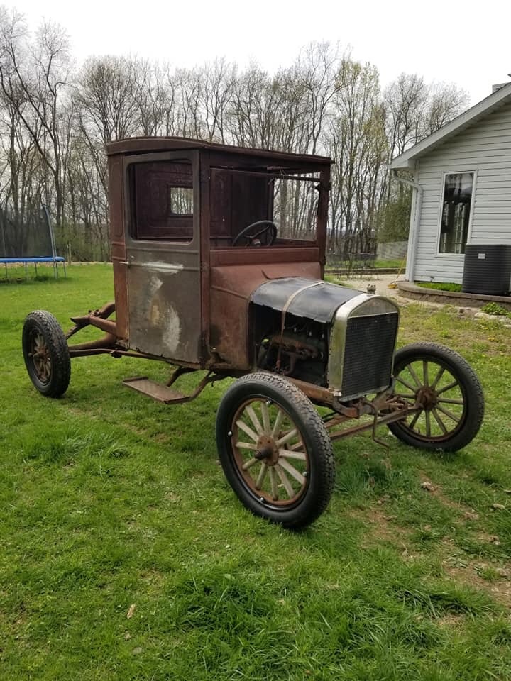

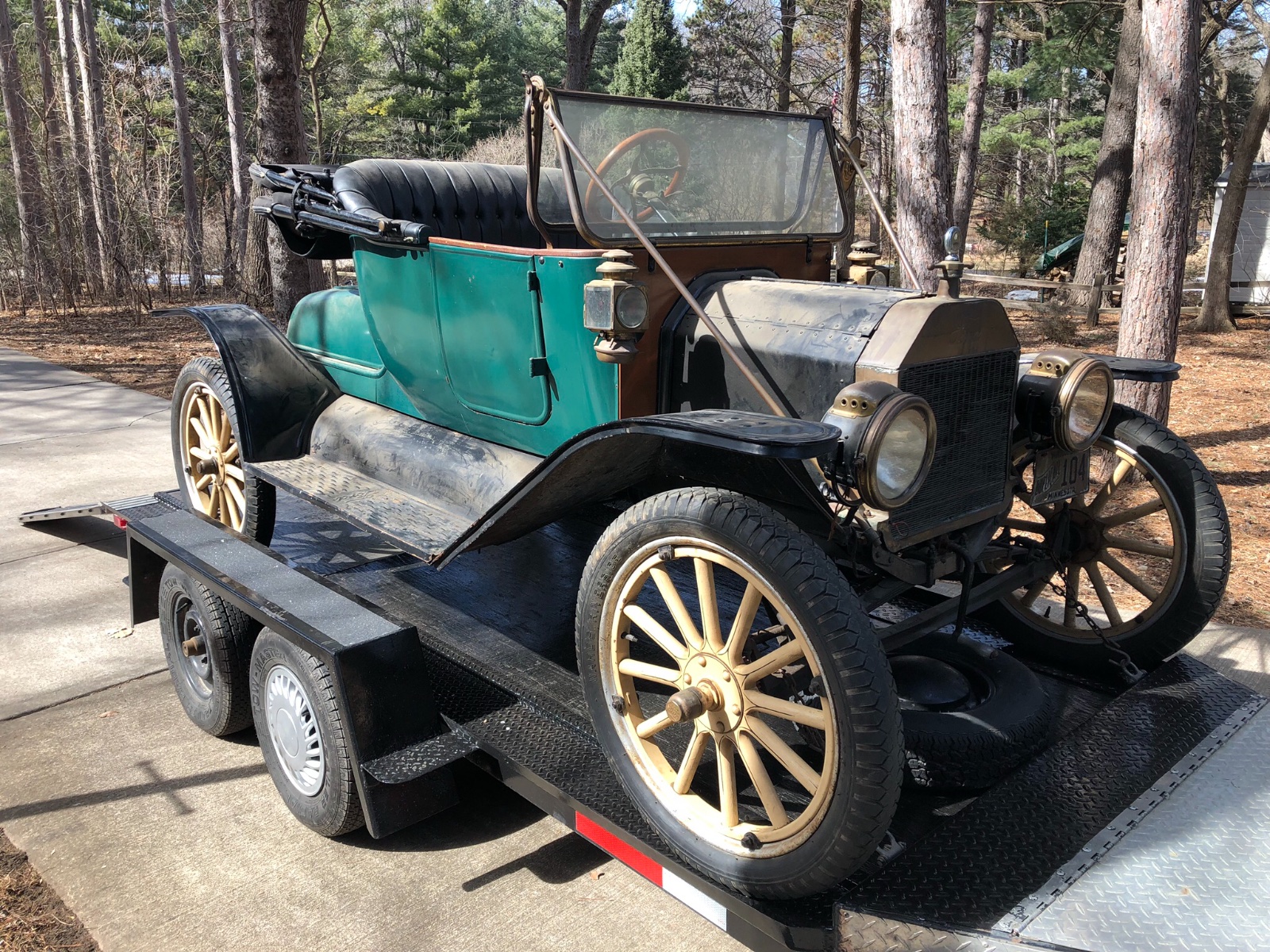

Post by Jeff Perkins » Tue Apr 02, 2019 10:40 pm
Just bought this one and brought it home. It was sitting in a home garage near me for 30 years. Needs a good cleanup and then we will try to get it to run. Should be fun!

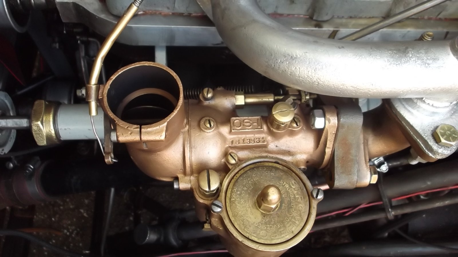

Post by Steve Jelf » Tue Apr 02, 2019 11:22 pm

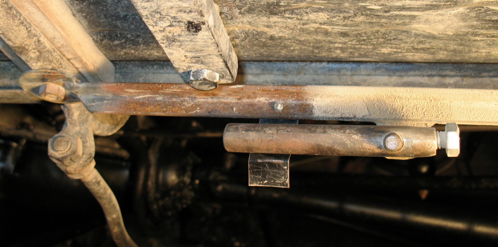

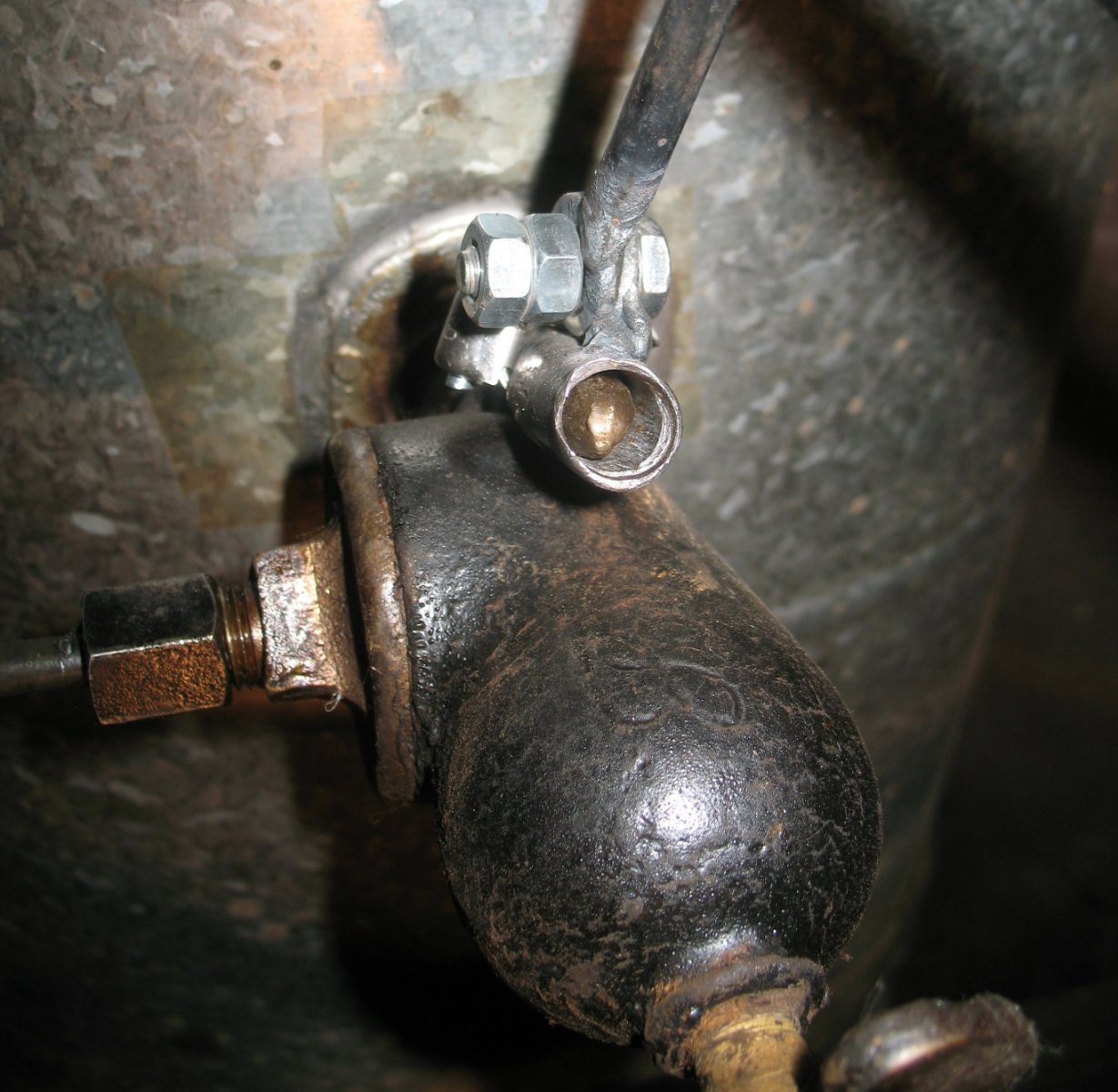

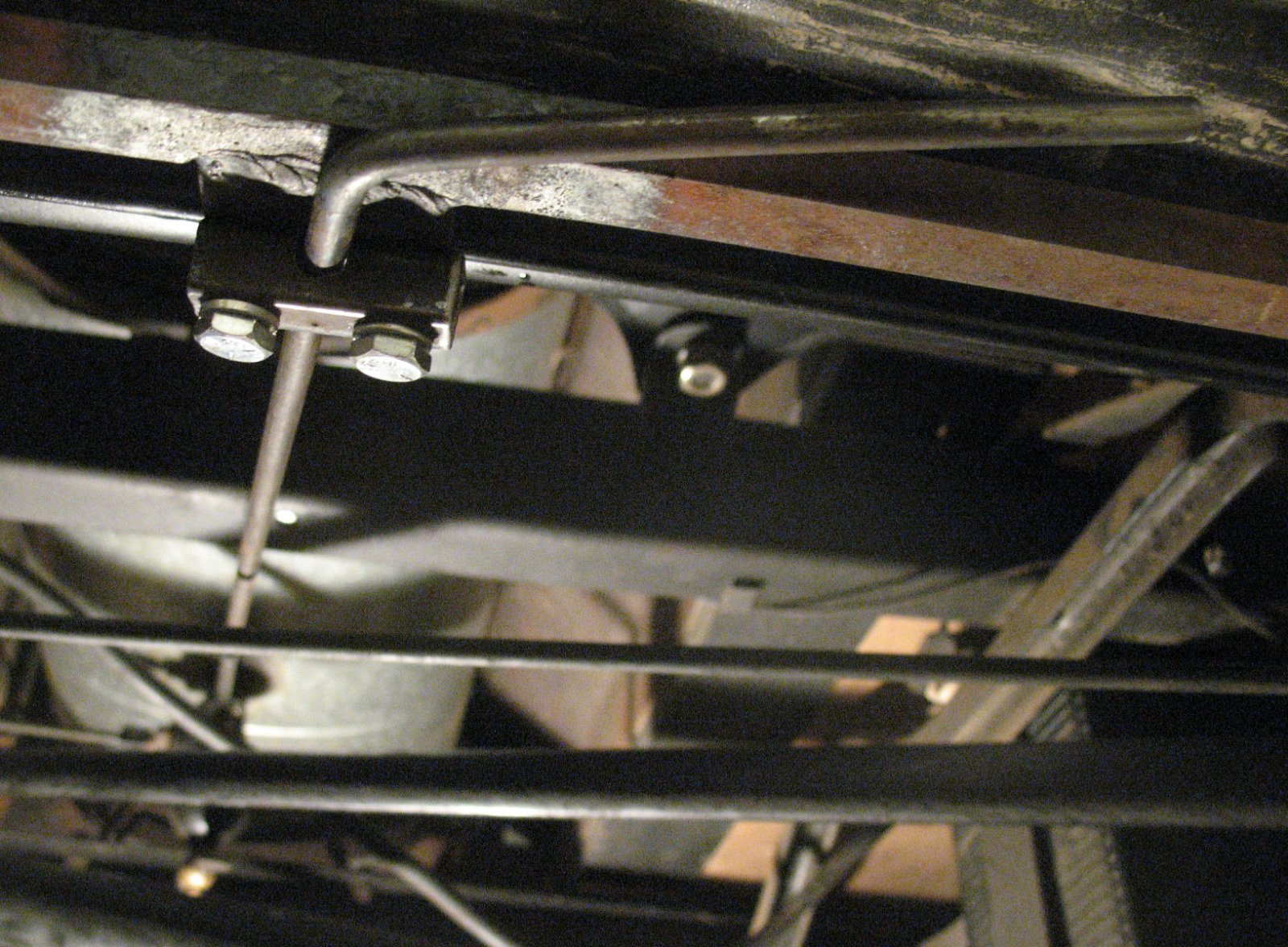

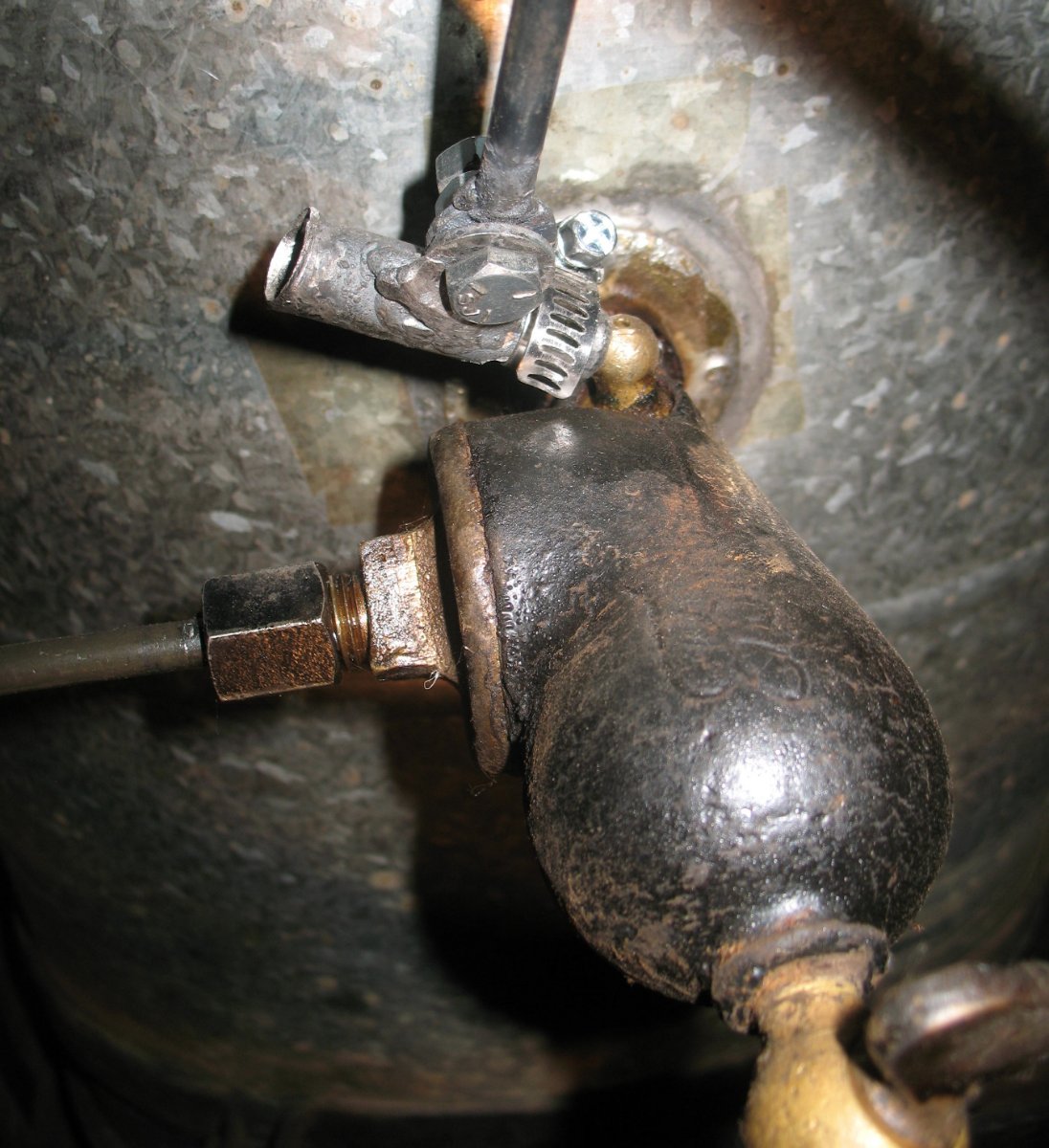

Shouldn't I have a valve on my carburetor to shut off the gas? No. It looks modern, and/or it's so stiff you practically have to use a wrench to turn it. After seeing a setup like this on a TT a few years ago, I made one for my 1915 runabout, and I just made another for my 1923 touring and installed it this morning. You can turn the sediment bulb valve from beside the car. No need to crawl underneath.
Two running board bolts hold a length of angle iron, which holds a rod attached to the sediment bulb valve. When the handle is down...
...the valve is closed. A short piece of tubing swivels on the end of the rod, fits over the valve handle, and is held on by a small hose clamp.
When the handle is turned up...
...the valve is open.

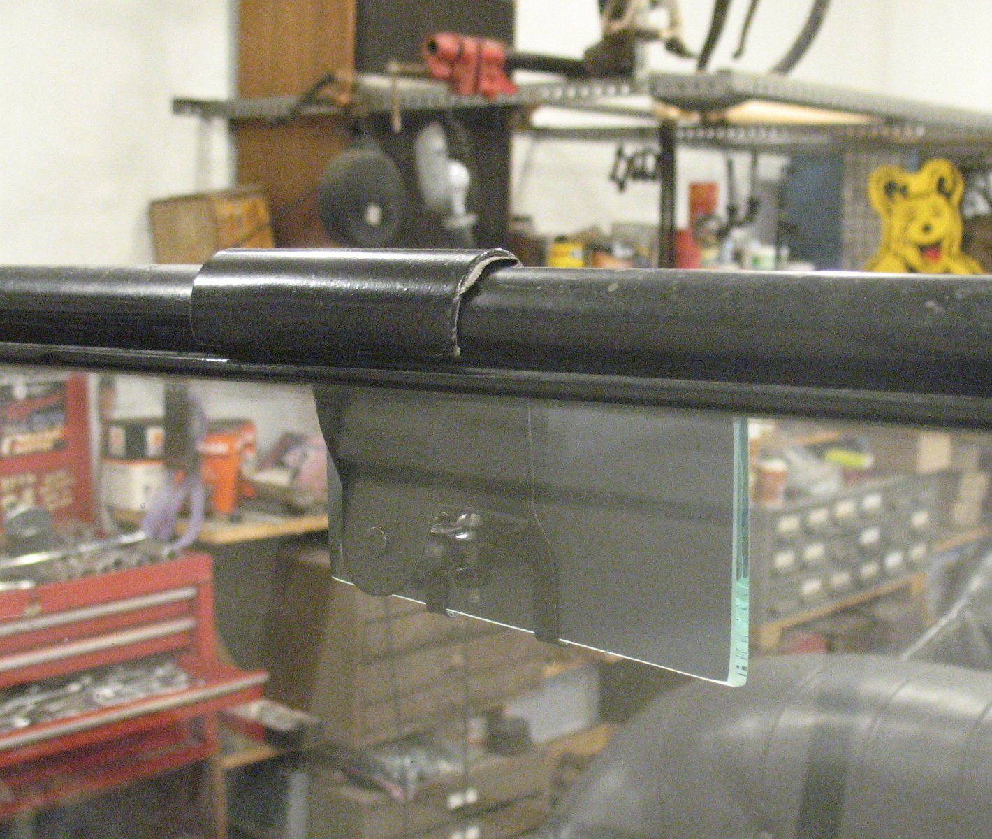

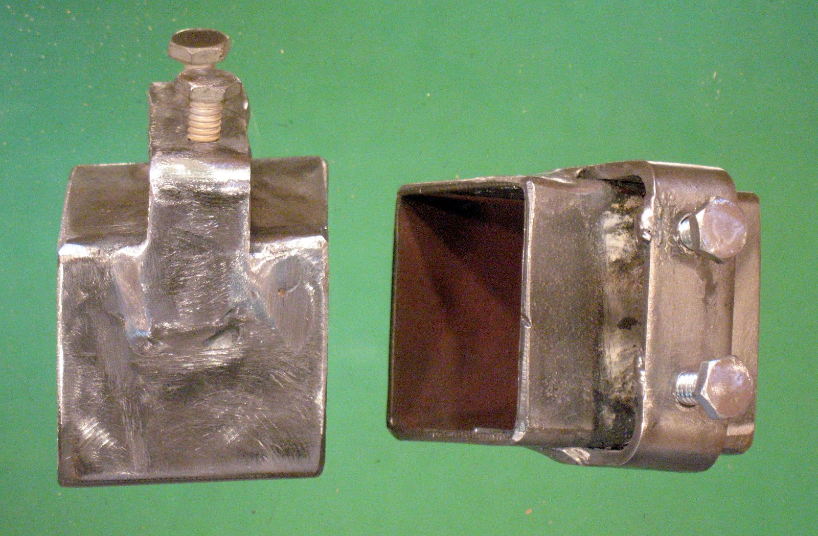

Post by ivaldes1 » Wed Apr 03, 2019 12:33 am
I like it Steve, but with bumps and travel might the handle work its way down and shut the gas off? Needs some sort of say zip tie loop to go around the end of the handle and keep it from sagging down and thus closing the gas?
Posts: 7393
Re: What have you done with your Model T in April?
Post by Steve Jelf » Wed Apr 03, 2019 12:54 am
This one seems stiff enough to stay put. But if it doesn't I'll add a spring catch like I did on the runabout.

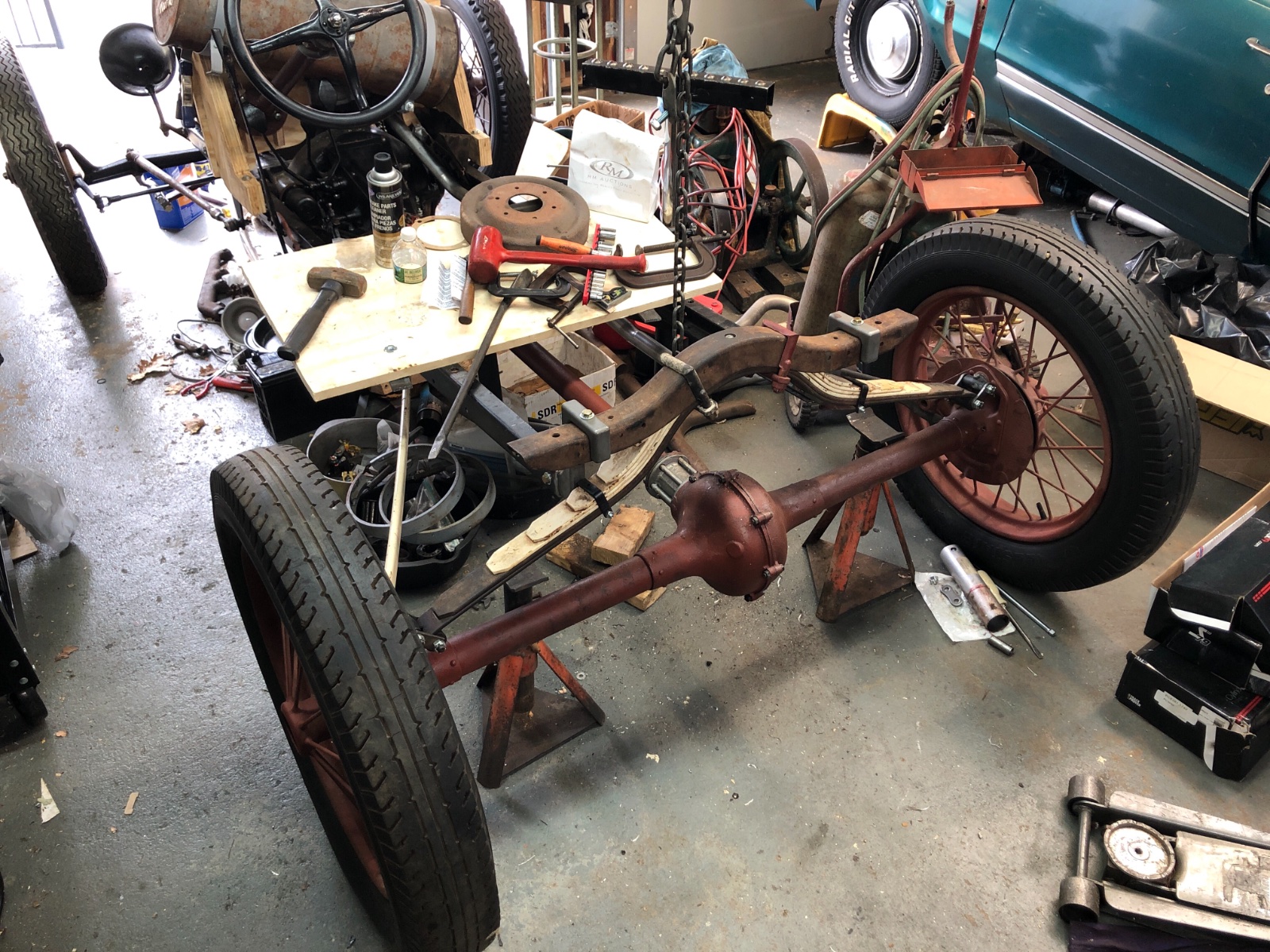

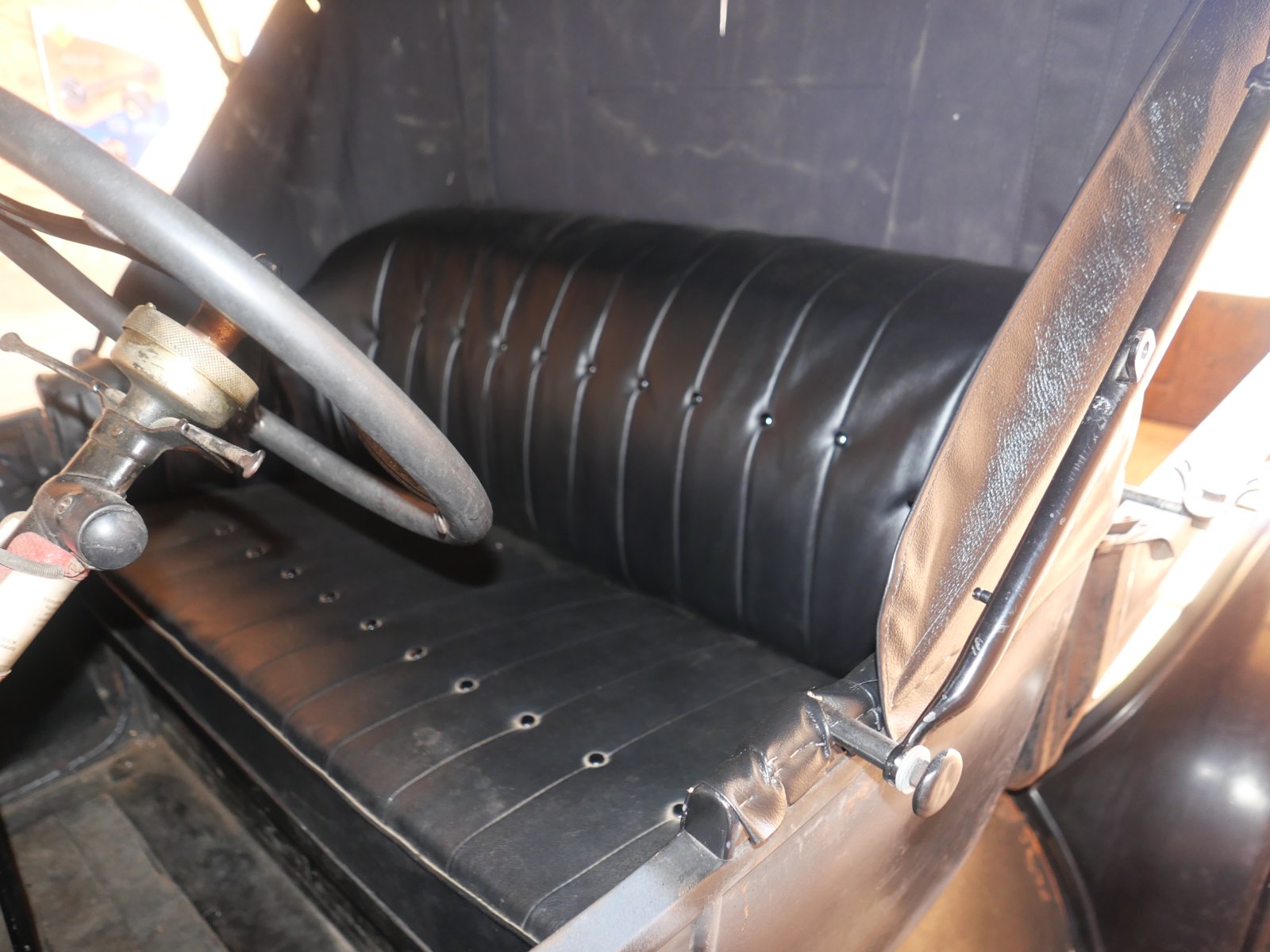

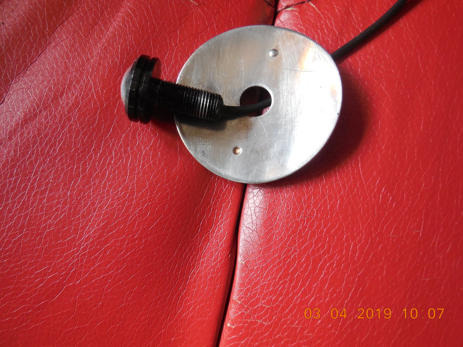

Currently, I'm slowly disassembling the Roadster seat assembly I bought at last January's Turlock Swap Meet. I believe the body section had been all original with remnants of original upholstery. It's really been a learning experience for me because I'm learning details of 1920 Roadster construction I didn't know before. This seat assembly appears to be from the time just after the switch to the oval gas tank and so the wood structure is different than what's shown on the Mel Miller drawings I'm using to reconstruct my car. The tool tray behind the tank is narrower to allow space for the wider oval tank. I'll have to convert my current pieced together body from round tank to oval tank to make it more appropriately like the 1921 which it should be. I also learned that the wooden strip going around the top edge of the seat is actually three sections reinforced with a sheet metal covering (3 sections of sheet metal reinforcement) along the back. I thought it was suppose to be a continuous steam bent 3/4 inch wood molding to nail upholstery to. It makes sense to have the sheet metal reinforcement because of the strain of the driver and passenger leaning back against the seat would need more resistance than just the 3/4 inch wood strip. Also I didn't know about the cardstock the factory used on the arm rest areas to smooth out the transitional step up caused by the use of the metal end caps. Great Model T construction fun and lots of tedious work ahead for me this April. Also this month I'm waiting on Lang's for my back ordered piston rings. I sent my engine out for machine work in February and am held up waiting for rings to come in.

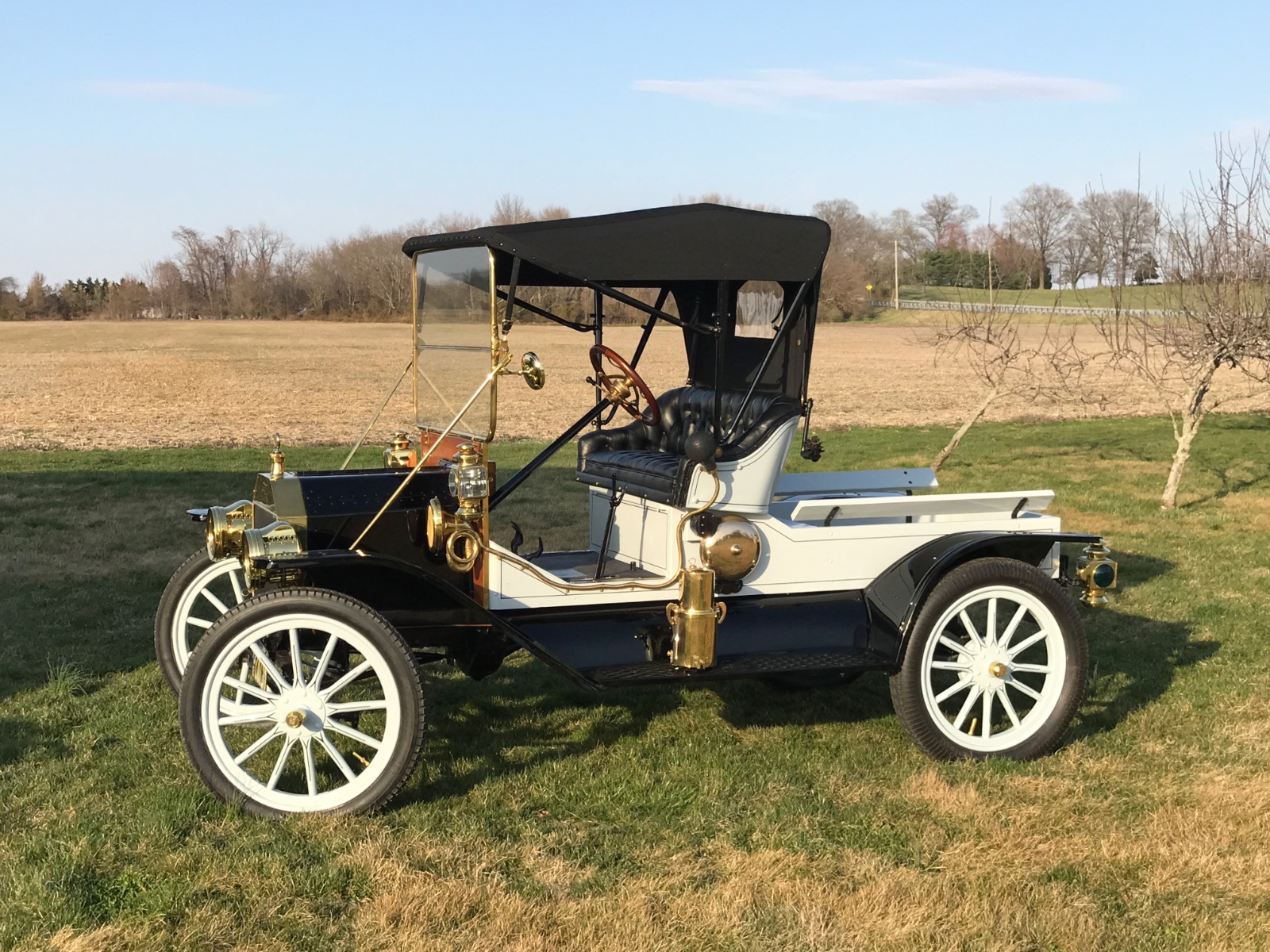

The Eyre T Torpedo looks like a car today.

My gosh Eric, that looks fantastic!

I have been following along with the progress on this car for 20 years. You would not believe how good it is in person.

Eric is correct on the 11 torpedo in the above post it has been apart since 1987. We took it apart to store it when I was 17. Next year I’ll be 50 and it was time to get it done. Life certainly gets in the way of the hobby sometimes. I’m not too computer savvy so Eric has been posting pictures as I get things done. Our hope is to have it completed for next year. It’s a closed valve twelve river rear end car. It was a pretty complete car and we did purchase repo fender and hood on it. I wish now I would have fixed the originals.

Post by Jem » Fri Apr 05, 2019 11:20 am

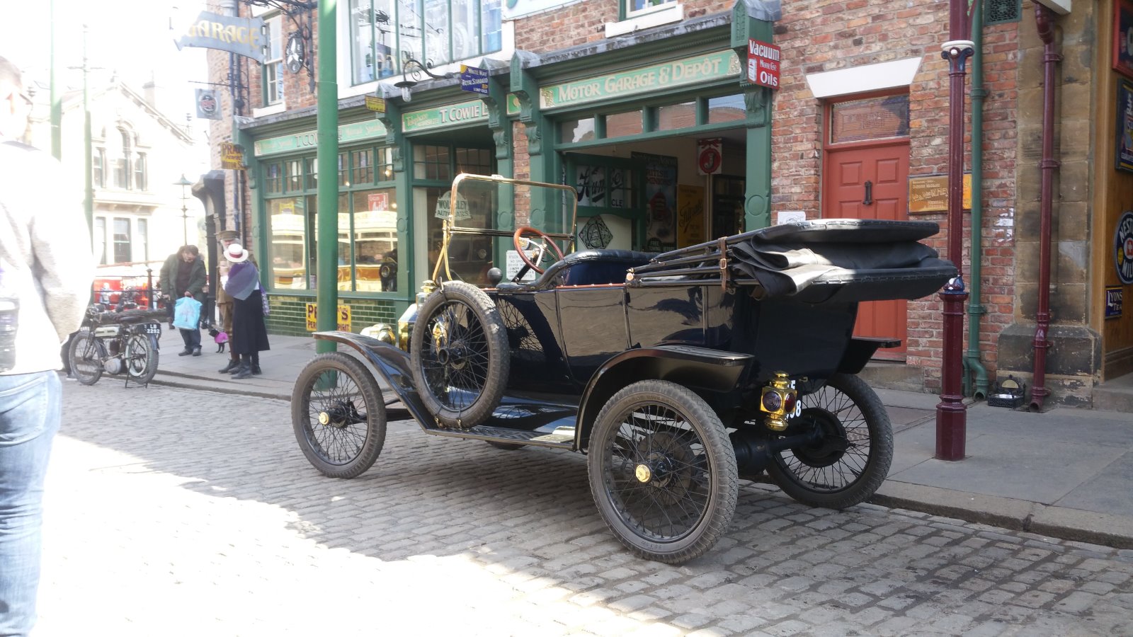

Art asked for more photos of my 09, here's a link to a 2018 post
http://www.mtfca.com/discus/messages/82 ... 1532436906

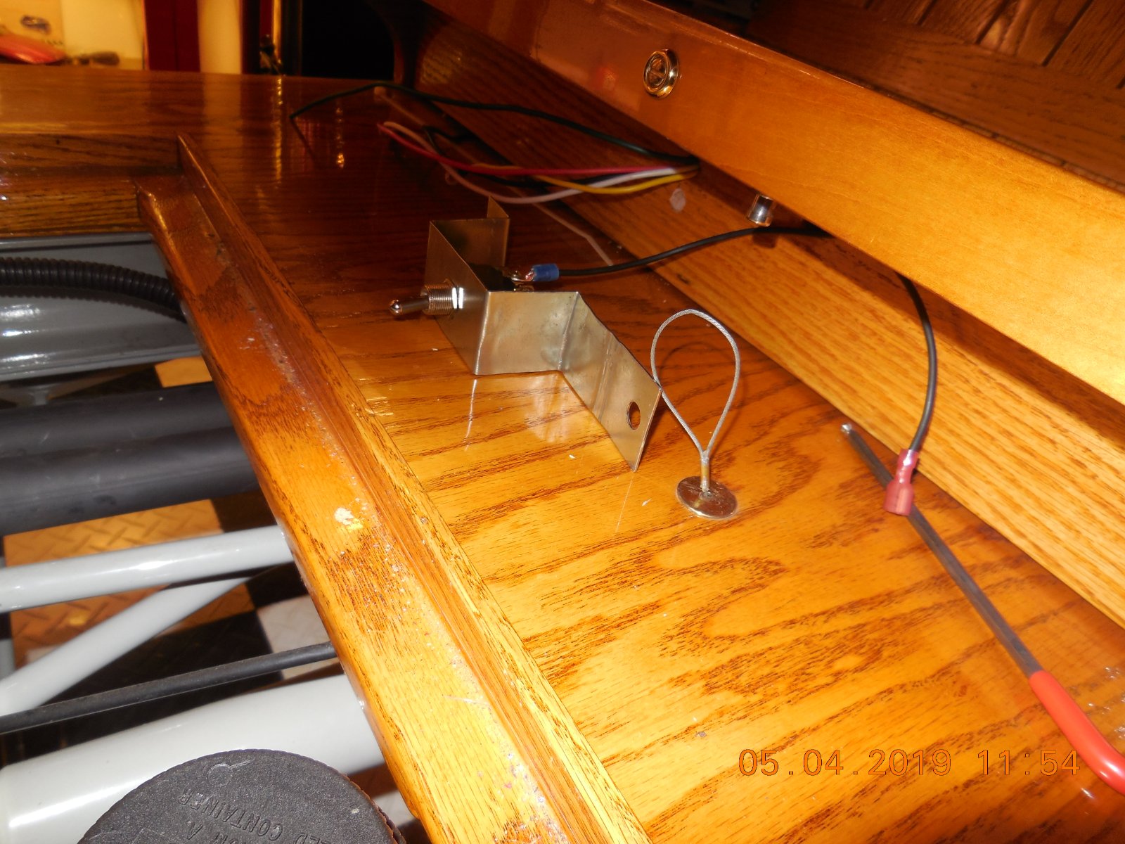

Post by Loftbed » Fri Apr 05, 2019 4:25 pm
The 13 Modern Speedster had turn signals installed when I got it, however the switch was below the dash in front of the passenger - very unhandy and also dangerous. I have now moved it to the seat riser under the seat and to the right of the driver a skosh, now it's easily activated with my right hand and I don't have to get all contorted as before.
Bracket I fabricated to mount the TS toggle. it gets attached to the seat riser.

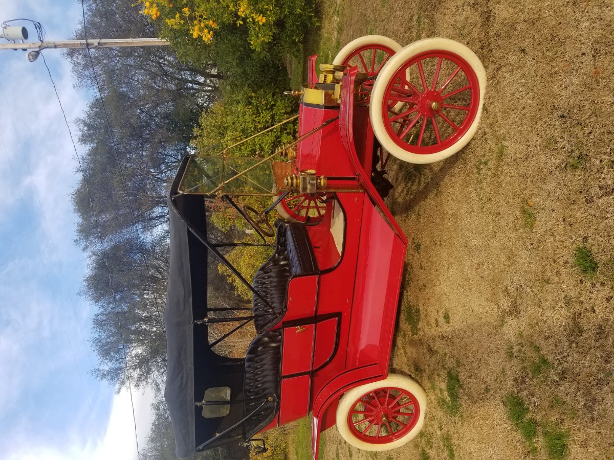

Post by Tbz4u » Fri Apr 05, 2019 11:44 pm
Ok i did take the1909 out for a ride! Unbelieveable in between Storms yea right been raining for days here . Anyway. Had problems with the coils and i new that rv Anderson had done these in 2002 well anyways i called him after numerous times tries because storms back east were bad. i got ahold id him told him he had done these he said send these to me, there under warranty. What. I insist i ll send to you and ill pay you, he said ok if its do to wear he will charge! WHO the hell warrantys something you never paid for right . Well he did i paid the shipping There and rebursed him for ride back on shipping all within 9 days id like to give him an applaud . R V. ANDERSON YOU GOT MY BUSSINESS I SEE YOUR IN THUS CAUSE YOU LOVE IT THANKS AND COILS WORK Great just ran the 1909

Post by Tbz4u » Fri Apr 05, 2019 11:46 pm
Sorry heres picture

Post by Dallas Landers » Sat Apr 06, 2019 1:18 pm
Installed outside oil line on the TT and the wire harness from Dave. Working on a front wheel to get it ready for paint. New tires arrived this week.

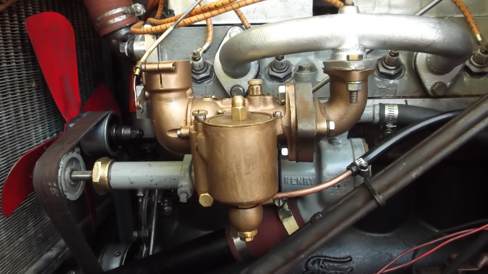

Post by JRSpada4 » Sat Apr 06, 2019 8:21 pm
I started early this morning doing my annual maintenance. Cleaned the timer, oil change, greased all the cups, etc. I finished up early afternoon and was able to finally get out for a little drive around town. I've been chomping at the bit to get out this year, but the weather hasn't been cooperative until this weekend.

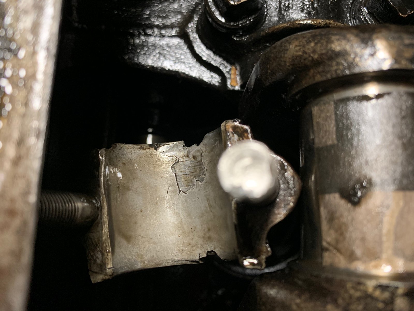

One step forward, two steps back. Been working on the 09 the last couple days to get ready to drive it all weekend. Got the toe in set and packed the front wheel bearings, removed the worthless oil sight gage from the side of the pan which stopped an oil leak from the vent hole in the top of it. You can not see the oil in the window under a dark car with dark oil and a black oil pan anyway. Fixed a few small items and reset the coils on the HCCT my wife found for me and then set up the spare coils that came with the car. Most were marked .8 amps 2013 but only 1 was still at .8 and the rest were all over the place and a couple were 1.3 and 1.4. I set them all at .8 and now the car idles all the way down and is smoother. After all this I noticed fewer free starts and thought maybe I need to play with the coils more but after a long day of driving we stopped for drinks and when I shut it off the switch felt loose and then would not work. After pulling it apart in the parking lot I found all the screws were loose inside and the switch had come apart inside. I fixed that and we decided to head for home but stopped by the house of someone my wife works with to give him a ride. The car was now starting much better and free starts were back so we felt it was ready to drive till I made a sudden stop for a light and found out the brakes worked better than most T's I have driven. Then the problems came. At the next light I hit the brakes and nothing happened! Lucky for me I had fixed the rear brakes the other day when I replaced the bad wheel and found a spring had come off after someone put lined brake shoes on the car so I pulled the leaver and stopped just over the white line with my front wheels. I was able to take him home with just the rear brakes but when I got home and pulled the cover to see what happened I noticed the Kevlar bands I was told the car had were cotton! Looks like I will be putting new Kevlar bands in before we can drive it again. Glad I found this before the tour in June. We put around 50 miles on the car and it would have been a long walk. Shake down runs are so much fun!

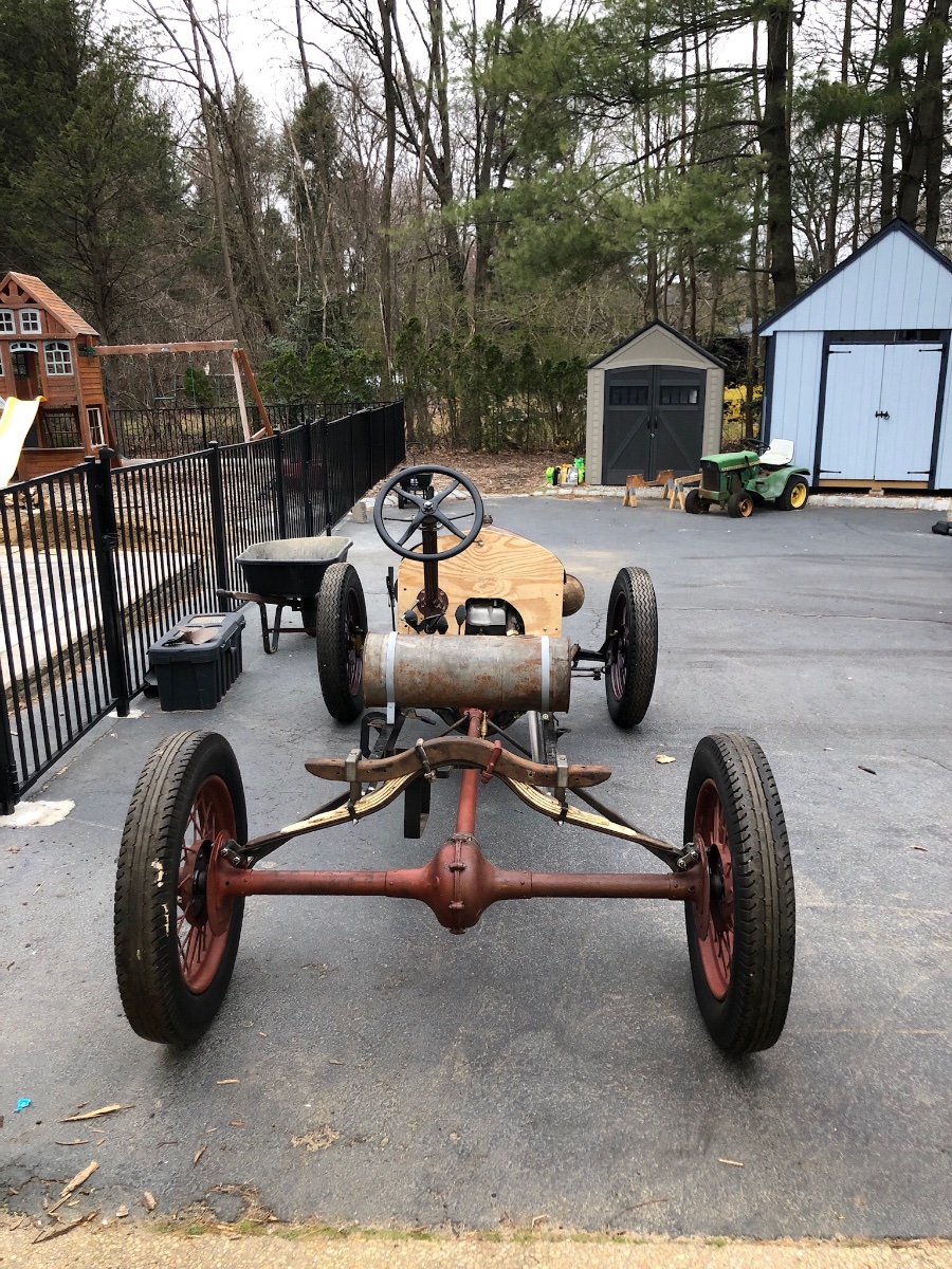

Post by Daniel828 » Mon Apr 08, 2019 4:49 pm

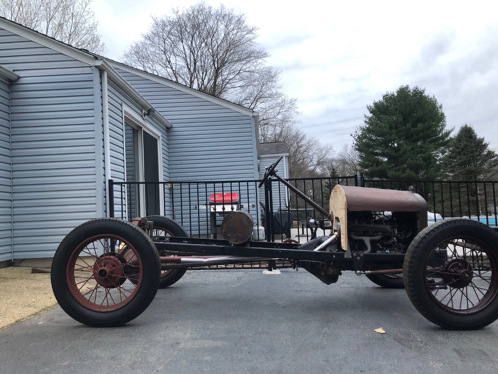

Ive gotten my speedster on the ground this just today.
Still lots of work to do but getting closer

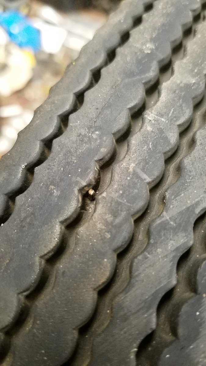

Who would think something so small could cause so much trouble? In any case I am coming back the other way on this job.
Nail in 26 tire
Nail in 26 tire

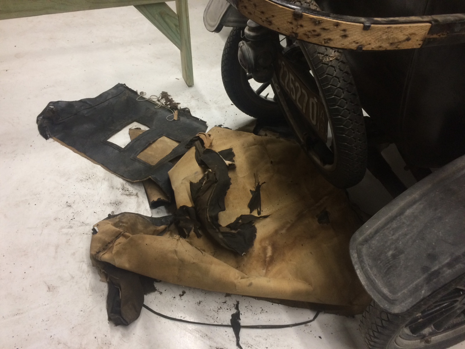

Post by D.Yoder » Sat Apr 13, 2019 12:52 am
Removed my 100 year old top

Post by Steve Jelf » Sat Apr 13, 2019 4:50 pm
I finished something today! A couple of somethings, in fact. Accessories to enhance the driving experience.
The first project was a pair of extensions that will allow me to back up without getting my big feet tangled in the pedals. Nobody will ever accuse me of being a skilled welder, but I don't think these will come apart.
This one is for the touring and the other will go in the runabout. I could have bought prettier ones for $60+, but these are from scraps and materials on hand for no cash expenditure.
The other improvement is this mirror for the touring. The cash spent on this was $2 for a new mirror, as the old one was pretty bad.
I found the original mounting hardware in my parts room, but there was no clamp to hold it on the window frame. So I made one from a piece of 1" conduit.
This should keep me informed if anybody is sneaking up on me from behind.

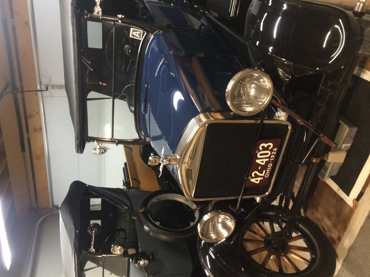

Post by Ruxstel24 » Sat Apr 13, 2019 9:58 pm
Found a fair to middling tire that will do for short trips. Not much tread, but not as cracked. The right rear, I discovered, has a split started by the bead, about 3" long !! :shock: Looking at some takeoffs Tuesday that hopefully will get me through the summer.
Went for a little spin and put a coat of wax on to get the water spots off.
Bill, another local T nut, stopped by with his 24 RPU. Beautiful car, he couldn't say enough about Joe Bell doing his engine, sounded great. :D
Like a moron, I didn't take a picture :roll:

My wife goes to a quilting romp with her Missouri girl friends every year in April.
This year I hauled my 25 pickup back and my friend Wayne Ringgenberg helped me put the seat back upholstery and top on.
He knowing what he was doing as opposed to me did most of the work.
We only had three days to complete the job and we are both over 80 years of age so I came home with some minor unskilled jobs left

I rolled my project out of the garage the other day for the first time ever. This car was made from parts acquired from friends and visits to Hershey
It was going to be a speedster but I’m changing direction and I’m going to build a depot hack body for it

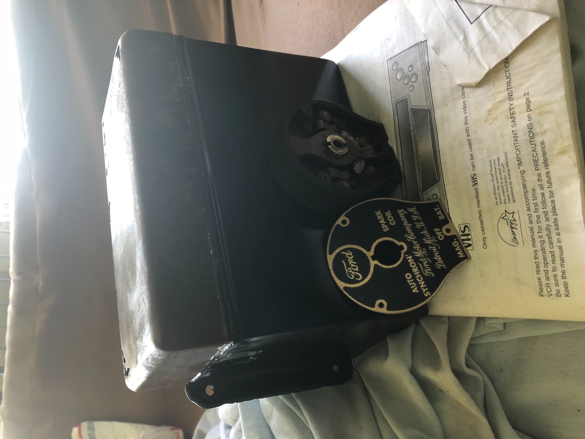

I finished my 14 coil box good enough that I can put it back on. I need to finish the top and get the latches plated, I was thinking about getting a Caswell kit because the bolts that hold it on, I know what they look like and can make some but I think they should be brass plated too along with other odds and ends. My 14 box was stressed and rusted and the corners split. I bent a piece of round rod and welded in the corners in the bead for strength then filed them flat. I clamped aluminum angle inside and welded up the corners and patched a couple holes. I’ve had the box from my 21 on my 14 so I put it back today. Haven’t started it in 6 or 8 months but it started right up.

Went to Bill's and got a couple pics of his 2 Ts.
From there to a lady close by and got a couple decent used Firestones, a USA tube and a Ruckstell shifter.
Ordered a couple new tubes, but found another USA tube in my old tire and took a chance...holding so far !! Tomorrow I may try the other tube, I have a bare rim.
The old tire was a little unnerving ! :shock:

Post by JEC » Tue Apr 16, 2019 9:06 pm
I am replacing my rotten tires and while I have them off am refinishing the wheels.

The Eyre Torpedo continues to make steady progress. The side lamps and top bows are now in place. Meanwhile Gord Koll finished my replacement dadh for my '13 Touring. It's a work of art.
Eyre Torpedo top bows

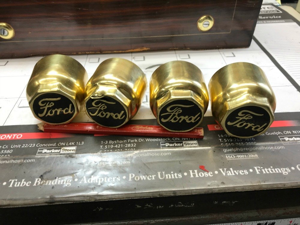

Painted my hubcaps for my '13

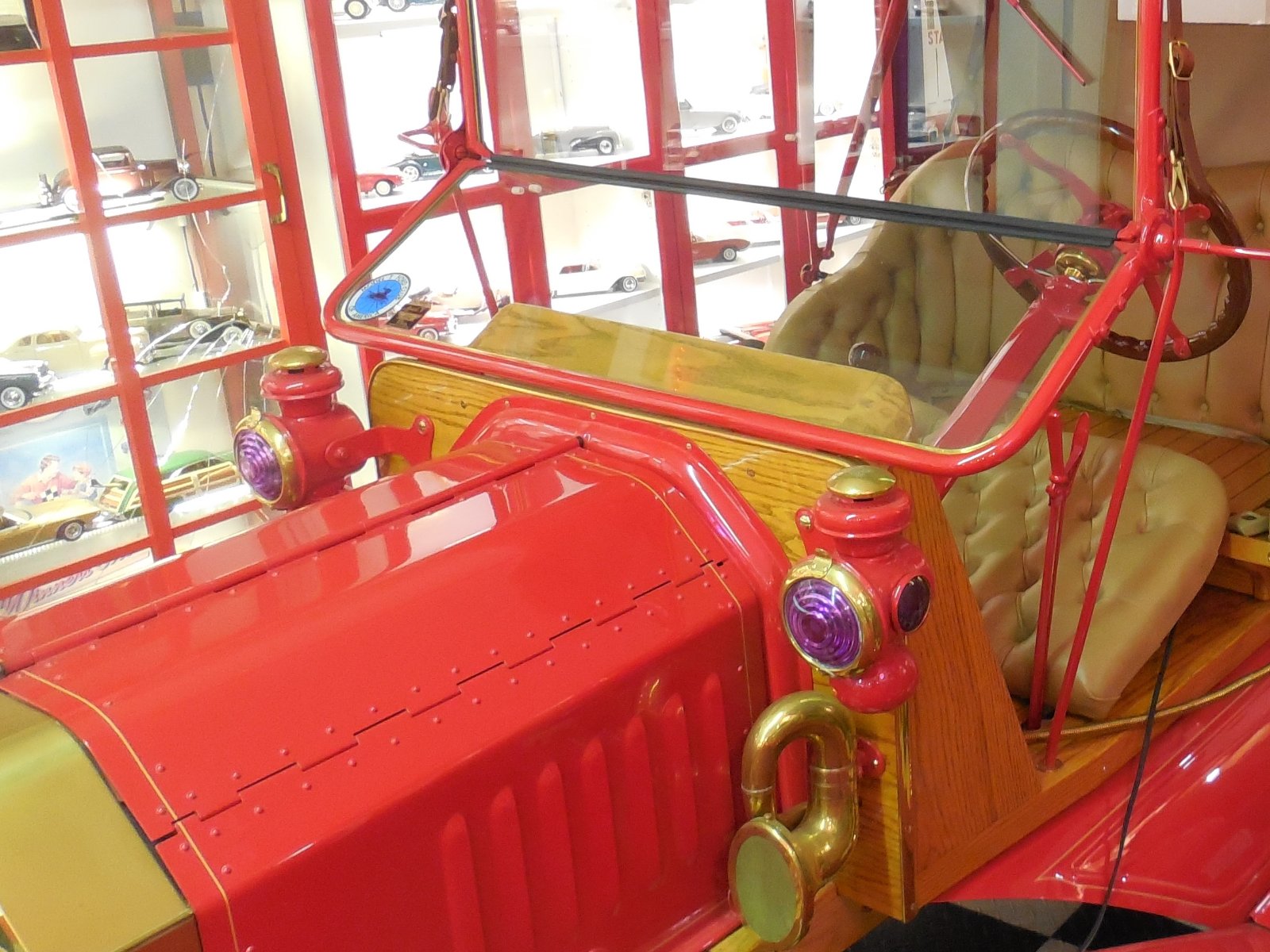

Drove Isabel to Cars & Coffee yesterday, spent most of my time explaining how oil lamps work!!

Post by Mark Gregush » Mon Apr 22, 2019 11:55 am
Re"The Bendix cover screws were shot like everything else when we got the car and I tried to replace them with stainless but the screws were too tight. So, I tapped/re-threaded the holes to 1/4" not knowing that they were #14."
Unless someone in the past has messed with the cover screw, they are smaller then 1/4" or #14. The thread is an interference type and the screws are closer to metric.
I decided that after all the work putting the Chevrolet overhead on my 21 that I was going to keep it. I put new rings in and took up the rods a bit. Because you are using 7/16 bolts in 1/2"+ holes it gives a lot of latitude to where the head sits so this time I installed locating pins where I wanted it to sit. The holes were a bit bigger then the pins I used but they are only there to located to install not keep it from moving later
I also decided to replace the valve springs. Took a bit of searching thru the SBi catalog but found some that were withing the ballpark. To get the compression at working height I added shims at the top, no room at the bottom. Didn't want something too strong because A the cam is not that strong and B didn't want to break the rocker arms.
I also plugged the unused rear water passage, took a little more off where the plate meets the block at the fire ring. And yes I am after coating very well with copper coat am reusing the two head gaskets.

Post by Steve Jelf » Tue Apr 23, 2019 11:03 pm
Stuck indoors on a rainy day, I installed the spare carrier on my 1923 touring and mounted a spare tire. Little by little I'm getting the car ready to make some trips.

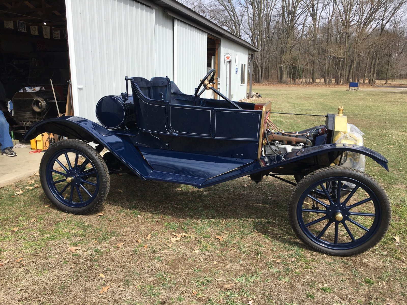

I finished my Speedster build.
Well, finished it enough to be able to drive it, register it and put licence plates on it for the first time.

Post by John E. Guitar » Wed Apr 24, 2019 2:19 am
I discovered my third conrod needs a birthday.

Post by Dallas Landers » Wed Apr 24, 2019 12:15 pm
Well I worked on the 8in1 bed and its ready for final paint
Then I done a compression test on the RPU and found #3 at zero. Pulled the head and decided new valves and tappets are in order
I finished the front wheels for the TT last night. Sorry I didnt take a photo, it was late.
After the wheels I started removing all the harware on the tailgate for the 8in1 to replace a couple boards so I can paint it with the bed. Whew, Im beat!

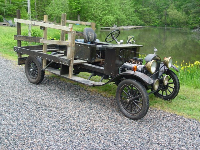

Post by Tom Hicks » Wed Apr 24, 2019 3:28 pm
I drove Ellie Mae up to Home Depot and three people commented that she looked like the Beverly HIllbilly's truck. She really doesn't, but since that is my goal it really gave me a boost. Can't wait to get the bed sides on and the rocking chair in the back!

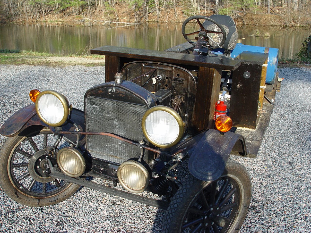

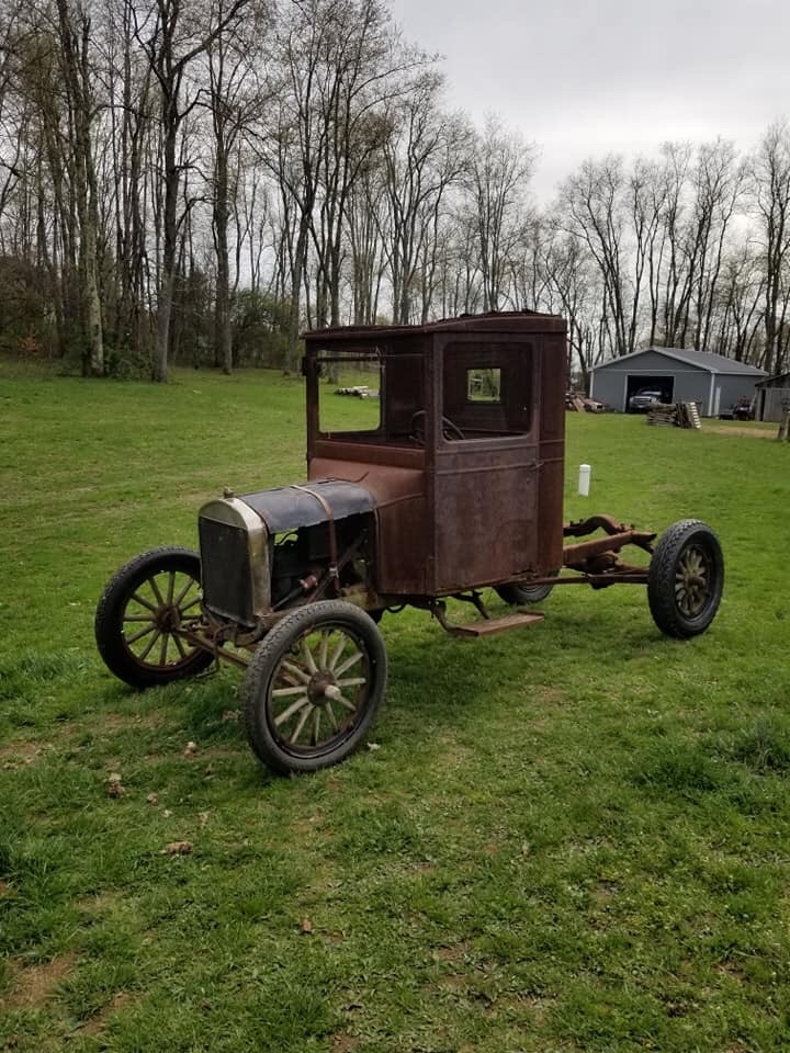

Post by mvweaver » Wed Apr 24, 2019 9:29 pm
Well thought I had my 20 yr project sold to a fella in NJ and then the tax man hit him. So, I decided I better go ahead and get it running again. Swapped out the incorrect low radiator for a high radiator and dinged up nickel shell. Mounted the rebuilt carb I bought from Tom Strickland last year at the Marietta swap meet. Ordered a fuel shutoff valve, fuel line, packing and pack nuts from Snyder’s. Got them and got the cab laid back to put the fuel tank in. Started to mount the Ruxtell shifter but didn’t have the right hardware, so got that sorted but not mounted yet. Hope to fire it up this week for the first time in about 10yrs. Cab’s gonna need some love before I mount the bed. It’s either getting my Anthony Autorocker or the original flatbed. Here’s a few pics.

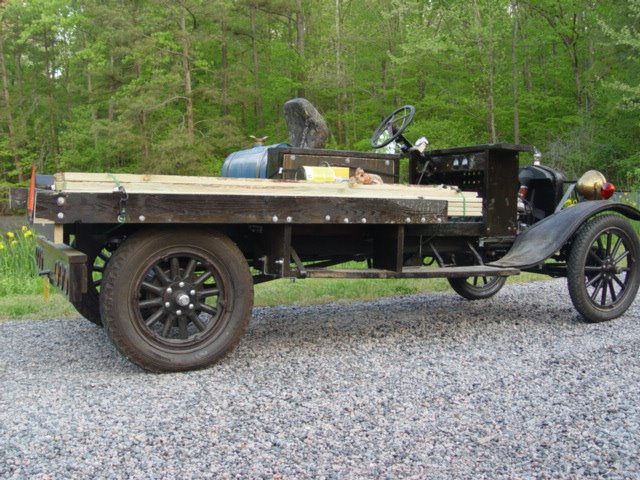

Post by Tom Hicks » Thu Apr 25, 2019 6:54 am
I have started making Ellie Mae's bed. Hope she likes it! All of her wood is salt treated, then I put a penetrating stain on it, she is an outdoors type of girl. The outside frame is done, the actual bed won't take long. The sides are going to take a while, they have to be strong so passengers can push/pull them, but none of the stakes or rails can be straight, level, or plumb. That is where Jed's real carpentry skills will show and I think it will give the truck the Beverly Hills look I am after.

Post by Tom Hicks » Fri Apr 26, 2019 8:52 am
I was busy last night! Next I have to make a removable gate for the back. Passenger access to the rear is across where the passenger seat should be.
I hope I am making Jed proud!

Made seat covers for the 100 year old seats.
Covered the 100 year old holy material
