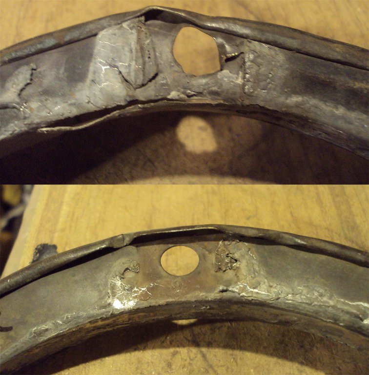

Post by Rich Eagle » Mon Mar 21, 2022 2:15 pm
In addition, I found this bottom flange with solder remaining where spacers were removed.

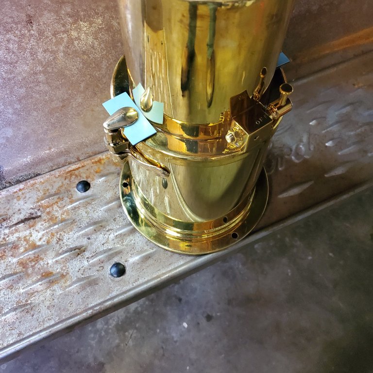

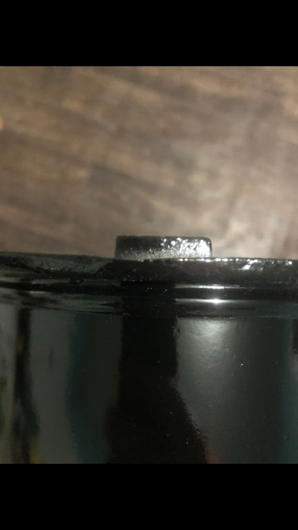

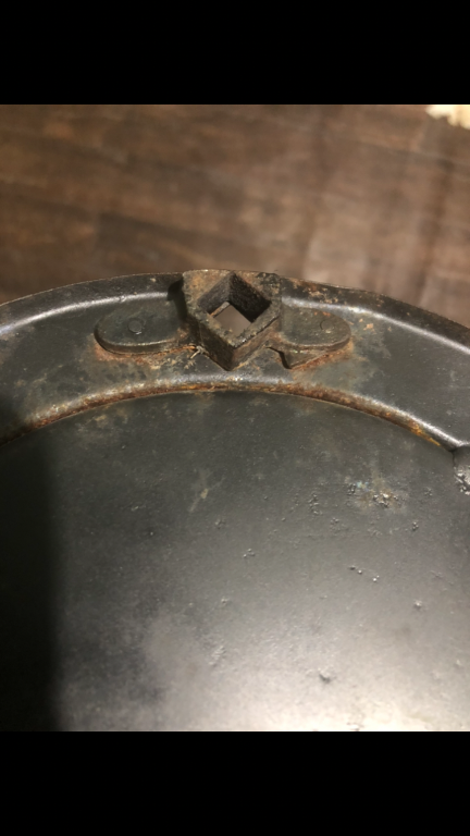

Post by Corey Walker » Tue Mar 22, 2022 12:47 pm
This later model black as me brass generator has spacers riveted on. It sits, as yours does, on top of the outer ridge of the running board. I read on here before that they are designed to sit raised above the surface to allow air underneath for cooling.

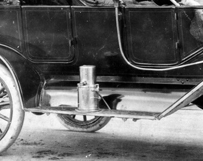

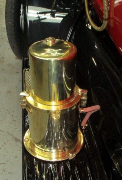

Post by John Heaman » Tue Mar 22, 2022 4:02 pm
My guess is when carbide generators were installed during production, they weren't worried if the mounting base hung over the running board or not. I also doubt that spacers were used either. Having said that, although my generator's base isn't a larger diameter than the ridges on my running boards, I did use spacers of a material that doesn't attract or hold moisture. Since the base had round mounting holes and not square I did not use carriage bolts plus I don't see slot heads as unsightly.
The photo below is of a Canadian built '12 exported to New Zealand. (so it's not a reversed photo)
This is a picture of an American built '12's generator.

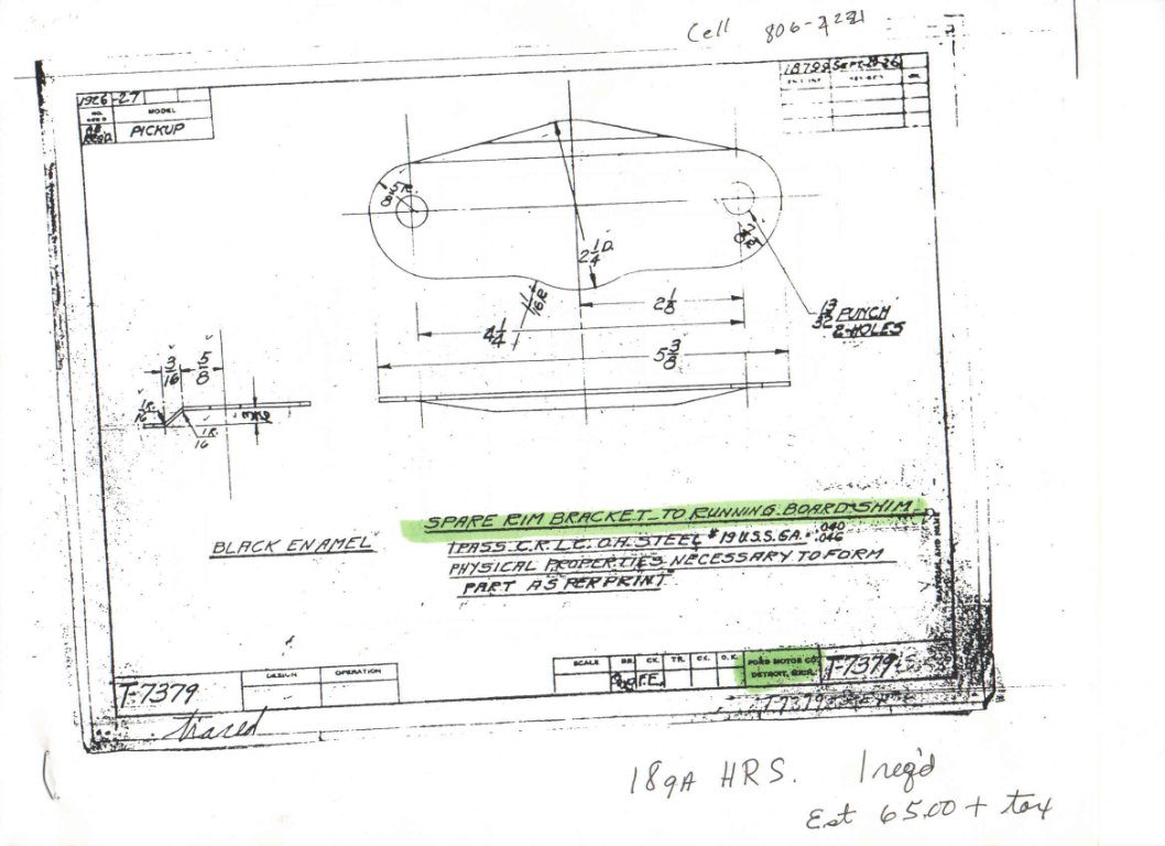

Post by Ron Patterson » Sat Mar 26, 2022 9:04 am
Richard

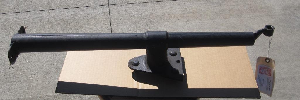

A similar situation occurred when Ford introduced the spare tire carrier for the 1926 Roadster pickup spare tire carrier.
Attached is a photo of this part.
The problem was how to support the spare tire carrier base to the embossed ridges on the uneven running board surface.
A simple flat shim was developed and mounted between the carrier base and the running board.
See attached photo.
I think you on the right track with a appropriately shaped round shim between the base of the generator and the running board uneven surface.
Ron Patterson
