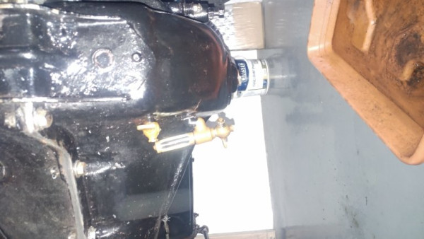

BTW your picture's oil level is not correct. The oil level is well above the bottom of the bands @ rest.

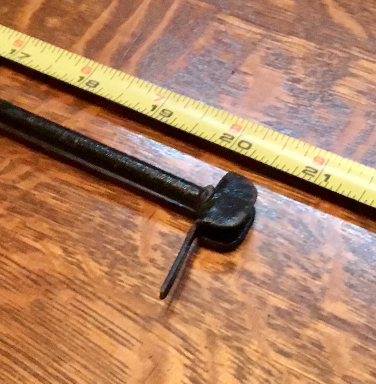

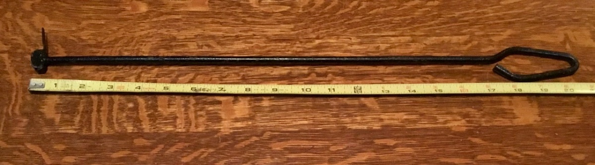

Some of the early accessory oil check sticks have a wire about two inches long that swings around to push the dirt out of those oil drain holes.
Others have marks for the gas tank fill levels.

I've got a larger one that has a cork and plate in it. Coming off the bottom is a wire to the magneto. IF you run low on oil the cork will drop the plate touches and the magneto is grounded out stopping the car preventing you from killing your engine. Never used it because then I would have to put a magneto back in the car . . .

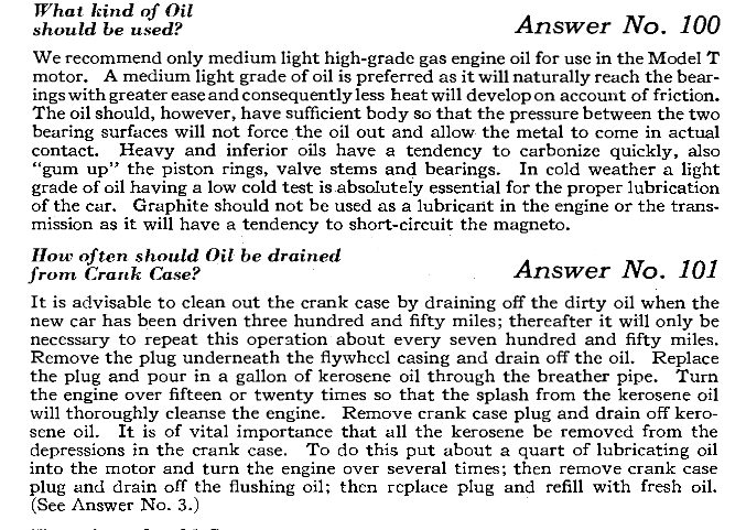

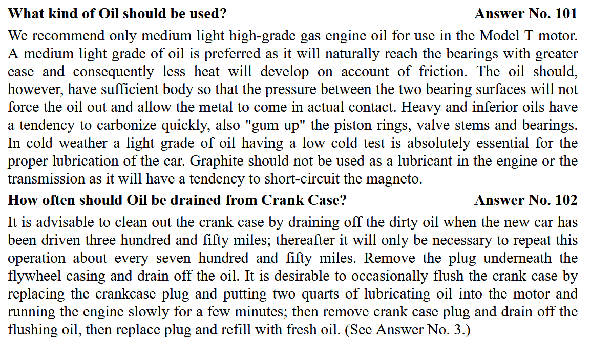

1925 Ford Owners Manual on -Engine Oil maintenance - http://www.cimorelli.com/mtdl/1925/1925manual.pdf
Moxie26
- Posts: 2039
- First Name: Robert
- Last Name: Jablonski
- Location: New Jersey
Re: Oil capacity for the Model T engine.
What year copyright is that from?
- Posts: 6555
The one above was from a 1925 Owners Manual http://www.cimorelli.com/mtdl/1925/1925manual.pdf
The 1926 manual says to use oil instead of kerosene
date 0f 1925 (12/1/1924 The one below is from the 1926 Owners Manual as a reference in the MTFCA Library https://www.mtfca.com/books/1926Inst.htm

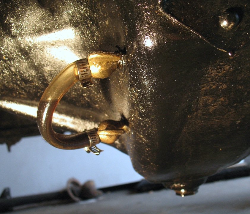

I don't care whether it takes 3¾ quarts or four quarts. I just fill until the oil reaches the top petcock.
I agree with John that a sight gauge can easily give a false reading and make you think that no oil is plenty of oil. Even worse is that it replaces the bottom petcock, so that if the gauge gets knocked off or broken you lose your oil. This is not good.
This is the oil sight tube Mark mentioned. Open the petcocks to check the level, then close them. If the tube gets knocked off, no harm done.

jiminbartow
Topic author - Posts: 2473
- Last Name: Patrick
- Location: Bartow, FL
Earlier, Jim Golden mentioned a measuring stick equipped with a wire to clean out a plugged petcock drain hole. That reminded me of an original Model T combination tool that I found in the trunk of my ‘26 coupe when I bought it in 1970. A 20.5” long petcock opening tool with a 1” long poker that is used to clean out a clogged petcock hole. This is very handy for opening the petcocks without having to crawl under the car. Jim Patrick
