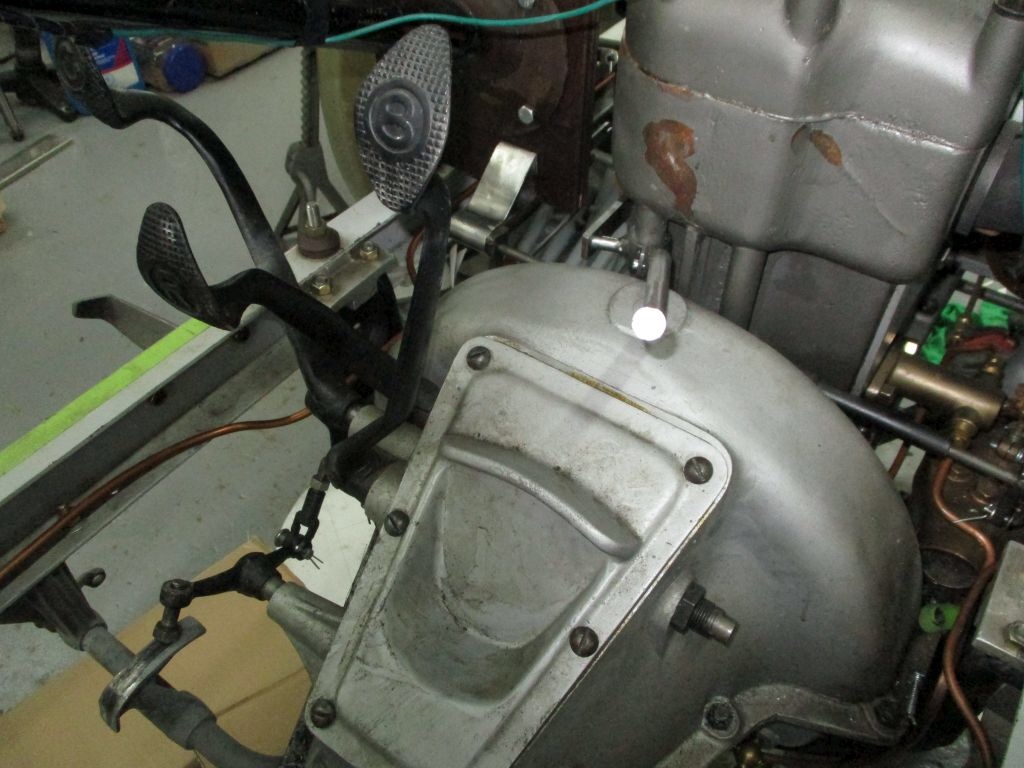

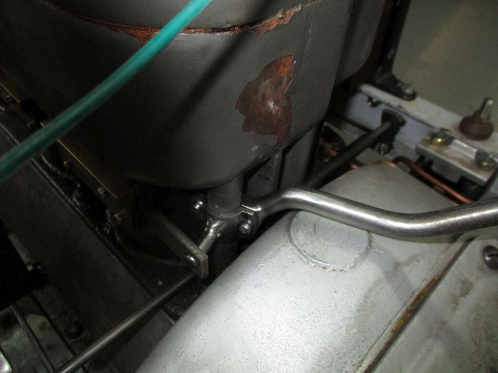

Peter and the guys are coming along with the Ford Special racer. Just received pics of the auxiliary exhaust ports sliding rail and foot control (to the right of the steering column in the first pic):

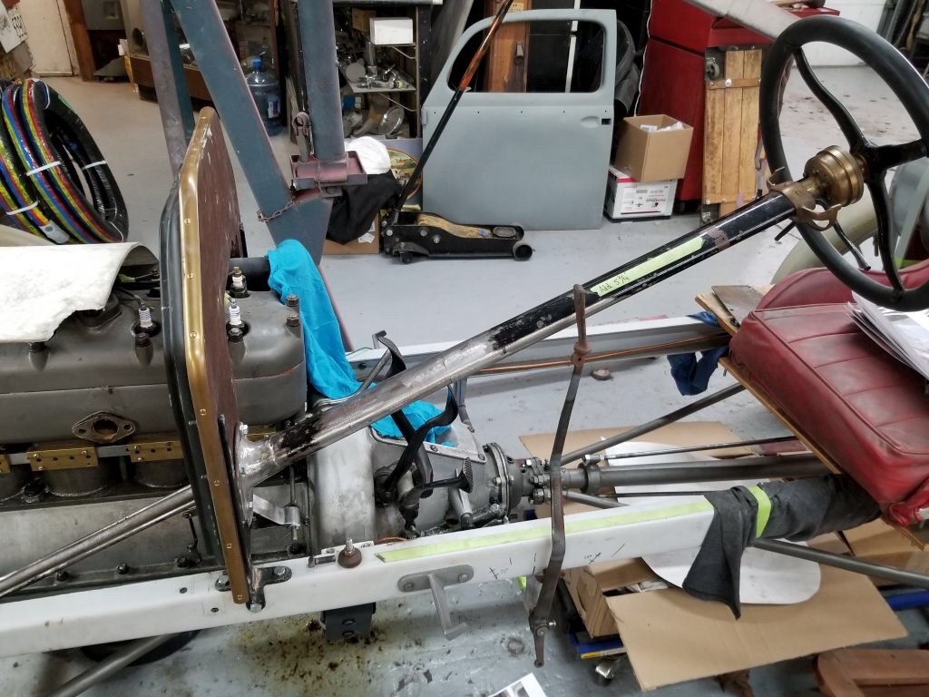

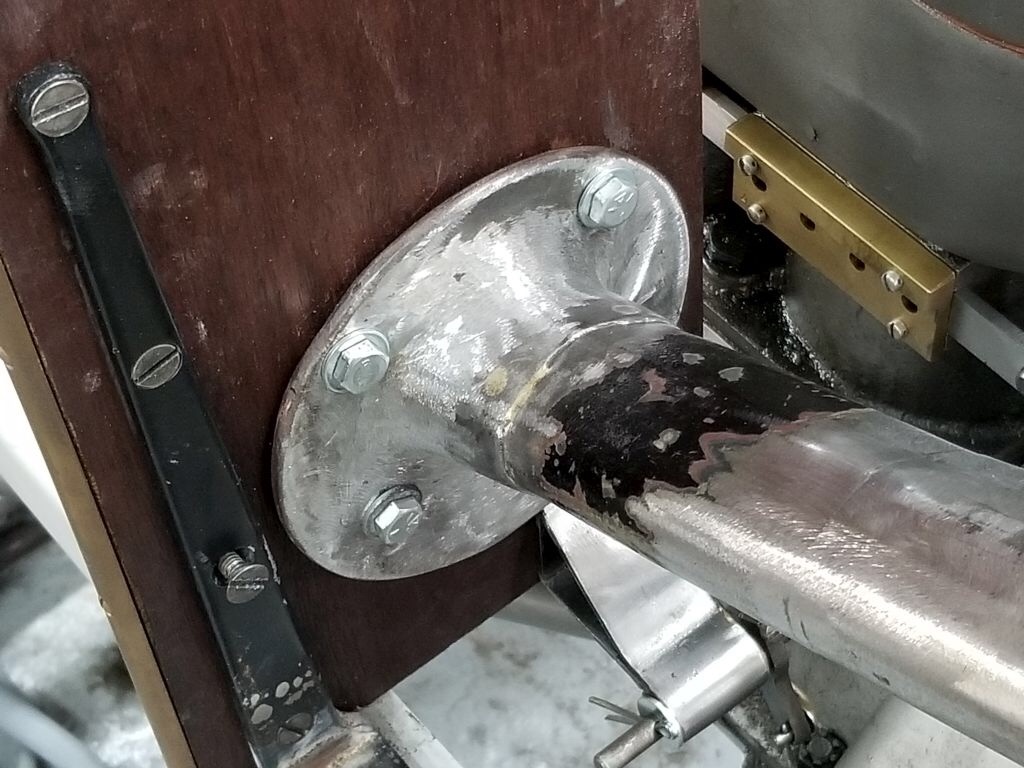

Pedal and brake/high handle are almost bent and extended into place, and the steering column has been extended:
The way it'll look from the passenger seat:
