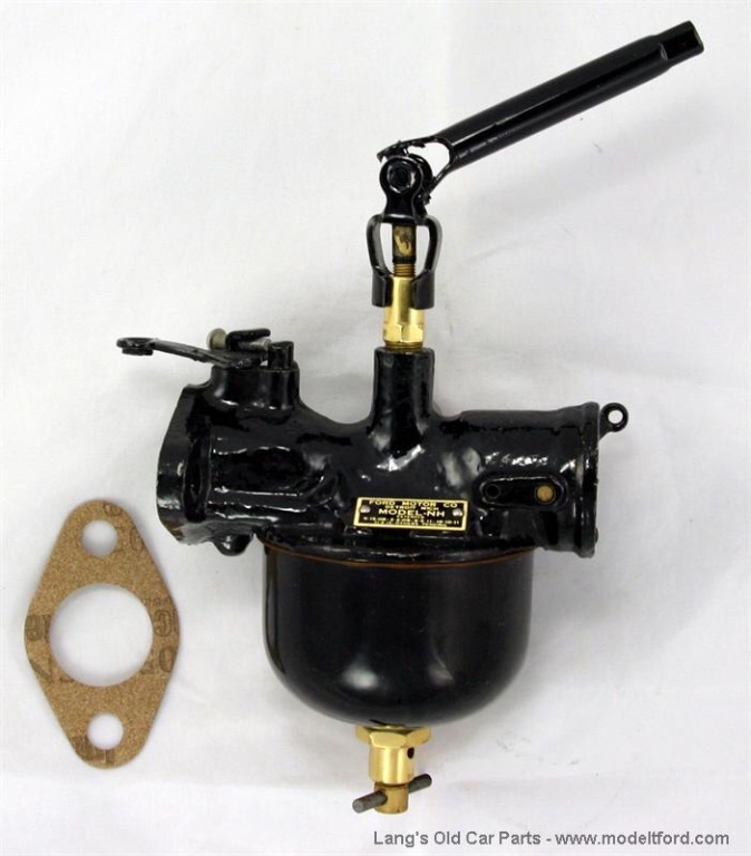

I am changing from a vaporizer to a NH carb on my 1927 coupe. What carb adjusting/choke assembly do I need?

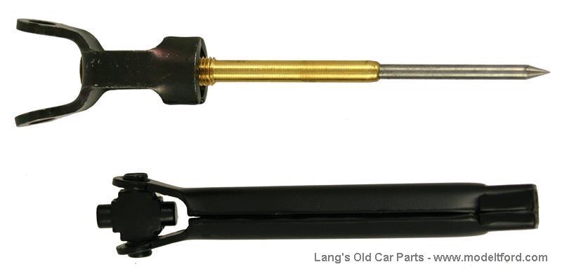

You need the later version of the carb needle valve.

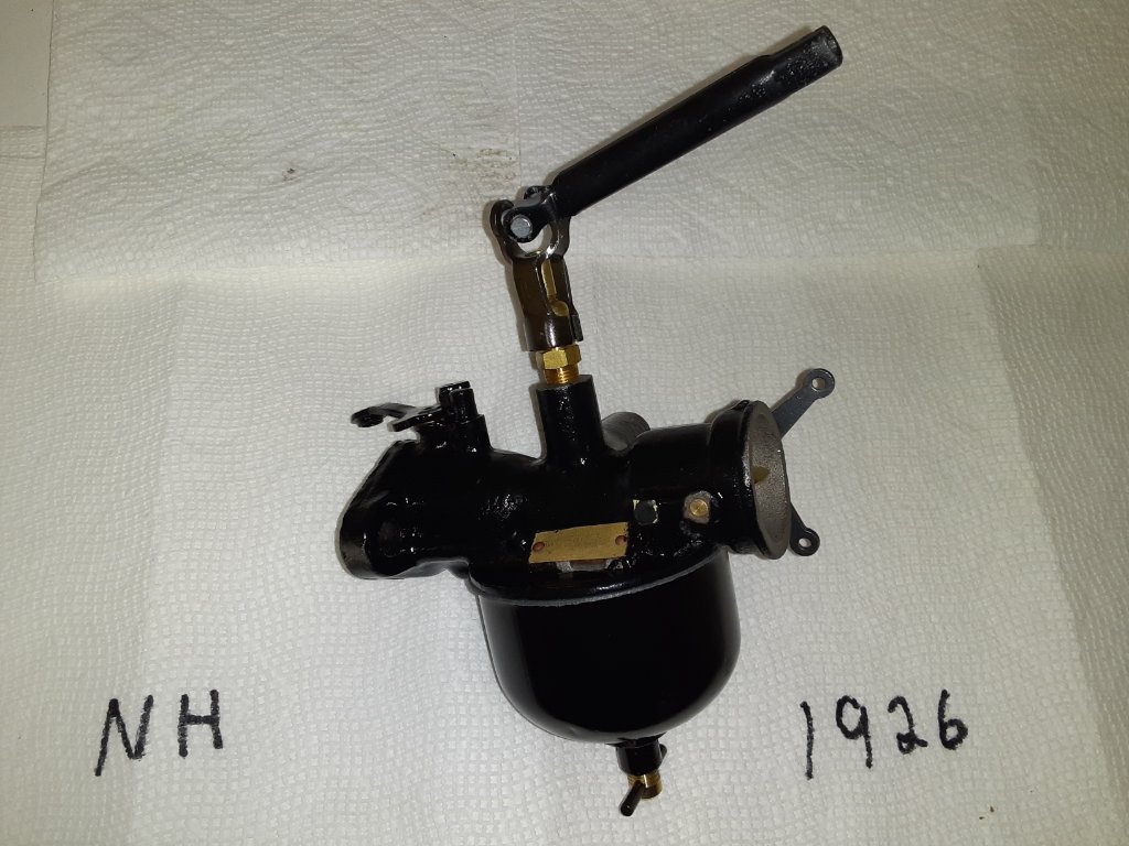

Les, Yes, that second photo is before I rebuilt the carb. I do have the needle valve you refer to.

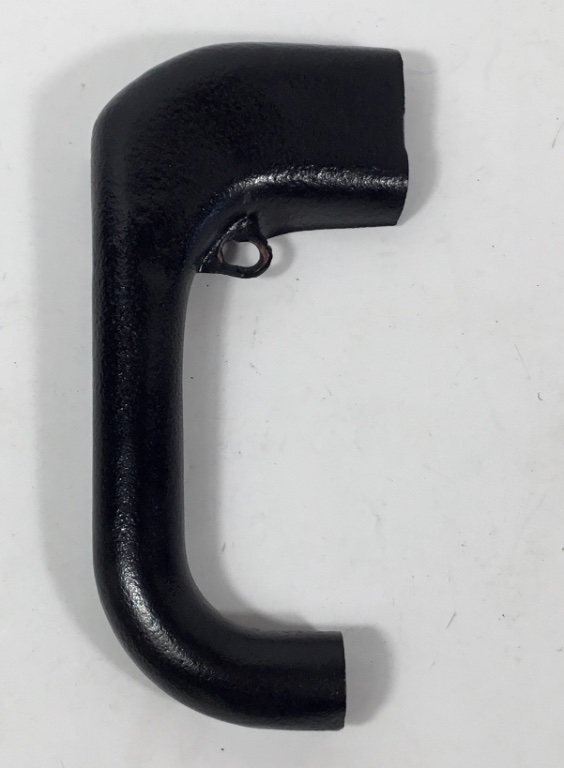

Good choice to change over to the NH. Do you have a hot air pipe? Jim

Jim, I don't have a hot air pipe.
Here is a photo of the rebuild carb.

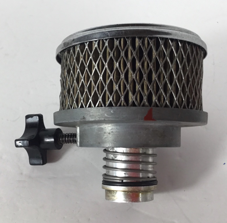

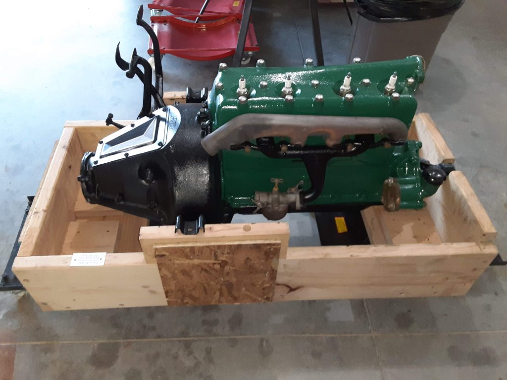

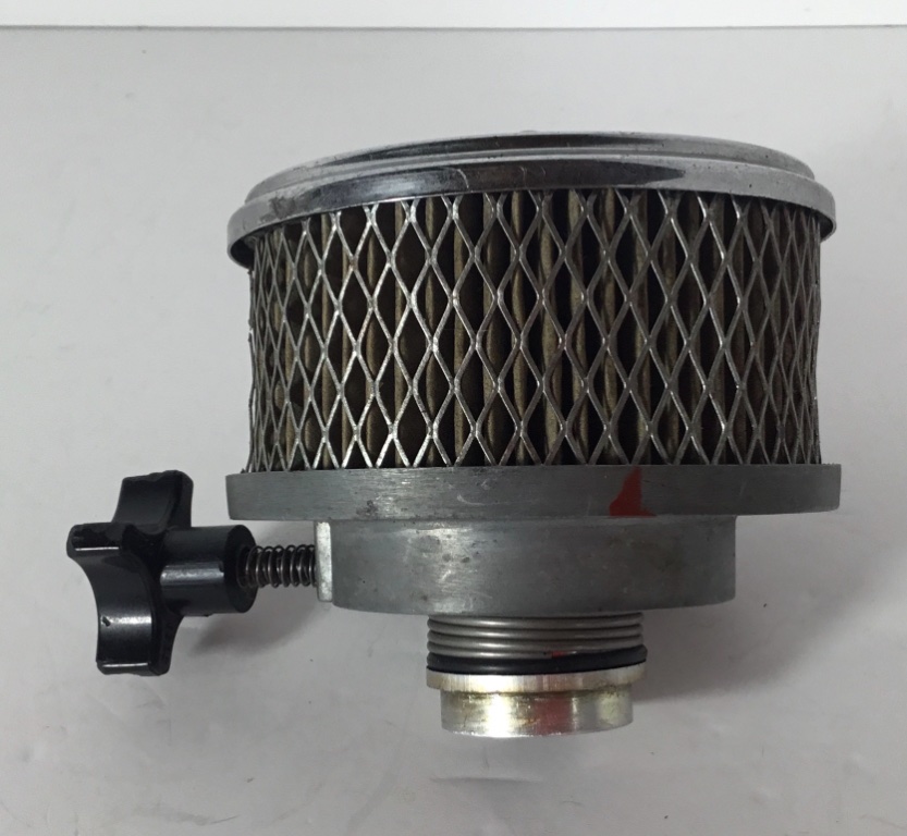

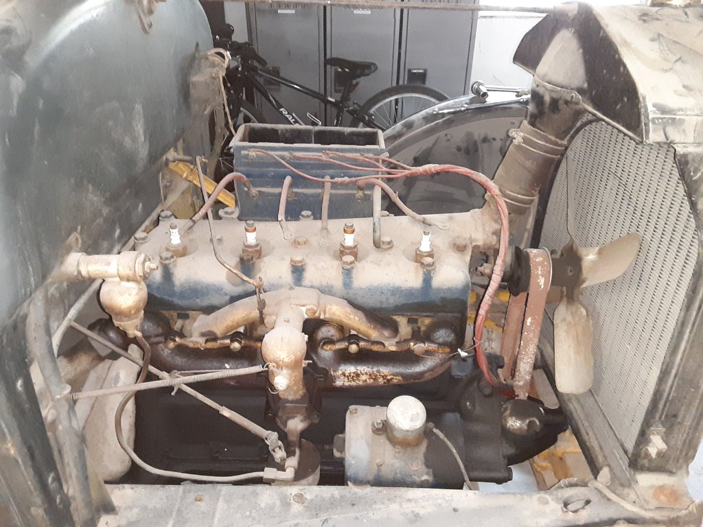

I am selling the one shown in the picture on eBay that goes to a 1926-‘27 Model T equipped with an NH carb (item #1153074834485). You can see how it is installed in the picture of my engine. It directs pre-heated hot air from the exhaust manifold into the carb and makes the engine run more efficiently, especially during colder weather. Or, another option is to install an air filter, one of which I am also selling on eBay (item 115307494878). While looking on eBay, check out the other items I have for sale. All will fit the 1927-‘27 Model T. Parts are difficult to get now so these parts are available now at lower than retail prices. Jim Patrick.

It will run with or without the hot air pipe. The pipe will keep it from icing up if that is a problem in your area.
