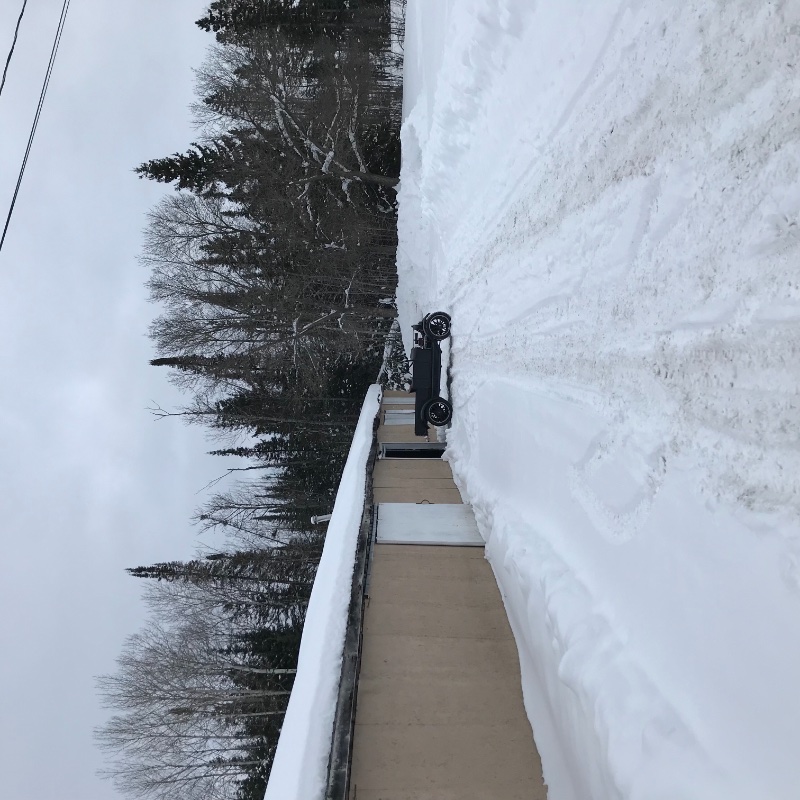

Wife and I bought a new house and now I’m having to move my T in the middle of January in a place north of Minnesota, so suffice to say it’s cold. My plan is to just drive the T over since it’s only about a two mile trip and the roads here are pretty well maintained considering the climate.
Right now my T sits in an unheated garage with SAE30 oil in the engine. It takes both hands to turn the crank even with a back wheel off the ground and as such, there’s no way it’s starting as it sits right now. What do you guys think I should do to get it going? I was thinking of draining the oil and replenishing it with 10W30 or maybe 5W30 that I’ll pre-heat in the house by wrapping the bottle in an electric blanket. Think that would be enough? How do the snowmobile guys do it?
Once my T is at the new place it’s going into a heated garage where this will never be a problem again.

Well this might be really disappointing but all I did was wait for a milder day. There was no pre-heat, oil change, towing or anything. All I did was another half turn richer on the carb which I took back off again as it warmed, as one often does. It was a nicer day so I just gave it a shot before trying anything else. The T is in my new garage safe and sound!
Lesson learned: when parked in neutral, SAE30 is basically glue at -19*C (-2*F) but limber enough to start by crank with all wheels on the ground at -2*C (28*F). This is with Ford’s original all steel clutch pack too. I say that as a data point, not to rub it in anyone’s face.
