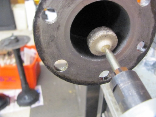

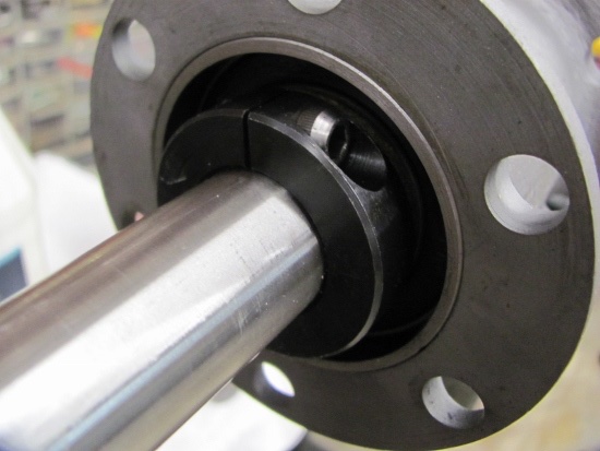

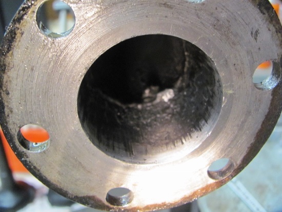

Might not be part of your issue, but having installed several modern pinion bearings, had to check and re-check any interference of the locking collar.
On some driveshaft tubes, there are spuds of weld that can strike the locking collar set screw. At times had to grind smooth the inner tube at that depth spot, and at times had to trim the edge of the exposed set screw to be sure of no contact. Simple thing, but that collar set screw can catch and keep the drive shaft from turning.

I have had the same problem Dan mentioned. If you are using a modern spool it is likely you may have to clearance the torque tube or grind the corner off the Allen screw on the shaft collar. Same symptoms you mentioned. Turned ok when not bolted to the axle, but would not turn after the pinion spool bolts were tight.

Thanks for the advice everyone! It turned out to by the set screw on that collar contacting the inside of the driveshaft tube. It definitely looks like enough clearance, but I guess not!
