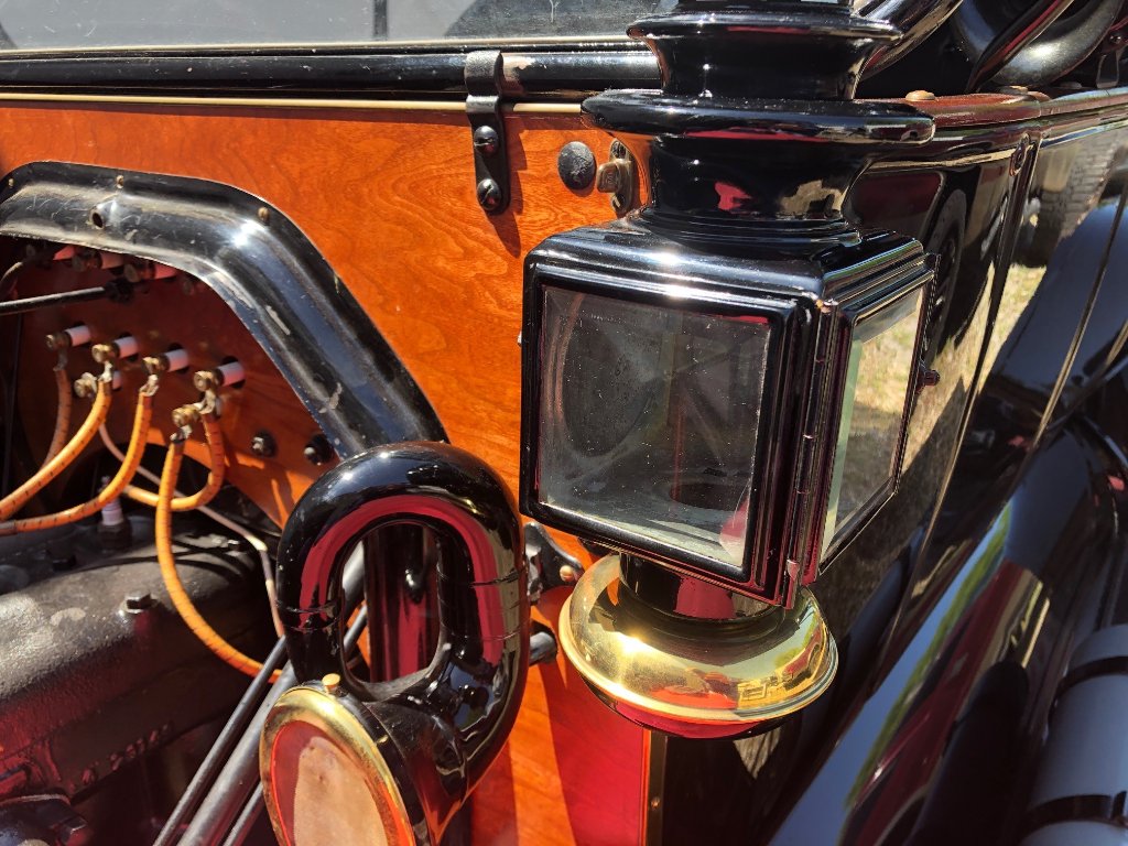

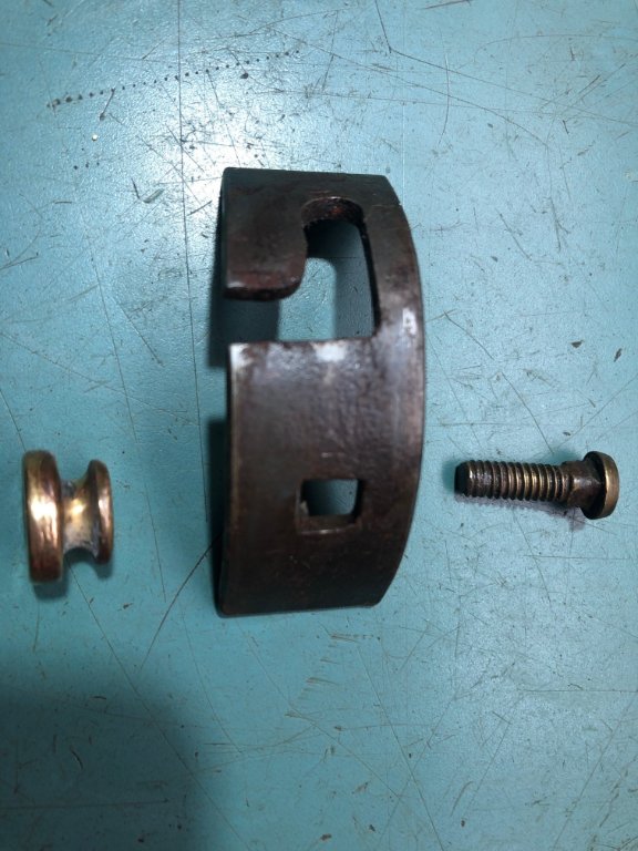

I have a '14 with front facing Kerosene lamps. As shown in the attached pictures there is a bracket inside that Locks the tank into place. One of mine is missing. Here are some things I am trying to learn.
1 Where might I find one, preferably with the bolt and nut?
2 Should it have a washer involved?
3 What is the name of that bracket?
4 Any tips if I have to make my own?
Thank you very much

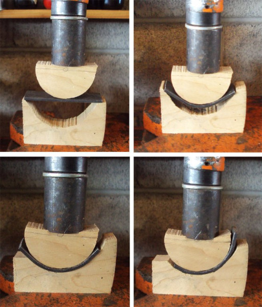

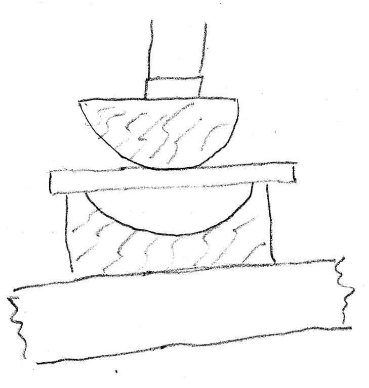

I think pressing a piece of steel into some hardwood or steel forms would work well. Maybe even a big C-clamp.
What make is it? I might give it a try if you don't get any offers.

That’s a Victor #2 lamp, isn’t it ? There’s plenty of lamp restorers out there that probably have available parts. Contact Bill Glass.

Yep, It can be done. I'll keep going in case you don't find a real one. It fits my Victor. Others may be the same.
Re: Kerosene Lamp Hardware
Anyhow, that's how I would make one if I had some spare time on a Sunday afternoon.

Ben. Email me with your address and I’ll send you the part you need. No charge/just postage. Don. fordfool@verizon.net

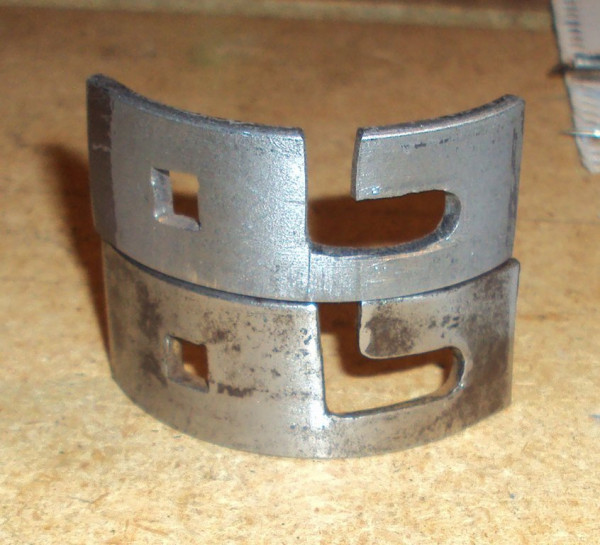

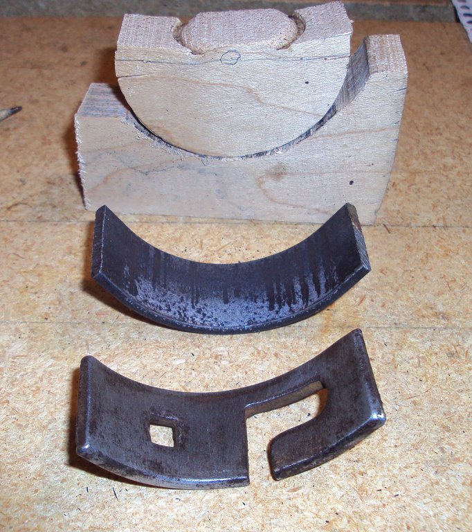

Pretty slick Rich. You make it look easy.
Thanks Dallas. It was an easy part to make. Having the right thickness on hand helped. The square hole is a touch bigger but I can make a bolt that fits it. I'll add it to my Victor collection should I ever need it. It's another sample of what we can make.

Rich E, I love seeing your posts about how you make parts!
For the life of me, I cannot remember what car it was for? Might have been the 1914 pickup I had years ago, and had to sell before I finished it (I sometimes try to forget about that one). But I had made one of those pieces in much the way you did.
I really like the way you pressed that steel piece. I was brutal when I did mine. Found a scrap of strap iron the right thickness, slit it down the side to the proper width. Then hammered it rounded over a scrap of pipe to match the one from a matching lamp. I carefully copied and marked the holes and slots, then drilled a series of small holes, leaving a bit of room to file to fit. It didn't take as long to clean it up with good small files as I thought it would. Maybe about twenty minutes? The entire process took maybe a bit over an hour. I could have spent that much time searching small boxes at a swap meet (if there was a swap meet to go to?), and not found one.

It is fun Wayne. I hadn't made much lately and a few glitches popped up. First I cut the width 1" and had to re-saw it to 7/8". Then I used the original to locate the notch and marked it backwards. I'm glad I checked it before sawing. There are dozens of ways to go wrong especially when I'm out of practice.

Thanks to all, Don is sending one but the discussion and illustration was quite educational.
