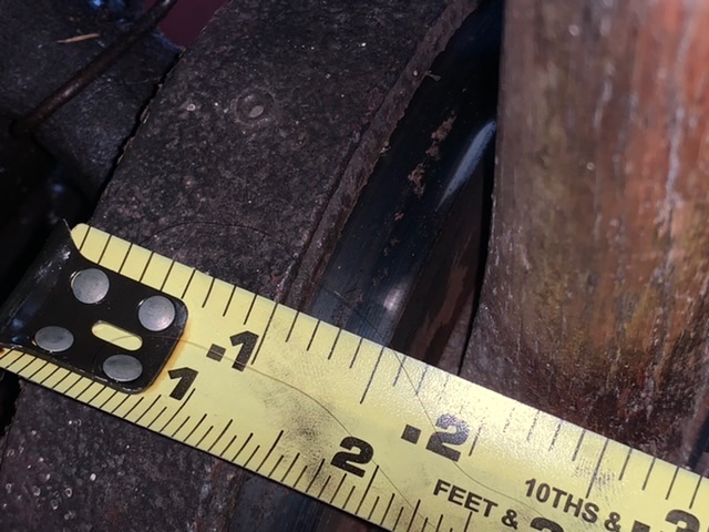

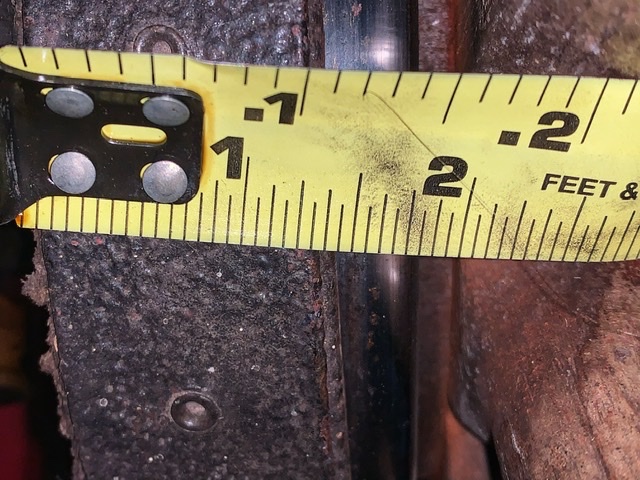

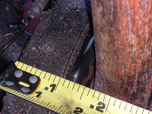

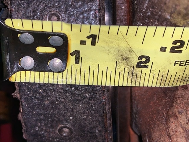

Not the best pics but the lateral movement best demonstrated as the amount of visible rear drum exposed between the rear brake lining and the wheel/hub spokes.
Darin

Sheared pinion key
you very likely had the excessive passenger side movement before this and that is another issue entirely. A broken babbit washer will result in the ENTIRE differential assembly moving and the passenger and driver side wheel cannot help but move in this case. This is not the case. Lose the passenger side babbit and pinion/ring gear mesh hard and growl. Lose the driver's (left) side babbit washer and ring gear moves away from pinion with grinding, skipping/gnashing/drama. No grinding, no skipping, no noise, no drama...just "bang" and everything is gone. That's a pinion issue, and it's a relatively easy fix. Relatively.
I am not suggesting, relating, or opining about anything else; what to do, when to do it, why to do it... I am just stating what the very strong likelihood of your specific on the road failure is.

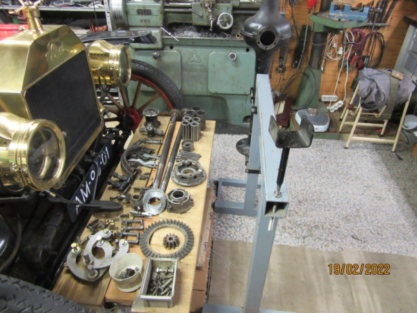

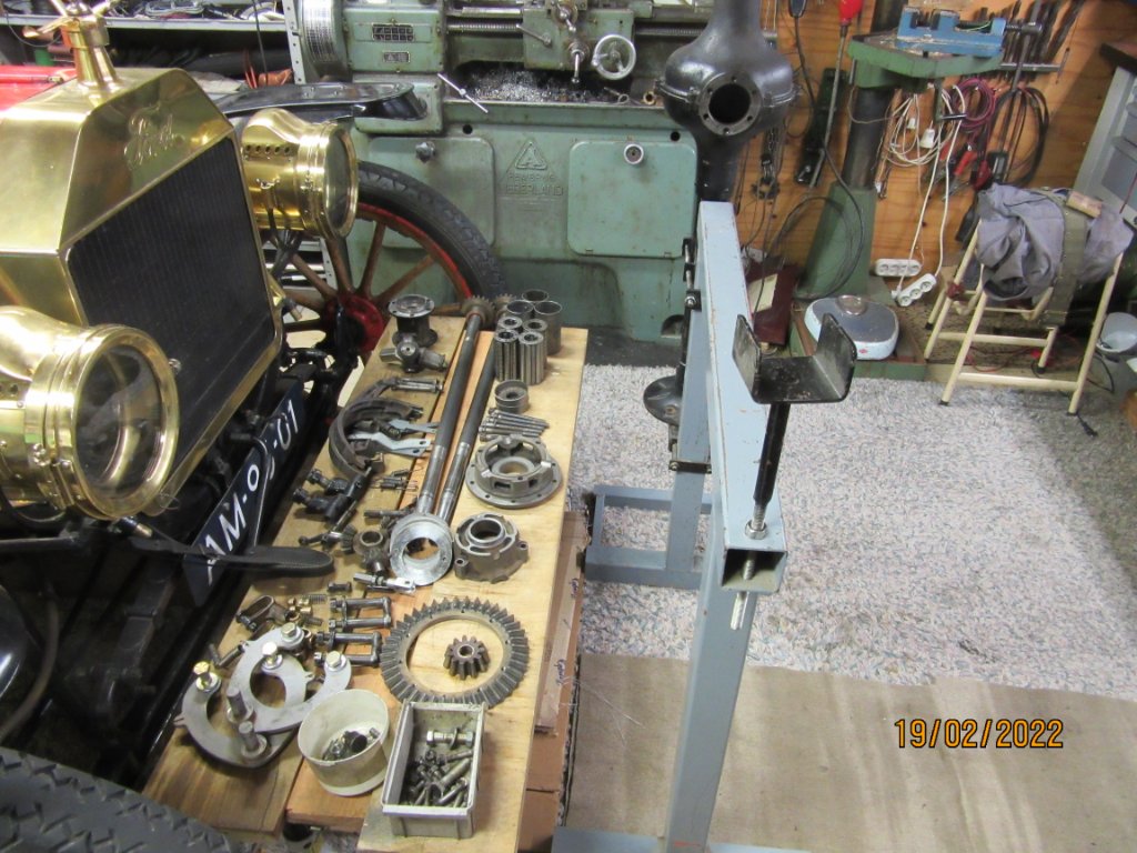

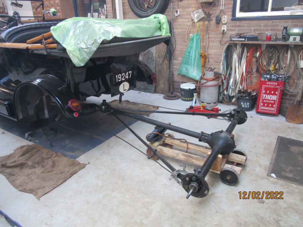

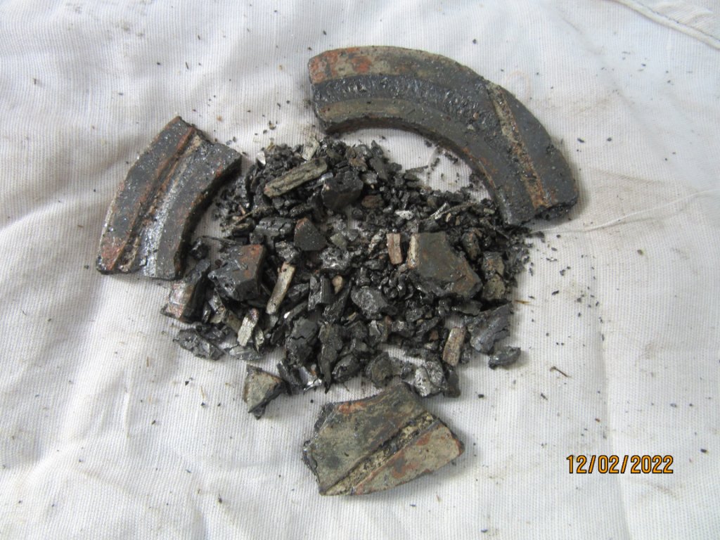

Darin H.
I had the same problem with a good Friends Car last month .
See pictures . Toon
See pictures . Toon

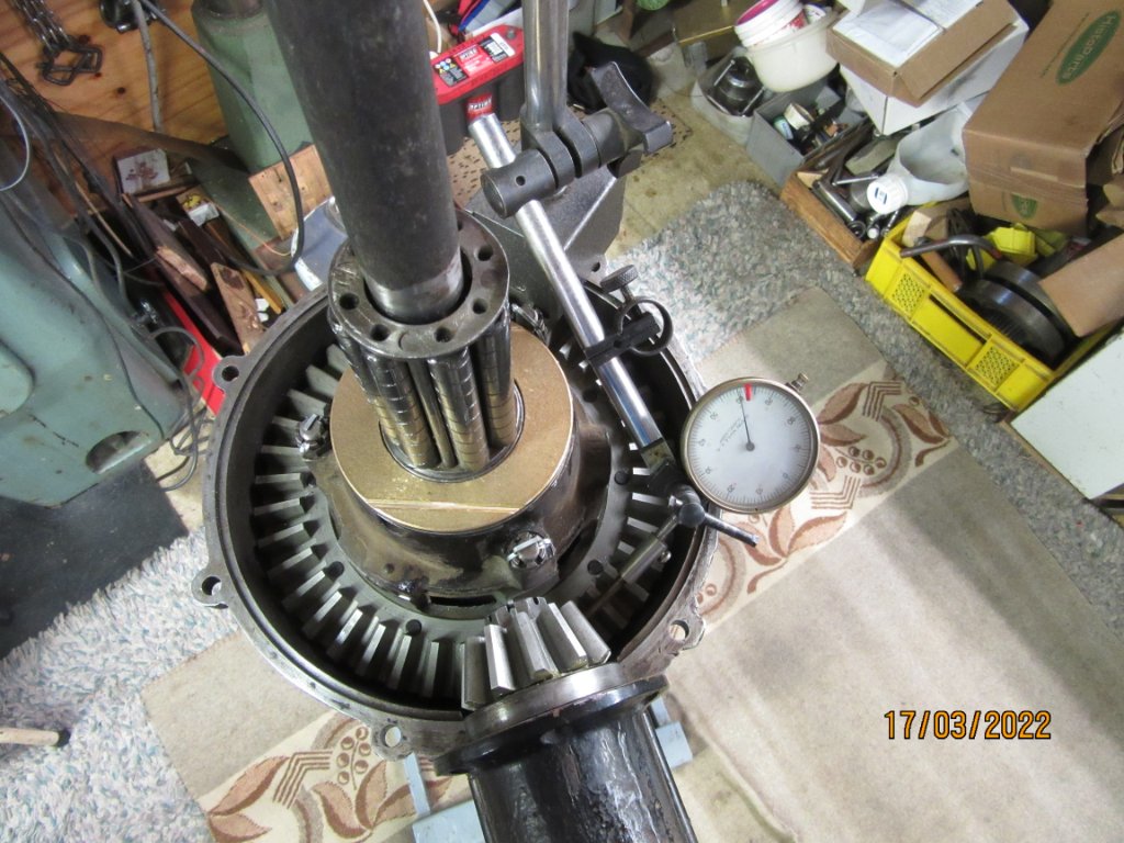

ABoer
- Posts: 235
- Joined: Mon Jan 07, 2019 2:41 pm
- First Name: Anthonie
- Last Name: Boer
- * REQUIRED* Type and Year of Model Ts owned: 1912 touring 1923 roadster 1925 pickup
- Location: Klaaswaal NL

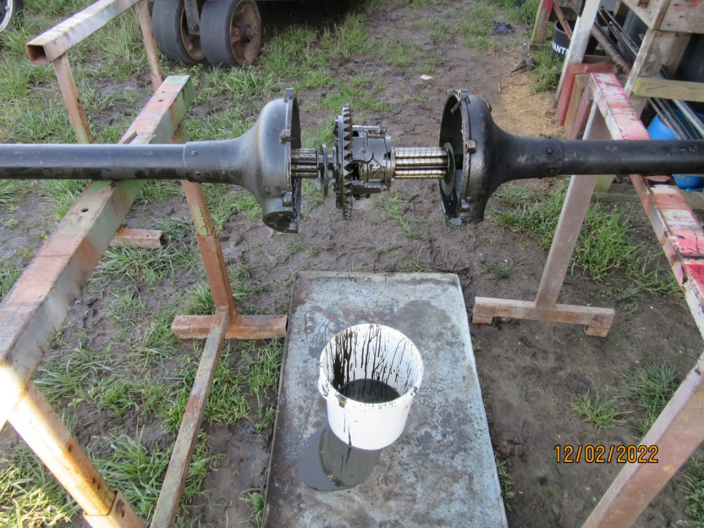

Re: 13T Drivetrain Problem - Babbitt Thrust Washers?
For the next Hunderd year !!!
Toon

The right side in & out movement is quite telling. The differential with the ring gear attached cant move out that much. That would be an over mesh of the gears. Cant happen unless the DS bearing is gone, in which case, there would have been a ratcheting noise in the gears.
The right axle is stopped from inward travel from the center fiber washer .062" The axle is stopped from outward travel by the 2, 1/2 round keys about .090" thick. For the axle to move outward, those keys would have had to both fallen out & the axle to gear fit dead loose.
The last possibility is a broken axle right side.
I suspect, by trying a little harder & rotating the wheel, it could be pulled out further than the 1/4" currently. At that time note any degree or lack of friction in any internal parts when pushed in & pulled out. The only thing to prevent the wheel/axle from coming completely out is the point where the axle diameter increases from its bearing size of 1.062 to the raw shaft size of around 1 1/8" & encounters the bearing or internal seal.
The axle assembly does need to come out for a complete rebuild.
