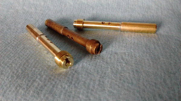

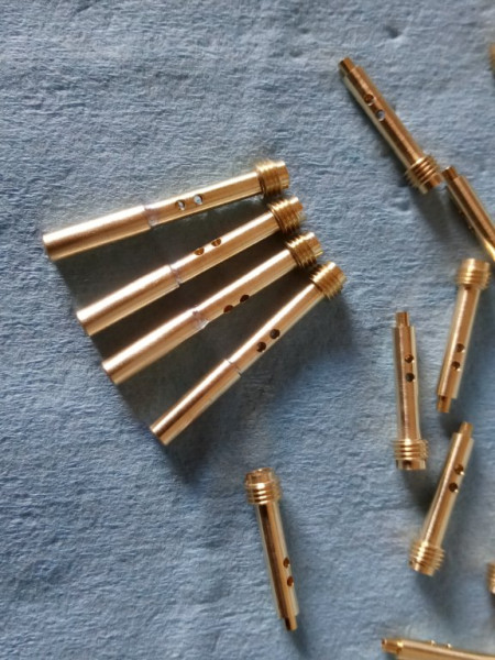

Post by Scott_Conger » Thu Mar 31, 2022 5:57 pm
these
will soon become these - Idle Jets:

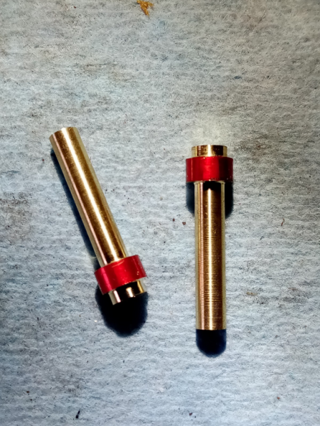

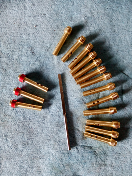

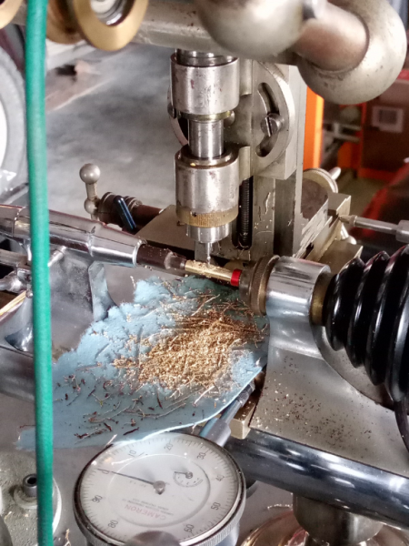

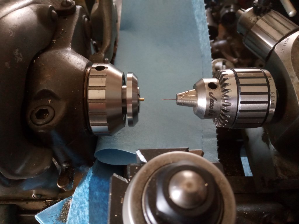

Idle jet orifices: barely larger than a grain of rice:
very fine drilling required...next time will have a proper precision hand feed chuck...in this case the drill survived being in the manual turret. Drill diameter used was the very minimum the chuck would take:
first part of assembly (no deburing or cleaning yet). Jet visible in lower hole:

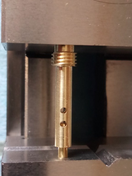

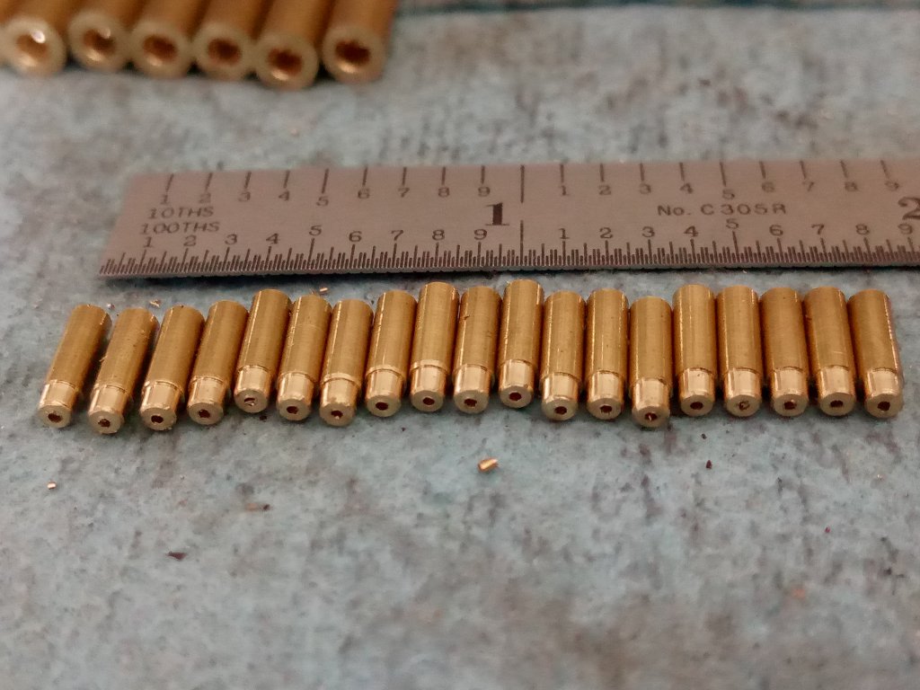

Post by Scott_Conger » Tue Apr 19, 2022 4:45 pm
Final Assemblies coming off the fixture:
