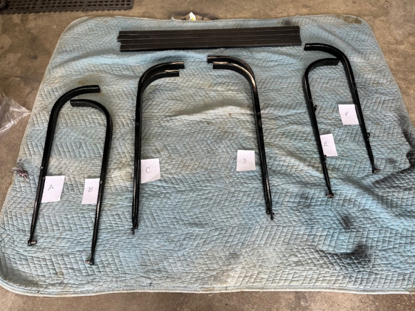

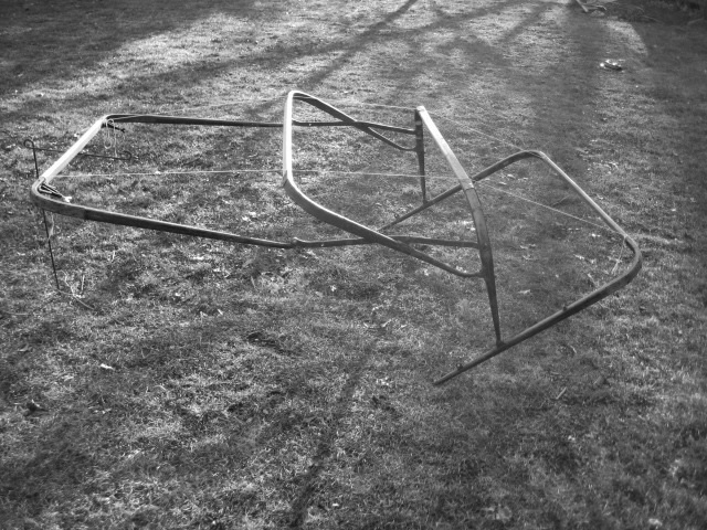

I have a problem with my top irons. I bought a new reproduction set of 1 man irons for 1922 Touring however I cant get them to fit on my car. I dont know if I have 2 man top irons or if Im missing parts. Ive attached a pic of all my irons and the wood bows as well as a pic I found on the internet of a Touring set and they have some support or extension bars that I dont have. Any help would be appreciated. John I must add the photo I found on here was originally posted by John Carter of South Jersey.

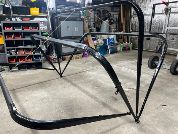

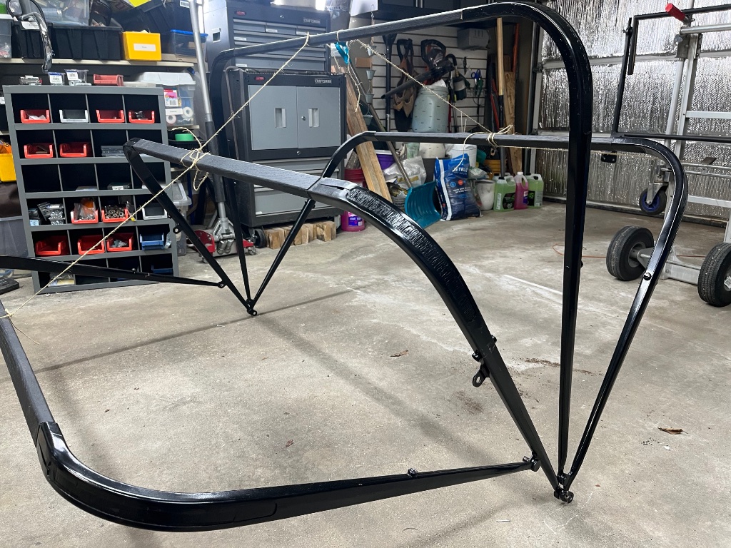

Update After some research and then reworking my bows I think i have the correct configuration and all im missing is the support arms for each side. Does anyone have drawings and dimensions and where the hardware attaches etc. Ill also have to find some now so let me know if anyone has a pair.
