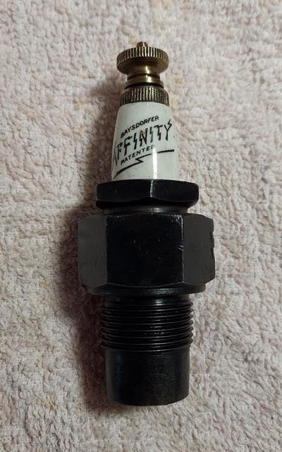

I could go on - but some photos of your collection and handiwork would be great to see.
Here is a photo of a recent discovery that I just cleaned for display.

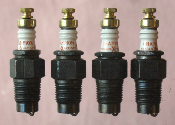

I used gun bluing on these. I think it looks pretty decent.
