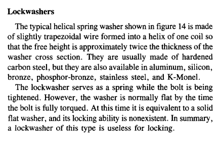

Here's what NASA says, (see page 9)...
https://ntrs.nasa.gov/api/citations/199 ... 009424.pdf

Split, waffle or spring lock washers are intended to put tension between the surface and nut when the bolt is fully torqued.
"Bolt Science" did comparison test between a flat washer and spring washer to prove that split washers don't work. Take a look at the two video's and see if you can tell why the comparison test is invalid and what it actually did prove. https://www.boltscience.com/pages/helic ... ashers.htm

From Minuteman guidance systems; Shuttle nose wheel steering, Shuttle Hand Controllers; ISSA JEM Robotic Arm Controllers; B-52 ESG gyros; M119A Howitzer Navigation and Aiming Computers...in 33 years of assembling and then overseeing production and finally designing devices, not once on those 33 years did I ever touch a split washer. There are lots of ways to lock things used in NASA, Air Force, and Army applications , but in my experience, split washers were not among them. The caveat to that, is this: there are in fact MIL-SPEC split washers, and the military does use them...with respect to the parts I put on the M119A Howitzer, my parts were originally designed to more stringent space applications.
The NASA paper declaring that split washers do not lock is a declaration of a fact which lacks complete context. It is a true fact within the world that NASA exists. The fasteners used are of a completely different quality and hardness...the cost of which would ruin you financially if you were to assemble an automobile with them. As such, split washers are simply springs which will skate along the bolt or nut's face and in that context and tested through environmental testing through SINE Sweep and G shock testing, they will not hold fasteners like you typically expect. The Design Paper is absolutely correct. It is remarkable what can happen to an assembly if subjected to high enough G forces at it's natural frequency, either SINE or Random vibration.
That's not the world that laymen live and work in, though.
Compare the NASA environment (special fasteners, etc) to say, a brass carburetor with a part held on with a mild steel screw. The split washer will dig, resist, and practically unwind while fighting you and your best screwdriver tooth and tong. It will lock as intended or expected.
While the man that walked on the moon got there on a craft built by the lowest bidder, the lowest bidder met or exceeded every specification set forth by both the design, and the contractual requirement. Not only that, but every assembly was tested to to near destruction (and sometimes beyond), analysed, and the design and specifications modified and adapted as necessary, such that the device would survive many times it's expected environment.
The lowest bidder shipping a poorly designed or assembled device to NASA or the military mostly happens in the movies and typically has Charleton Heston saving the day.
As for how many times you can re-use a split washer, I personally think you can re-use them every place where it wouldn't matter if they fell out.

Looks like I stand corrected again. "Lock washers never worked in the first place" so through them away.
Craig.
